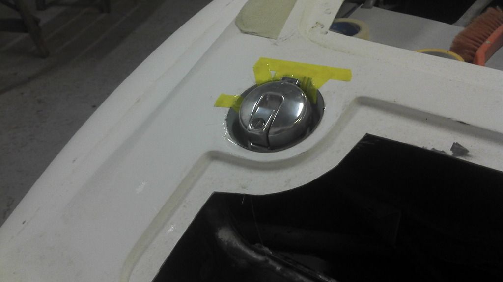

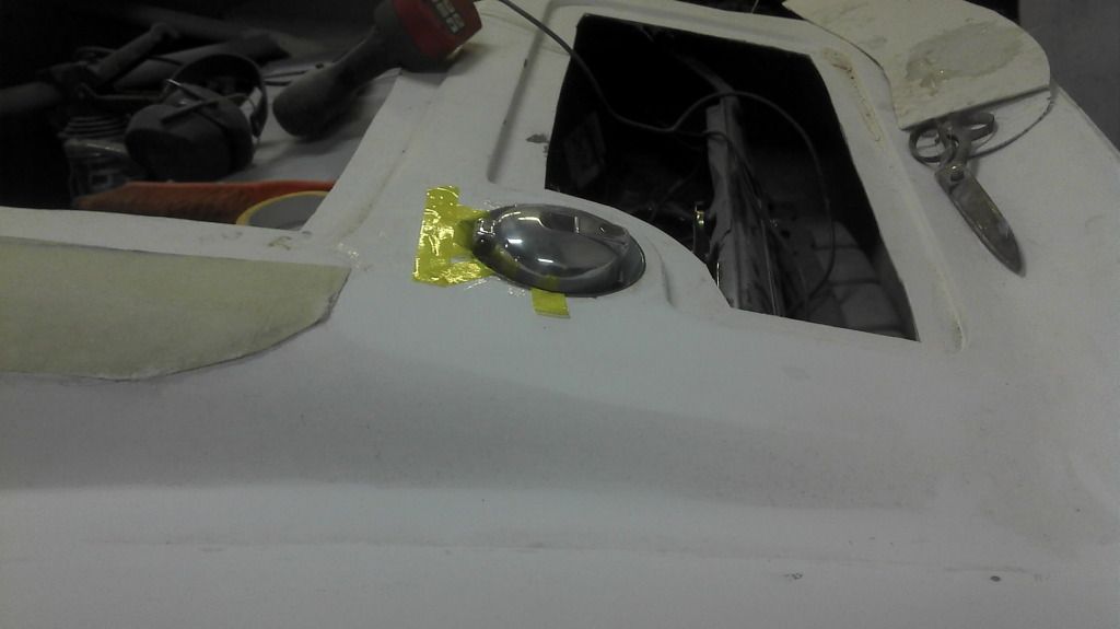

Fuelcap
That's a very nice fuel cap you have ! And a very good idea to sit it down as per the car it came off. Do you need the big rubber boot it sits in ?
Hi Peep s, yup nice cap, with a key, 20 squids. I am not sure if I will need the rubber gaskeprobably make another, as my drain is now central, not on the side.

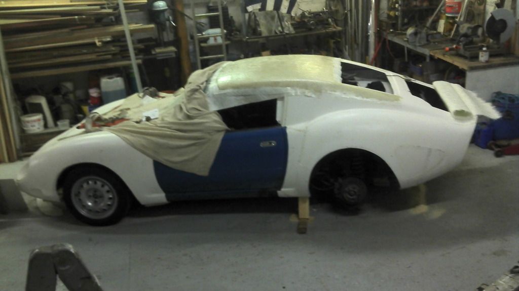

Heres this eves result. Inspired by the 275, and imho a need to break up the rear quarter view. For a couple of hrs marking, snipping and pugging I am pleased. Still needs a bit of fettling.
[IMG]http://i250.photobucket.com/albums/g...-17-18_268.jpg[/IMG] [IMG]http://i250.photobucket.com/albums/g...-17-46_564.jpg[/IMG] [IMG]http://i250.photobucket.com/albums/g...-18-29_961.jpg[/IMG] :pop2: |
Top, dallah! Love the look.

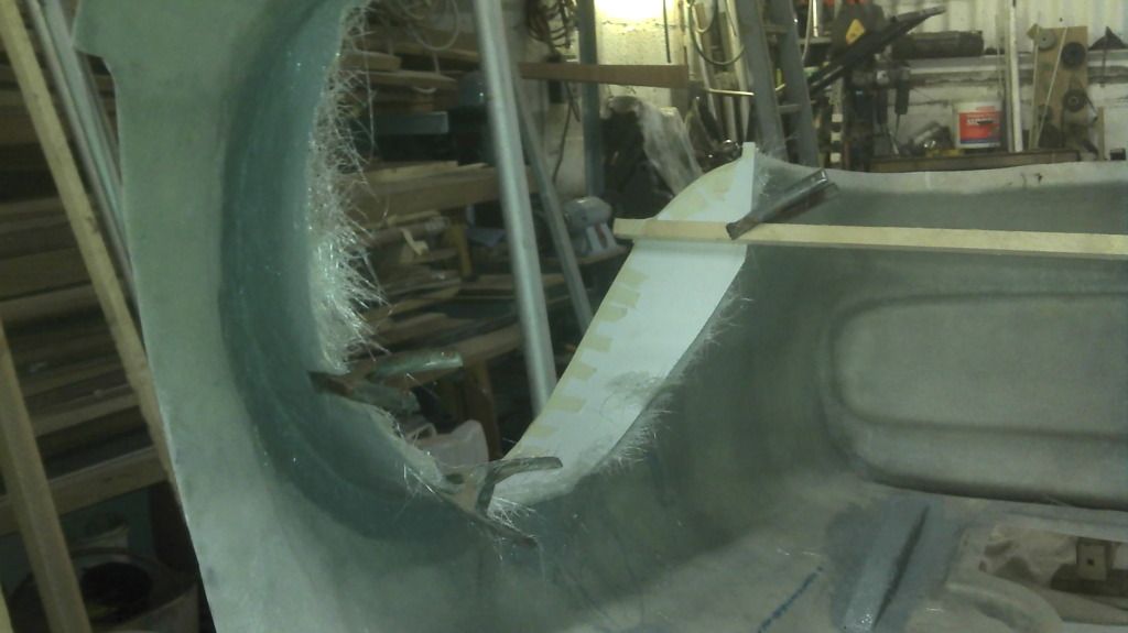

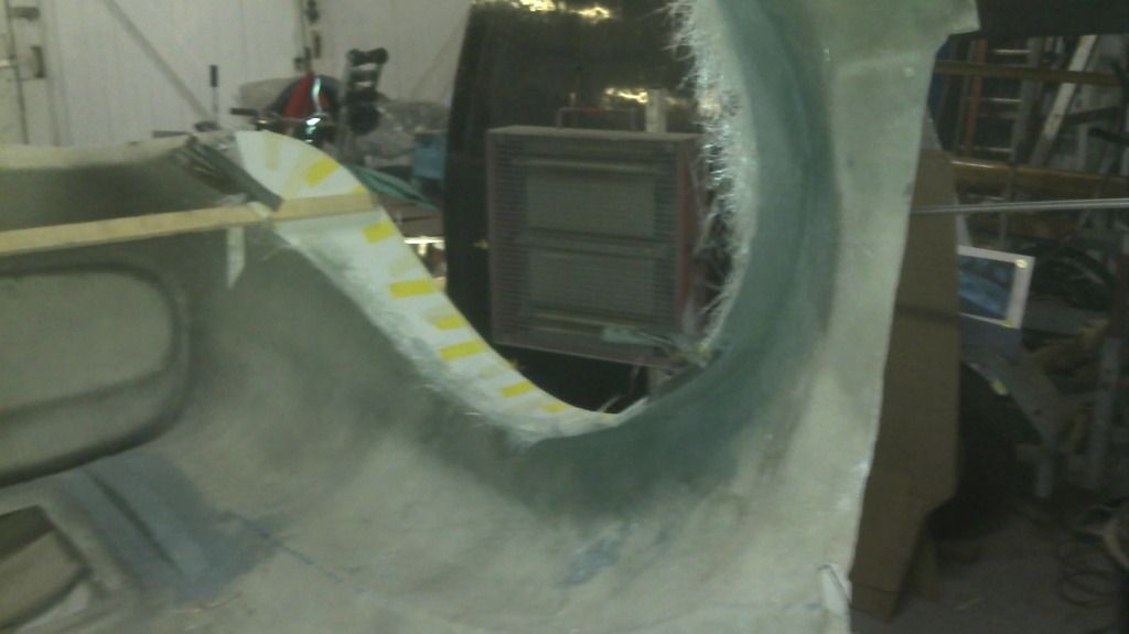

By GRP sheet do you mean mat or pre- made stuff? The pre made stuff I either snipped bits off the window surrounds to make the small triangles that hold the vents in position, or I just made a bit on some flat plastic stuff. For good GRP work use a consolodating roller for a better finish and avoiding a resin rich material. Either a paddle wheel or washer type roller. If you want Chopped Strand Mat, there must be somewhere local to you. Just Google Fibreglass supplies. 2oz is a nice weight. |
Grp

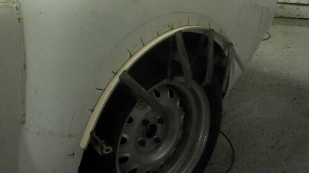

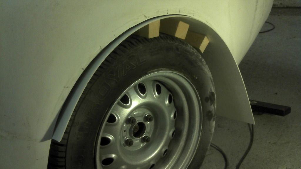

I was referring to those nice pieces of 150mm wide gel coated strips you made your arches with ? :icon_lol:
ah no, those are just bits of white plastic people use for 'For Sale' signs etc. The are just a temporary former. Gel goes on top, when its dried lay up the GRP. When its gone off they are removed to leave a smooth section of GRP.
Any thing thin and bendy can be used, eg perspex, Formica, even thin ply, but you have to cover that with brown parcel tape to stop the gel sticking to it. |
