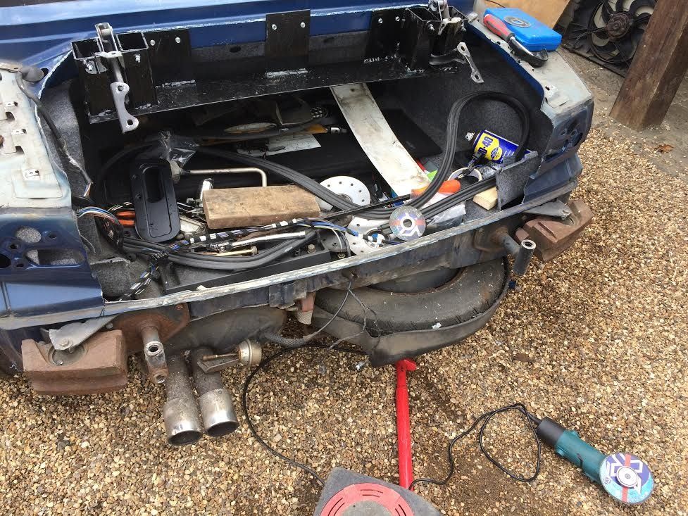

Boot floor
Spent about 3 hours on it today, doesn't look like much progress but a major modification made.

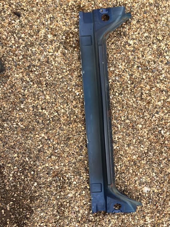

First was to modify the alloy crash bar at the rear. I worked out that if I turned it upside down I could probably get a flat boot floor. I got to use my favourite tools, a small hammer and a little heathttp://i803.photobucket.com/albums/y...unnamed-15.jpg Unfortunately it proved harder to bend than I thought so I cut a bit out. I needed to remove a section so that it would clear the spare wheel which I am keeping.http://i803.photobucket.com/albums/y...unnamed-16.jpg Needed to trim the towing eye to fit the crash bar back on. (just above the exhaust)http://i803.photobucket.com/albums/y...unnamed-17.jpg this leaves plenty of room for the spare wheel. I then trimmed the rear panel, the fold is just about level with the crash bar, I managed to take it out in 1 piece with an angle grinder using a 1mm cutting disc. http://i803.photobucket.com/albums/y...unnamed-19.jpghttp://i803.photobucket.com/albums/y...named-18_1.jpg. Then choped the original boot panel into 3, mounted the main piece directly to the crash bar and the 2 side pieces to the rear boot section with self tappers. http://i803.photobucket.com/albums/y...unnamed-24.jpg Covered the gaps with duct tape and laid some GRP on top.http://i803.photobucket.com/albums/y...unnamed-25.jpg Still a couple of layers to put on. Not worried about the appearance, want it fixed on nice and strong. The boot floor is going to be carpeted so will hide any "bodgering". It would be nice to have a trap door in either side to access the rear lights but little sidetracks like this take time and I don't want to get side tracked. |
I ended up in A&E , I'm alright now but I always use it with the guard and eye protection and gloves !! |
I do try and use the guard but I was using over size cut of discs from my chop saw
