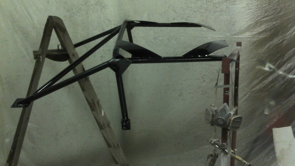

Quick go this afternoon. Sanded up the roll cage and sprayed two coats satin black. Also splashed a bit around the inside of the vents.
when it was time to go my 'instant spray booth had covered up the lightswitches so it was a fairly chaotic exit![IMG]http://i250.photobucket.com/albums/g...et_166055_.jpg[/IMG] [IMG]http://i250.photobucket.com/albums/g...et_166056_.jpg[/IMG] |
Did you spray the dog too????
As long as it wasn't overspray...
He was al' white before I started:drum: ...
Fumes getting to you?

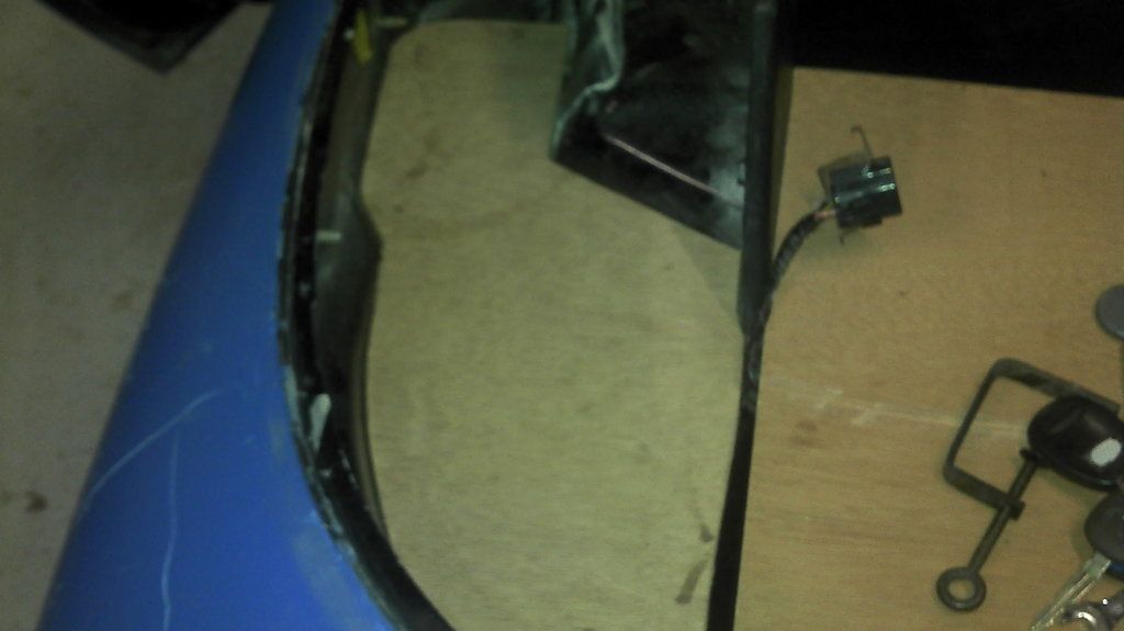

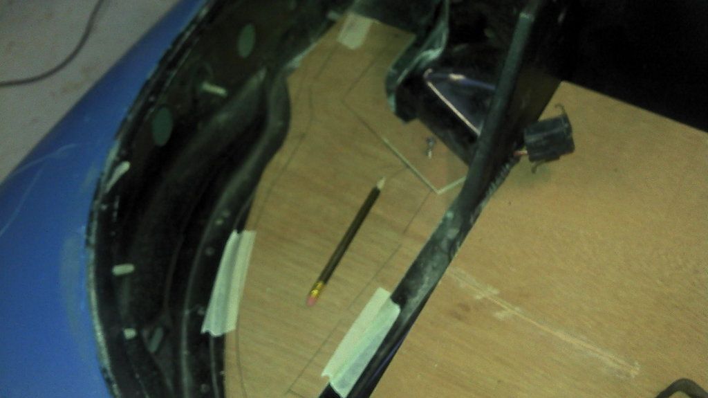

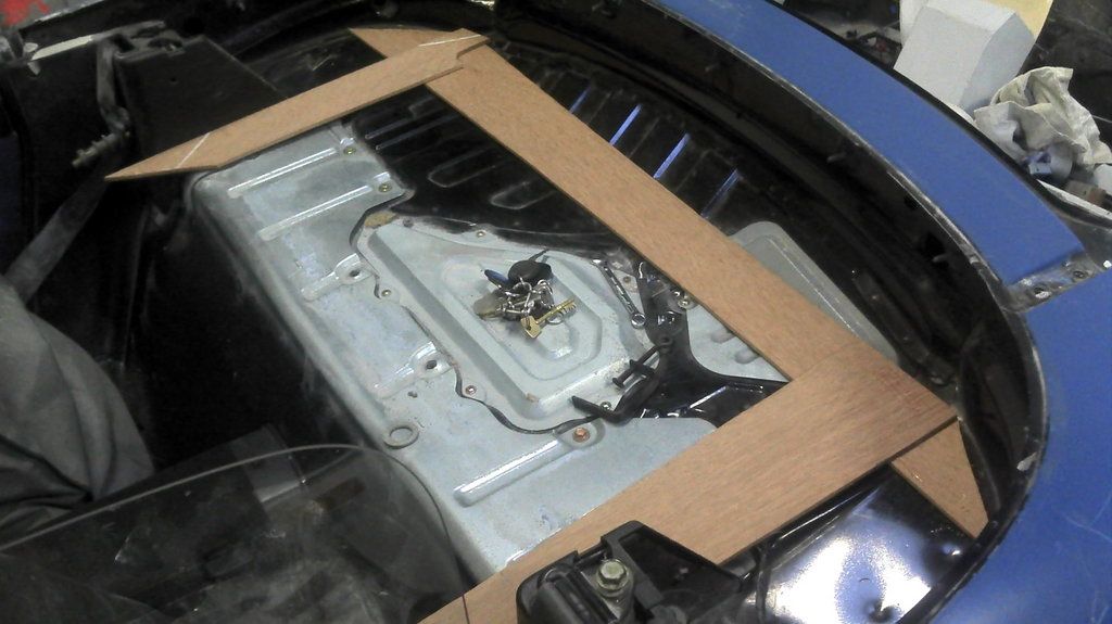

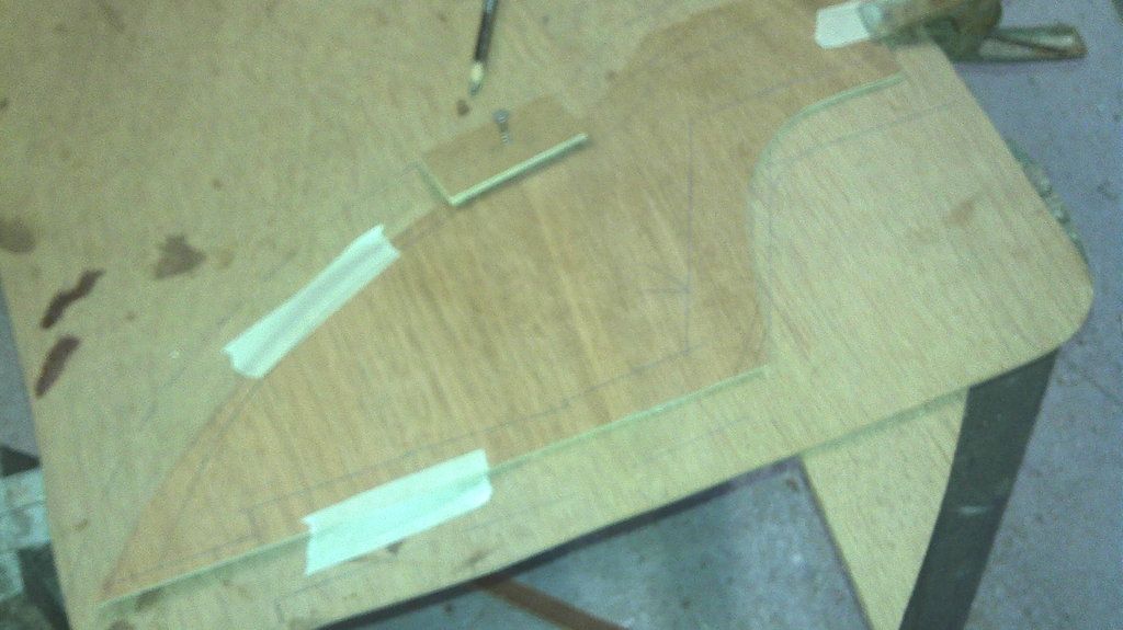

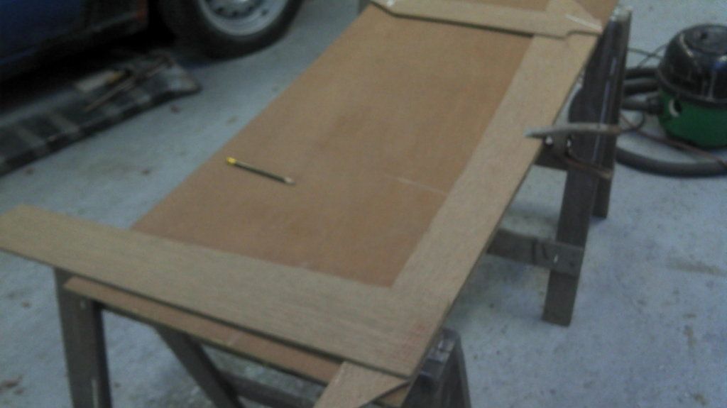

Fitted some 6mm ply to the rear. made a patten like this......uding a hot melt glue gun to hold the pattern together...[IMG]http://i250.photobucket.com/albums/g...et_167825_.jpg[/IMG]..... Transferd it like this..... [IMG]http://i250.photobucket.com/albums/g...et_167826_.jpg[/IMG] The ends were done buy rough cutting a bit of ply then using the boatbuilder method to take a patten. A small piece of wood, parraelle sided, is used as a 'dummy stick' to transfer a mark on to the ply (spile board). Then to transfer the marks fix the ply Patten to the finished ply and using the dummy stick again reverse the process. This method is used for everything from planks to locker bottoms, and can be mm accurate. [IMG]http://i250.photobucket.com/albums/g...et_167827_.jpg[/IMG][IMG]http://i250.photobucket.com/albums/g...et_167828_.jpg[/IMG] [IMG]http://i250.photobucket.com/albums/g...et_167829_.jpg[/IMG] in this case it nearly worked! |

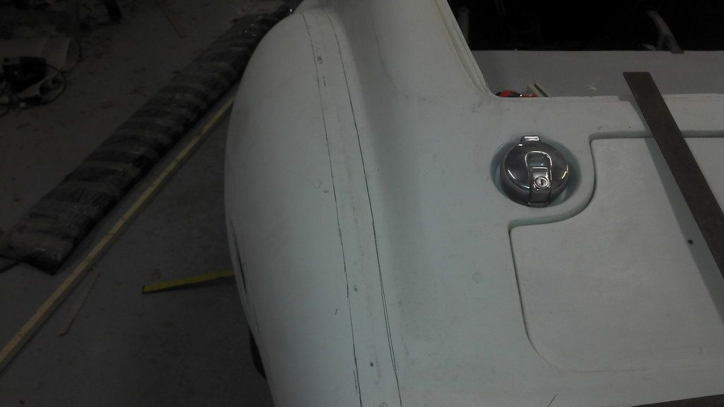

Back on form now thanks Froggy, crash diet. Spot the difference....[IMG]http://i250.photobucket.com/albums/g...et_167836_.jpg[/IMG]
+ 1" each side?
http://i1046.photobucket.com/albums/.../widesupra.jpg Rims bigger than you thought Nick? Looks fabulous whatever the reason :love: Driving it soon! :flame: |
No, try again.....(your on the right lines)

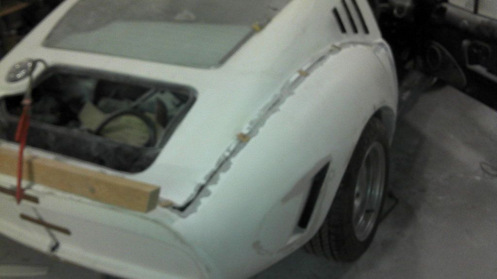

Edit...... No, minus 2" each side. Now I dont need wheel spacers! [IMG]http://i250.photobucket.com/albums/g...et_167832_.jpg[/IMG] Shrinking the second side. It was a ''deep breath and cut" moment! [IMG]http://i250.photobucket.com/albums/g...et_167834_.jpg[/IMG] |

Glad you like the narrow version. I reckon I could have taken out 3" per side and it would still look good. [IMG]http://i250.photobucket.com/albums/g...et_167830_.jpg[/IMG] On advantage is it makes the mid section between the wheels (panal after door) 2" longer too. [IMG]http://i250.photobucket.com/albums/g...et_167831_.jpg[/IMG] |
Matting on the outside? Fill it over?
Cut, taper outside edge one inch each side of the join to a feather edge. Support, then 3 layers csm. Remove body, clean up inside and glass two layers. Replace body, grind off excess glass to just kiss the original gell then either add more glass or gell coat over. Fill and fair ad infinitum.
Works for boats! |
