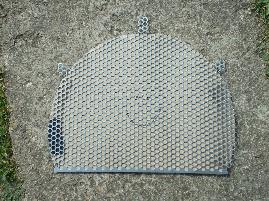

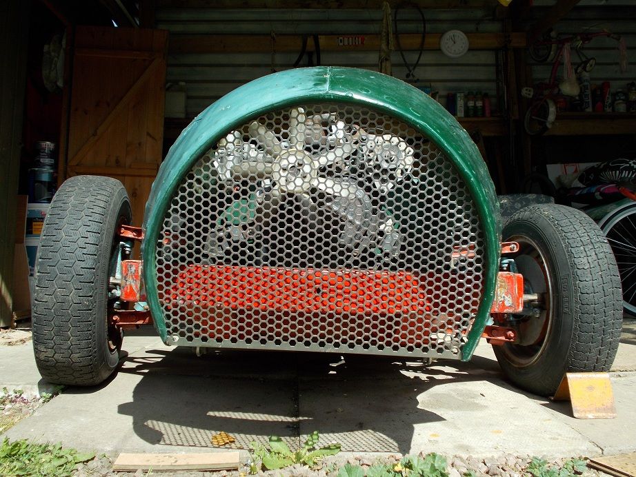

Today I had other tasks to complete, so there was only a small time window for the Monaco. I decided to cut the grille out of the 50cm square sheet of mesh I bought what seems an age ago!
Using the trusted cardboard assisted design method I fashioned a template which only needed a couple of small adjustments before it sat perfectly in the nose. I lay the mesh over it and marked the snip line with a black felt tip pen, including three flanges which may assist fixing. http://i1160.photobucket.com/albums/...pszvahgah6.jpg http://i1160.photobucket.com/albums/...psnh5yy4ve.jpg Ten minutes with my Machine Mart aircraft quality left hand curve tin snips had the job done. It sat in place under its own weight exactly. It's now hanging in the corner of the shed awaiting the distant day it'll be sprayed black and fitted. http://i1160.photobucket.com/albums/...psvvtmxqeu.jpg Regards, Mick |

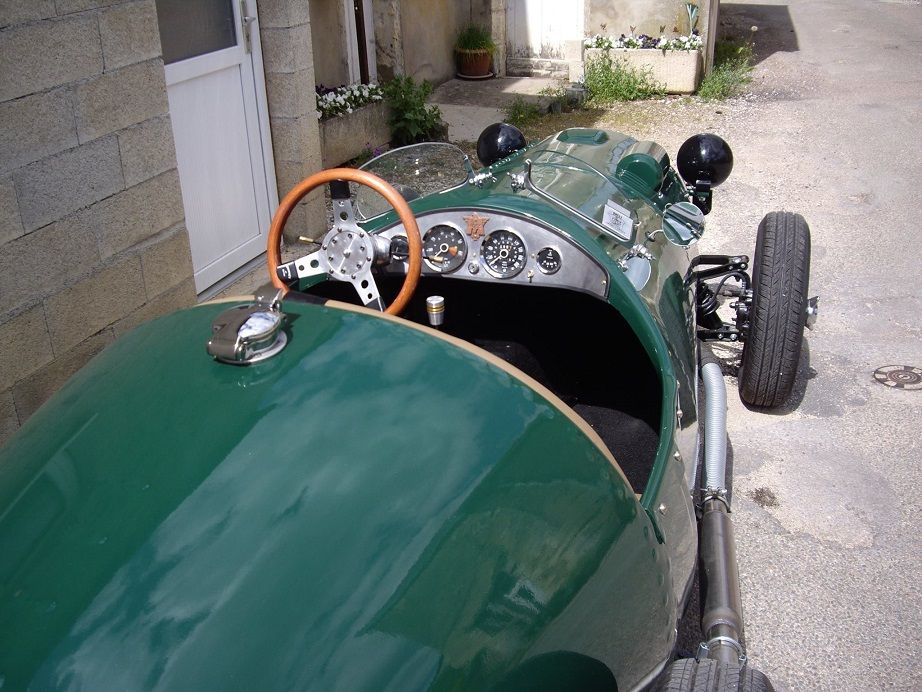

The other day I received a Facebook message from a fellow member of the Moss group to tell me her husband has built her a Monaco. I sent her a link to this thread and this morning she sent me a picture of her 'Premiers tours de roue ce matin...'.
Trés cool! http://i1160.photobucket.com/albums/...pslpj03fij.jpg Regards, Mick |
looks like a nicely finished example ...

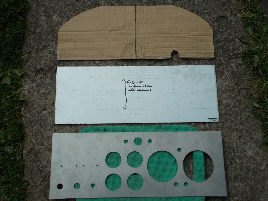

I decided to address the problem of the top steering column mounting which I knew would impact on the position of the dash. My first job was to suspend the column from a roof beam of the cave with paracord, having manoeuvred the car into a suitable position. I'd tried wedging it from below but this made sitting in too difficult. Once I was happy that it sat perfectly, I made a rough cardboard screen as the top edge of my ally dash will need to be trimmed to match it. This I cut down whilst sitting in to ensure a decent sight line for driving. http://i1160.photobucket.com/albums/...psxbilmcva.jpg I then made a cardboard dash blank and marked and cut out the area which mates with the column. After a bit of jiggling and snipping I was able to get it into a semblance of its final position. When the real thing is fitted the back of the dash, which I will set out a little, will be visible through the screen. Tidy wiring will be essential! http://i1160.photobucket.com/albums/...psomk5os2u.jpg The outer column has a handy welded on bracket at right angles, i.e. across the footwell, with two mounting holes. Pondering how to attach it, and discarding the idea of a full car width bar, I hit on the idea of a scuttle brace, as in the donor. By joining the bottom of the dash to the tunnel, and supporting the LH end of the column brace, which will run to the RH skin, it will provide the necessary rigidity. Scratching around in my metal pile I found an early 3mm thick dash blank which, when adapted, will be perfect. It will be a broad U section with ears each side of the very sturdy Monaco transmission tunnel (which has been manufactured strong enough to take both the handbrake and remote gear levers). I bend thinner ally and narrow strips myself but making a tidy 'in full view' job of this I baulked at. My welding friend has an hydraulic folder (he did the A352 tunnel for me) so I marked it out ready for taking to him when I collect the modified fuel tank. Once it's been formed I can cut the bottom to sit astride the tunnel and the top to underlap the dash slightly. That was it for the day Regards, Mick |

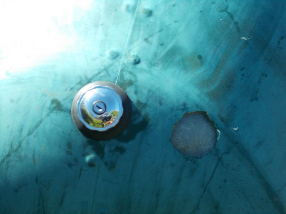

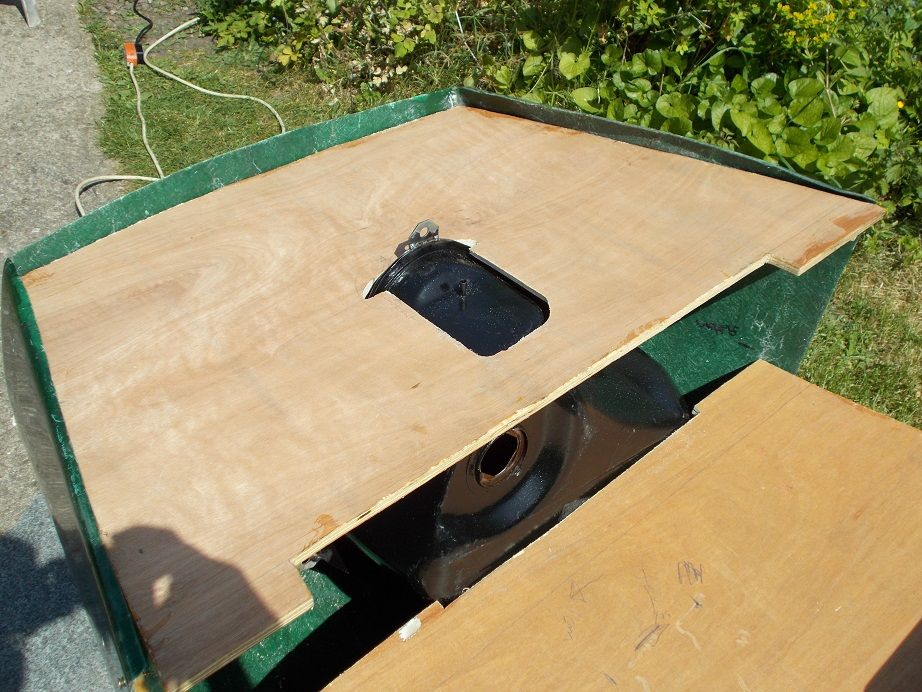

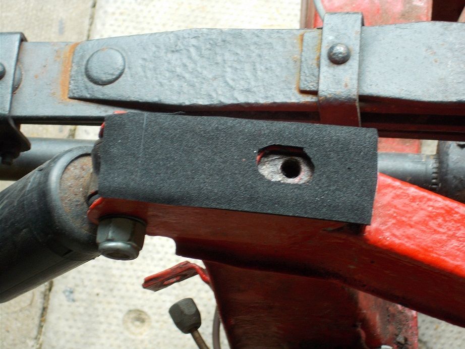

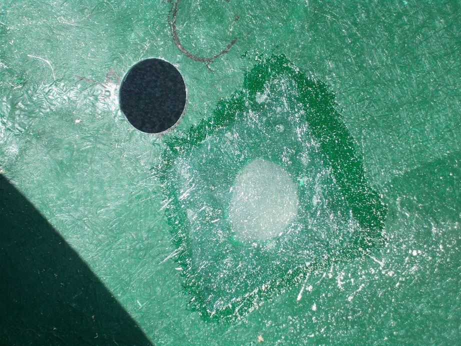

Yesterday provided an opportunity to offer up the tank, having first glassed over the wrong side of my first, very ugly, filler neck hole. After a bit of jiggling I discovered it didn't sit quite right, the reason being that one of the tank's many bulges had been sitting in that hole. Aargh! The solution will be dressing said bulge with a block of wood and a lump hammer. http://i1160.photobucket.com/albums/...psususoxnm.jpg The floor sat over it in a satisfactory manner with the lower of the two new lugs ready for its locating bracket. I know it looks to be very low and vulnerable but it's in fact masked by the diff. in situ. Today's task will be rivetting the floor's locating straps to the body, prior to fashioning and fitting the tank's upper locating brackets. I'd had to relieve the other floor section as well to get a snug fit. This part of the build has been a little tedious and time consuming but, once it's completed, the body will be ready for mounting onto the chassis, which will first need some handbrake and brake line related fettling. Happy Days! http://i1160.photobucket.com/albums/...psnh9bvv1q.jpg Regards, Mick |

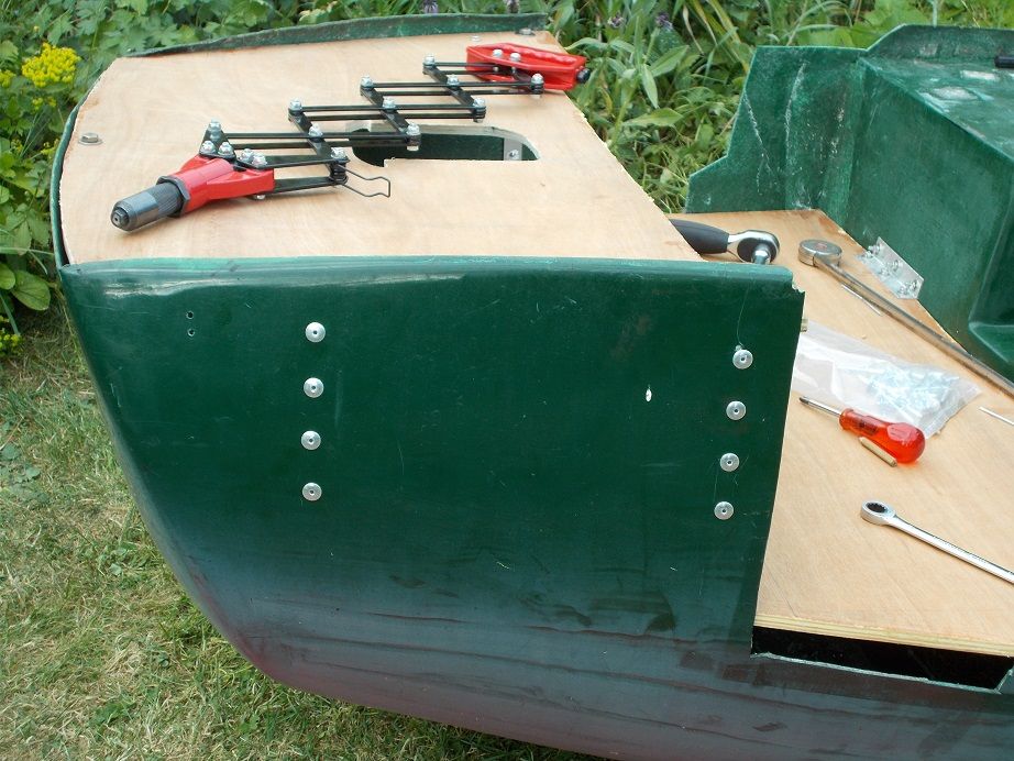

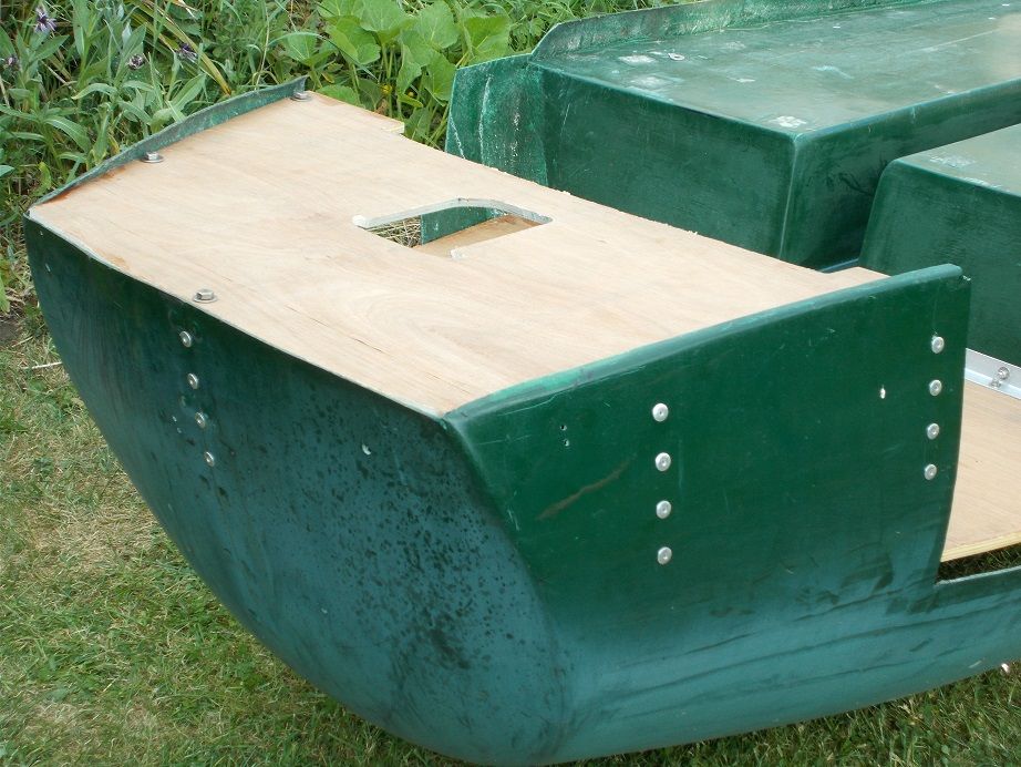

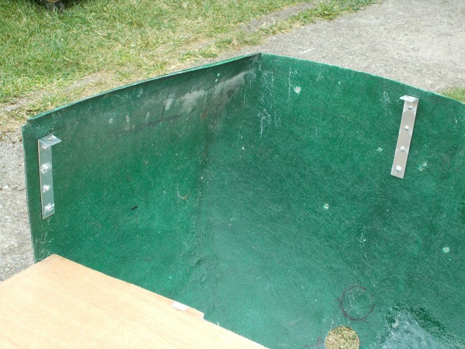

Yesterday, between showers, I finally managed to get my tank floor supports rivetted to the body sides. To make sure they were plane I fitted the rear one first, next the two front ones, drilled their M8 bolt holes in the floor and temporarily fitted same. I could then accurately mark the correct positions of the other two. After attaching them another temporary floor fitting gave me the last two M8 hole locations. It was very satisfying when all five bolts dropped through the floor into their respective brackets under gravity, my anally retentive approach vindicated!
http://i1160.photobucket.com/albums/...psmcatuhlx.jpg http://i1160.photobucket.com/albums/...pss42xvc7k.jpg http://i1160.photobucket.com/albums/...psizqitguc.jpg Looking afresh at that last picture shows just how pissed the body is, possibly partly from being shunted from pillar to post for three decades. I tell myself it's all part of its retro charm :rolleyes:. A bit of caulking is going to be needed along the edges, especially the rear one. I'm pleased with the look of the big head rivets, they passably match the moulded in 'Dreadnought' ones. I think more of them will be pressed into service when body fitting time comes around :). The lazy tongs rivet gun certainly made things easy, a sound investment. Regards, Mick |

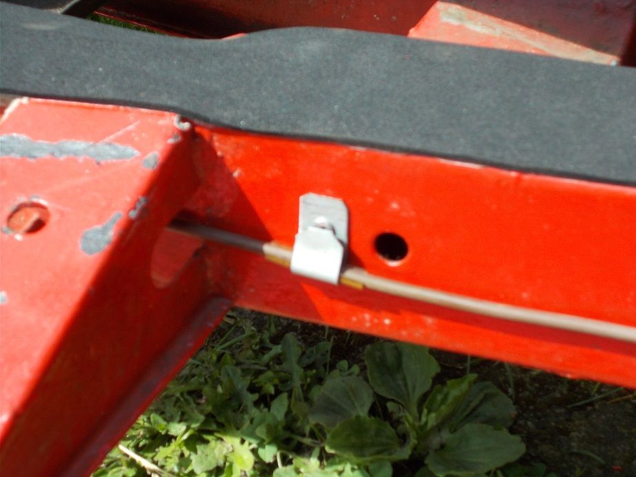

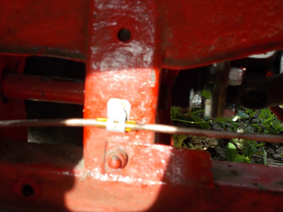

Anyway, the net result of my labours has been to arrive at the point where I could at last mount the body on the chassis, or so I thought :rolleyes:. On Friday I'd finally bolted the mini petrol tank in place, having had to wait a few days for the windscreen washer tube I've run from the breather stub down to the bottom to arrive. The tank's four bolt mounting and the tight fit of the filler neck have resulted in a satisfactorily rigid result :), although the filler isn't quite central, more retro charm. http://i1160.photobucket.com/albums/...psxzcmfhlk.jpg Yesterday I very carefully marked the side rails of the frame next to the factory seat belt and body mounting tappings, transferred them to the body underside, measured the offsets and drilled 13mm holes through the floor sandwich. More on this below. Today I surgically cleaned with acetone the mating top face, the limits of which I'd marked with a felt-tip, then cut and applied the self-adhesive foam strip which hopefully will prevent the two rigid surfaces from drumming. http://i1160.photobucket.com/albums/...pstkinj8nz.jpg I then turned my attention to the brake pipes which a previous owner had cunningly mounted so that they would chafe on the return flanges and outrigger holes they pass through. Genius! I carefully straightened and recurved them where needed and added a couple of home made P clips using split tube between them and the pipe. I'd come across a similar problem when I ally-skinned my pre-lit Westfield Seven. The master mechanic who'd built it had routed both the brake pipe and the handbrake Bowden cable over the top centre of the diff, the only place where they could be (and were!) crushed against a transverse spaceframe tube. Brilliant. Crap photo' alert! http://i1160.photobucket.com/albums/...psb3nc0xnj.jpg http://i1160.photobucket.com/albums/...psee1yddyy.jpg Recruiting my son the body was clapped on the chassis for the umpteenth time and checking underneath revealed perfect mating, apart from the tops of the rear suspension turrets where I'd forgotten to stick the foam. Aaaargh! That will wait for another day now. Probing my new floor holes confirmed that the above mentioned marking and drilling had been accurate. At least I'd got something right :). Regards, Mick |

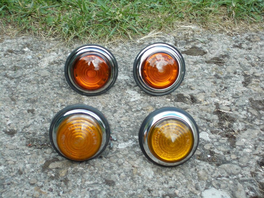

Here are the very reasonably priced indicators I picked up at the autojumble. I was drawn to the yellow ones by their unusual colour. They're mismatched but, as they'll be on the rear wings, I think it would take a particularly eagle eyed tester to notice this. The other two are new Lucas L488s which were about half price. Result!
http://i1160.photobucket.com/albums/...pspdyomylv.jpg Regards, Mick |

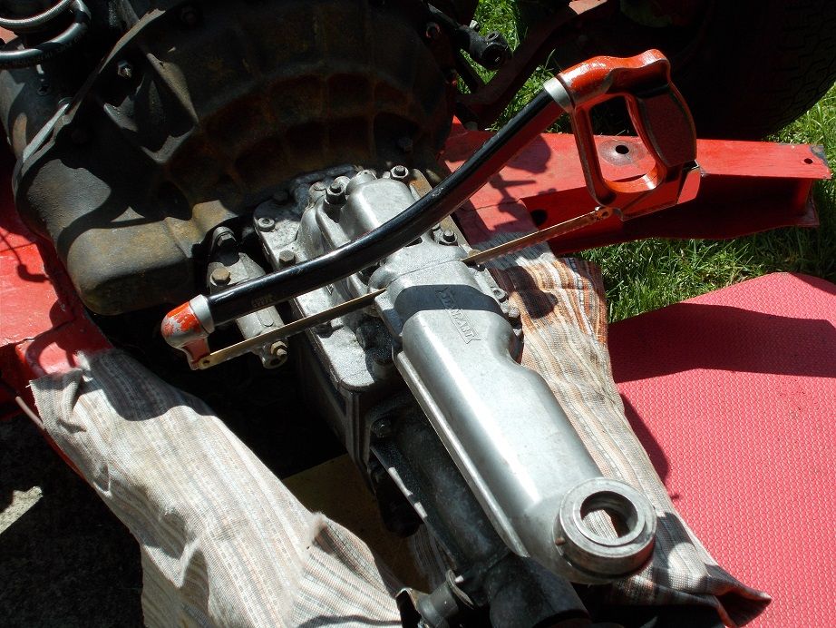

As the seating position in the Monaco is well aft of the Spitfire's, the gear lever needs to be similarly relocated. I'd done this on the A352 to get an authentic D Type forward angle and situation. I did this by butchering two extensions and joining them by bolting through a length of aluminium channel. The rod was extended with a length of welded on close fitting tube. This has worked well in service. http://i1160.photobucket.com/albums/...pshpdly0hn.jpg However, the build CD I got with the kit (scans of the 'manual', I don't think CDs were invented when it was manufactured) describes a simpler solution - chop the extension and bolt the driver's end through the GRP tunnel. Amongst the box of brackets I got is a fabricated extended rod but it's pretty crude so I'll extend the original again. http://i1160.photobucket.com/albums/...pszqxu3mvi.jpg http://i1160.photobucket.com/albums/...psnl4eulxc.jpg Next job was to fabricate brackets to firmly locate the body sides to the front outriggers. I couldn't use the existing tappings in them as the off side one has gone AWOL. I decided to make them from steel rather than aluminium sheet as decent strength and rigidity is needed. I plumped for M6 bolts through the top face of the outriggers and a combination of M5 bolts and big head rivets through the body, the outward curve of which means that neither of my rivet guns would fit to rivet the lower holes Cardboard assistance was again used to make templates for the brackets and the angle of bend required. Due to the asymmetry of the body one of the nearside fixing holes had to be tapped into the inner boxed in section of the near-side outrigger. http://i1160.photobucket.com/albums/...pscxeujstg.jpg I next applied the foam cushioning to the manufacturer's rear suspension bridge body mounting points and offered up the Monaco body. It now sits flush along its whole length and to my fabricated boot floor, and the mounting holes for my outrigger brackets look perfectly positioned. http://i1160.photobucket.com/albums/...pstgh3qrlp.jpg I then quit while I was ahead, a sound decision as it began to rain whilst I was packing everything away! Regards, Mick |
