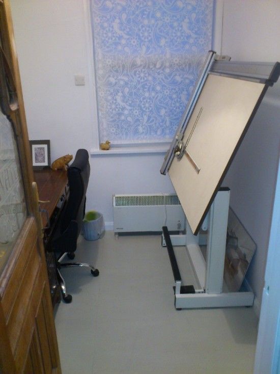

I am fortunate that my fiance is enthusiastic about my workshops. I had already put in a wood shop on the ground floor and a metal shop in the basement. Over Christmas we converted a derelict boxroom into my design office. It needed new ceiling, four walls and floor replacing and the door moving. (I only got it done as I had a call from relatives in Australia, at the beginning of Dec, that they were visiting in Jan and wanted the extra bedroom. Six weeks work got it done and the bedroom is now an office.) http://i5.photobucket.com/albums/y17...ps5316cf8e.jpg It is only 8'x9' floorspace but with 10' headroom! My fiance learned to plaster to help me get it all done in time. In return we are converting the adjacent 12'x13' guestroom onto her design studio and workshop. |
