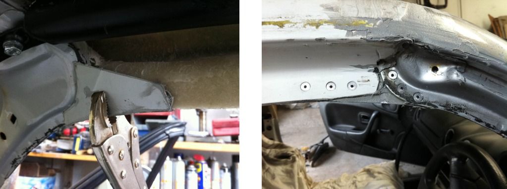

Refit the new rear body section, push the roof section into the adhesive and place some heavy weights on the roof to prevent movement. Cut some metal plates as shown (you can use a section from the old from wings) bond and riveted into the doorshut/windscreen head area. When rivetting the GRP panels always countersink to give as flush a finish to the surface as possible. Use any excess epoxy to fill any gaps between the new GRP and the steel bodywork.
![](http://i1046.photobucket.com/albums/b468/TributeAutomotive/roofplates.jpg~original)
