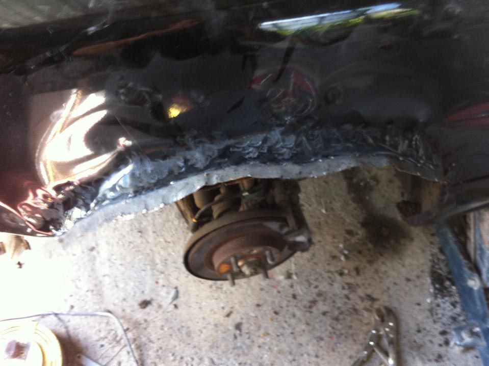

Next push the Mole grips as far over the edge of the arch as possible, as shown, and bend upwards until the lip is at 90 degrees. Work around the whole arch as before.
You will need to use a pair of hammers to push the arch into it's finished shape (unfinished arch shown below).
