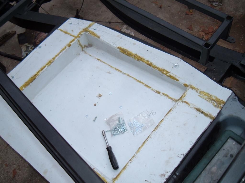

Here we go.... putting in the floorpans.
First I positioned them and drilled a series of pilot holes for the Riv-nuts
Then drilled out the chassis to accommodate the Riv-nuts & pinched them in
Once they were all pinched in I positioned the dropped floorpan and ... sure enough, all the bolt holes lined up. I can now put some mastic down & fix the pans properly. Here they are just in place to make sure they fit.
