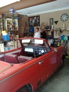

this is my donor and:
the engineer is hopeful of a "modified classic" pending some info from mike.

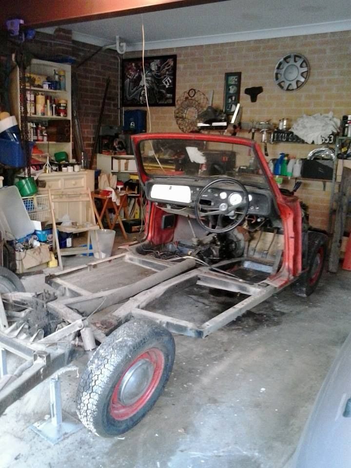

heres a pic of the car witht he body off (except the scuttle - sorting the engine out before removing it for cleaning etc)
you can see the great condition its in - no salt grit on our roads!

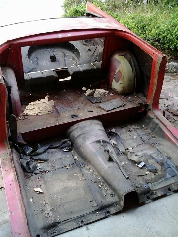

the body has not fared so well:

That chassis does look to be rust free. Almost exactly the same as mine wasn't...
