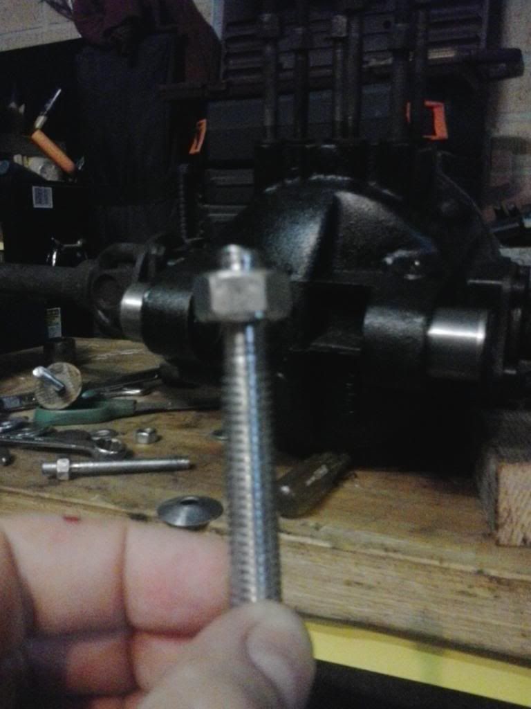

Well, with an improvised lathe (a drill in a vice) i put a 1mm shallow taper on the end of each bush to help them in, and success! At least partially. The threaded rod i bought for this purpose keeps stripping, and i have each bush part way in. I will be picking up a high tensile bolt this week and some matching big washers (one i initially used stacked 4 high ended up like cones) to get them the rest of the way in.
Thanks guys for your suggestions. When i have the chassis painted I will post up some picks of it and the assembly. Then I have to get in touch with mike about the kit!

here is the result of the first attempts, note stripped thread rod, and partially in place mounts..
something funny has happened to photobucket on my phone. had to get this via friendface.

diff mounts almost in. just about 6mm to go and snapped 2 high tensile bolts. it seems not only the bolts the issue but the washers as well. will need some more wd600071's as ruined 4.
