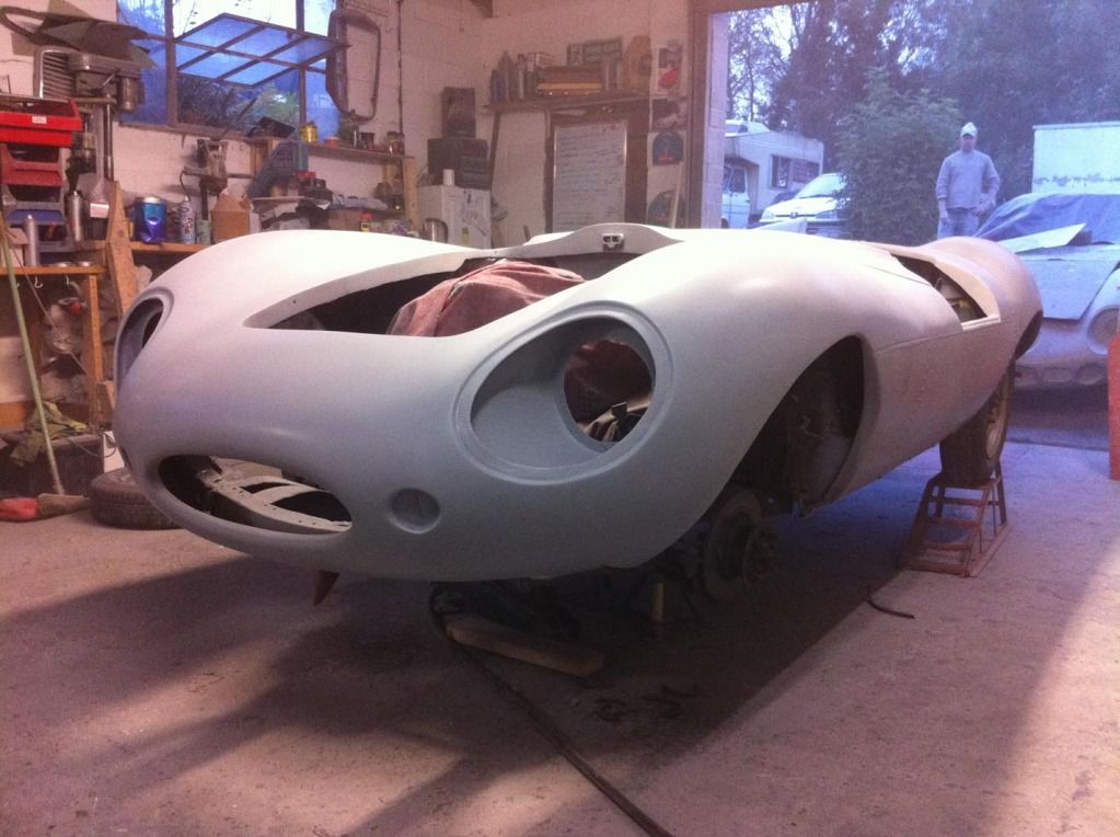

Due to the large bonnet bulge it's not been possible to fit normal hinges at the scuttle end of the bonnet, as it would bind in the centre, fitting hinges at he front end would be possible but looked untidy. A simple solution was found by pivoting the bonnet at the sides about 6 inches from the front edge. There is plenty of room in front of the Spitfire radiator.
A pair of MX250 headlight buckets were cut from an scrap "plug" front end and modified to fit the A352 headlight openings.
They were tech screwed in positon and then fixed with bonding paste.
The rear end is now ready for primer
Panel gaps all done
"Does my bum look big in this?"

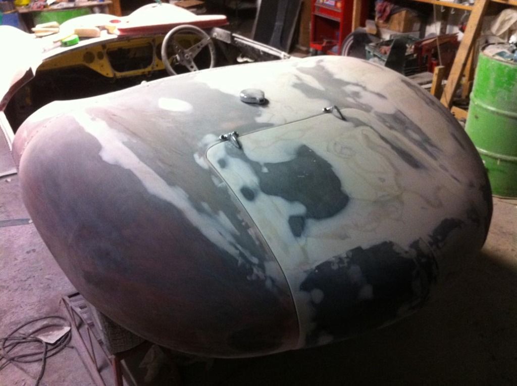

Thanks for the comments guys. Colourwise we are going for the "Not enough hours in the day old race car barn find patchy scratched primer" look, a winner in my book (my book being "Hot Rod" magazine). The body will be coming off for tub/chassis restoration, so no point in painting yet.
Sorry Nick, we have put wider wheels on!
Made the screens and headlight covers out of 2mm perspex, a bit thin but easy to work with when you are in a hurry
Quickly fabricated some screen posts out of sheet alloy
Sorry for the fuzzy pics, it was a bit dark....
