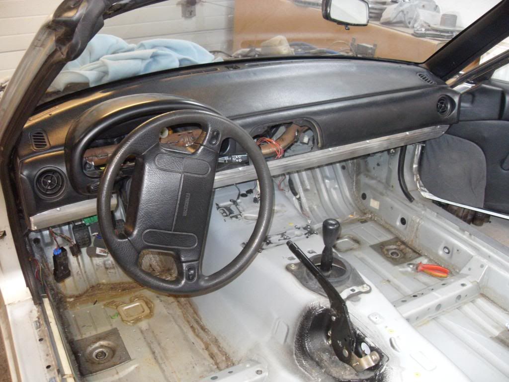

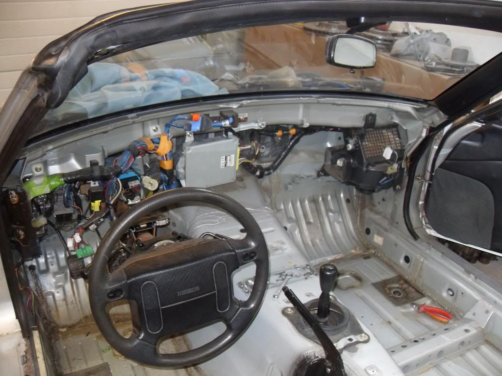

The mx5 is pretty light as it is in standard form, but my intention is to take it to track events, so i want it lighter. Pulled out the heater, a lot of sound deadening, cut away half of the dashpanel, relocated the ecu and pulled out the kick panel and bracket for that, center console and misc. deleted, floor carpets out of it, will add some very light carpet/felt in it, but only where visible. All this was 31kg! 940kg car minus 31kg makes a difference just over 3%! Kept the fan function, and pulled aluminium hoses to the vents from the fan.

Dashpanel cut i half, wanted a more vintage, narrower dash. Made a new shorter "skirt" for it in aluminium. Then put a chrome trimming on it and some carpet/felt

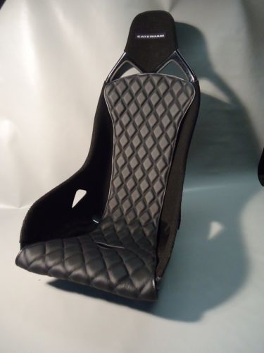

Thanks for comments! Glad to hear you got inspired! So am i when i jump around all the threads looking what others done and getting ideas, some i knock of, some i modify to my taste. That is what i find so amazing with kit cars, all the different solutions! Love it!
Bought nos window cranks and opening handle for fiat 128 on ebay. Made a bracket to fit on door.
Cut out new door panels witout recess for speakers (i won´t have a stereo) upholstered them with diamond pattern fake leather, carpet on the bottom like an old car, and some chrome trim just to get it look older.

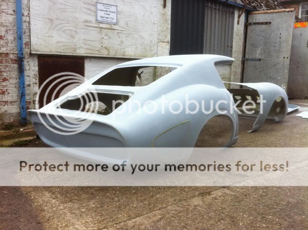

Default Face Off
Andreas's kit out of the mould and trimmed. Bonnet will be bonded to the front section and the lower rear sections of the wings separated to form a flip front. The 3 front vents will be removed at the same time.
The rear vents were blanked in the mould.
