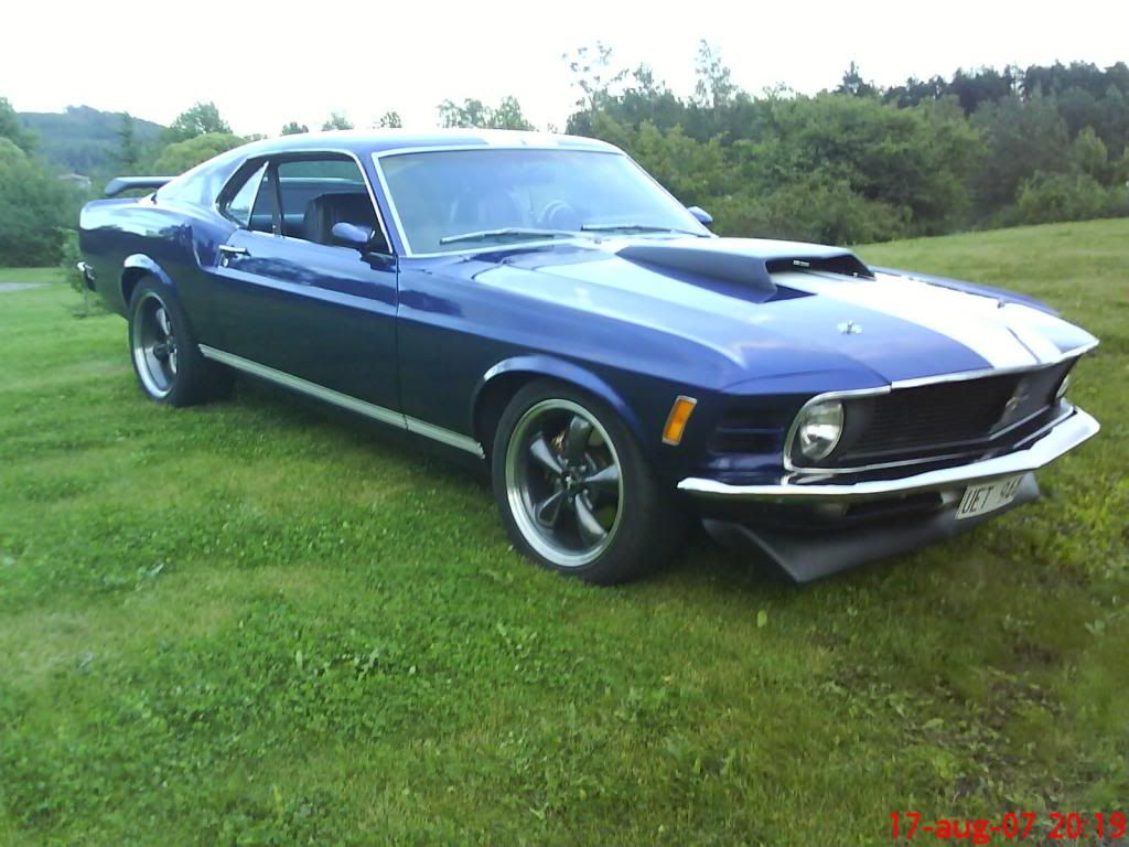

Yes, stripes can never go wrong! Got them on a gt40 i built (me and my father in law up to the left) and also on a mustang i restored from a pile of rust...

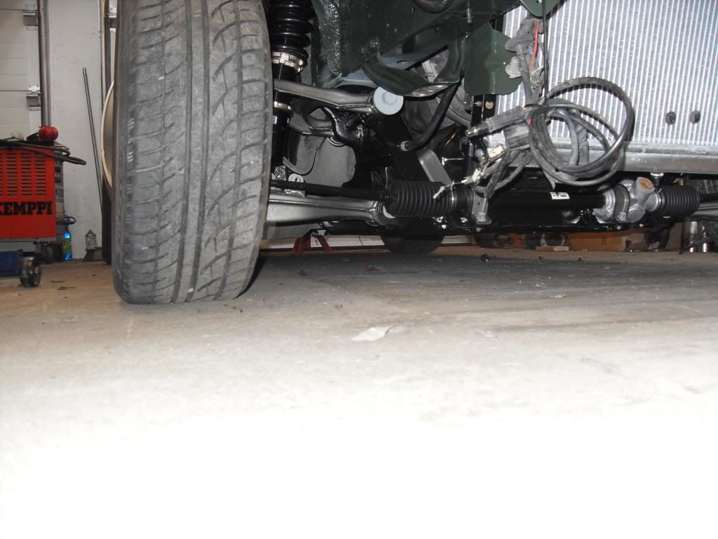

Found adjustable coilovers (BC Racing) for a great price, so i drove to get them in a hurry!
Dont need those anymore!
When i was in the move, i pulled down the front frame, a-arms and etc, blasted all and sprayed it all up with a very durable paint.
Rears easy to access from trunk too...
Rideheight 8-9cm...

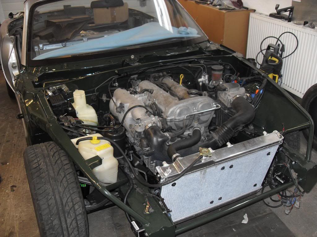

This is the finished engine bay. Had to reroute some wiring because of my front modification. Bought a nice bigger cooler, as they say they tend to overheat when ran at track... Havent done anything with this engine. Not even cleaned it, as the plan is to replace or build it up for a litle bit more power.

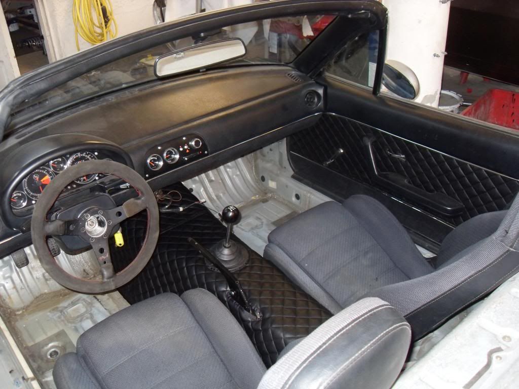

As i deleted the center console, floor carpet and etc, i needed something for the tunnel. So with help from my fiance (and 1.5 year old son) we managed to stitch up something in diamond patern fake leather.
Finished "overlay"
Trial fitted in car
To match the door (yes i had to dig the door out just to see how it looked)

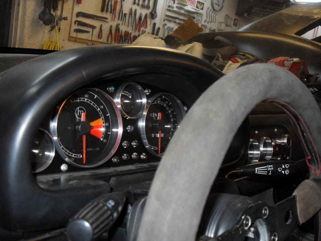

Got the lenses for the instrument cluster, so fitted them, and it works great!

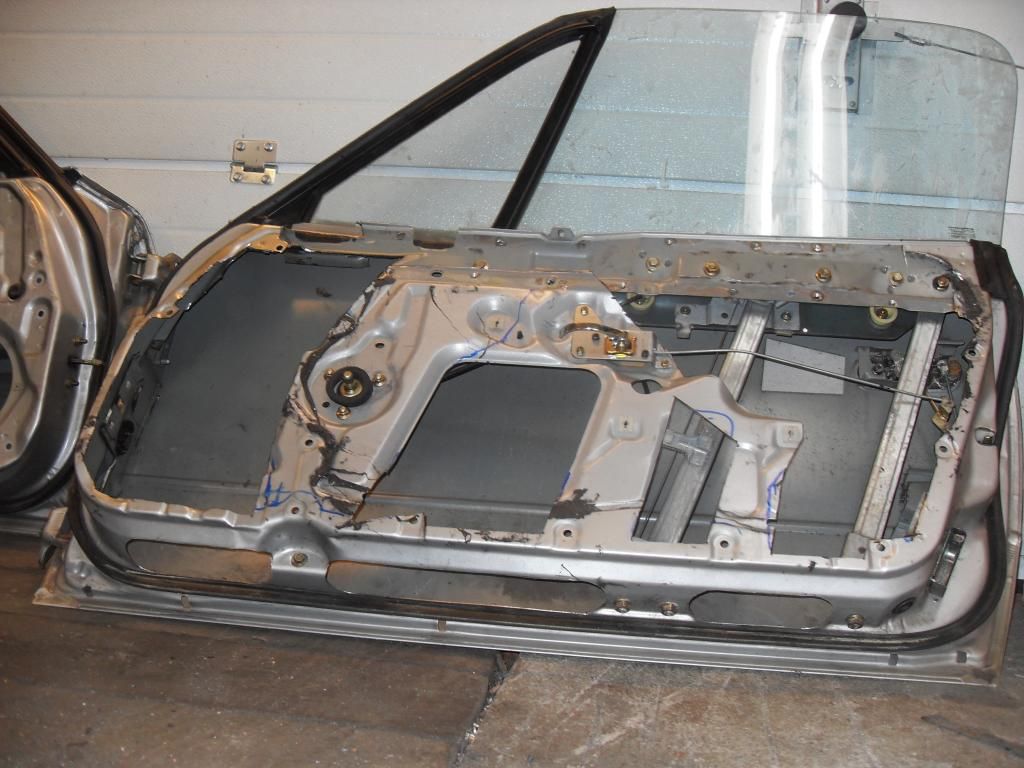

While awaiting the body to arrive, i went loose on the doors, they are bloody heavy on the lite miata! Took out everything not needed to keep all functions, and the gain was 5.8kg on one door. That makes a total of 11.6Kg! Door still feels ridgid too
  #58

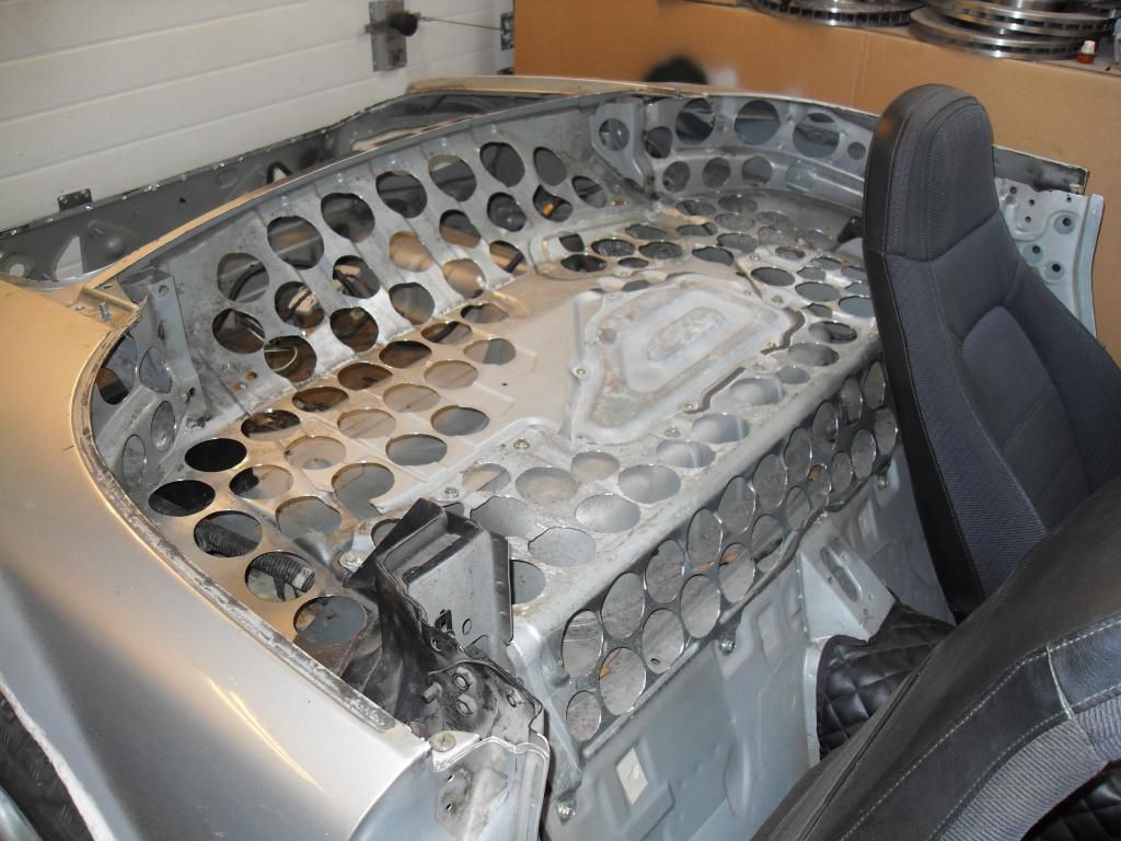

Went loose on the rear of the car to. Cutting out all non supporting brackets, sheets, flanges etc. Gain 13.3Kg
