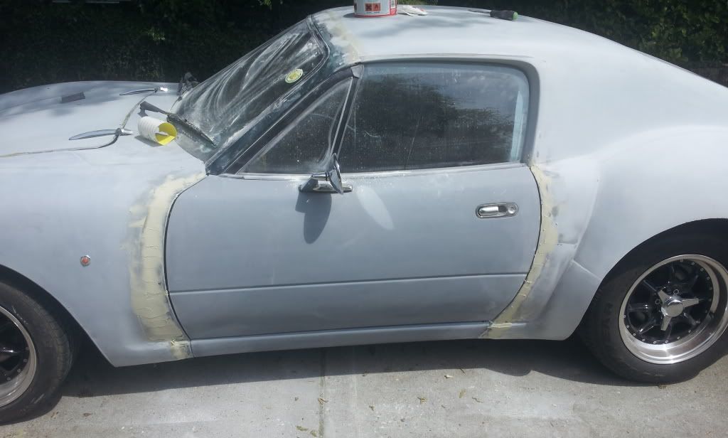

Sanding again
A lot more sanding today on the joins....
The roof starting to look good. However I noticed two of the rivets on the rear wing were definitely gonna show through the final paint job and having seen that at Stoneleigh I definitely didnt want that....
I ground them back a little after this piccy was taken...
Im now working with the easy sand and its really taking shape

Hi HAmmy,
it taking shape, its easier with the MK1.
Our MK2 have eaten pounds of fiberglass putty.
Your wheels look just great i like it

Thanks Heinrich, the passenger side is nearly done....
