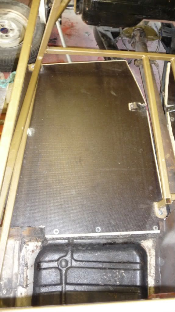

Got the floors fitted and secured over the last two days, ended up using Phenolic resin coated ply, (as used in trailers and truck beds).
May have gone a little overboard with 18mm thickness but very happy with the results, it has a smooth waterproof underside and non slip waffle surface on top.
Where it joins the bulkhead I have cut an angled slot and pushed it underneath the raised outer edge just to give it a nice finish before fibre glassing in.
A bull nosed edge just keeps it looking neat along the edges but these will not be seen.
It still needs a little trim down the outside rear where the body tucks in and the fresh edges sealed but overall has gone down ok and feels very sturdy

Floor looks good psycho.
Roughly how much was it, do they do 12mm and where'd you source it from, local Norfolk supplier by any chance?

Hi
It was from a guy in syderstone nr Fakenham. £44 a full sheet, only 18mm or 22mm thickness which is why I ended up with 18.
He advertises on e bay.
Cheers Psycho

Correction
£41.50 a sheet, Yes it is more expensive but no maintenance, no annual re coat
thats what sold it to me ( and it looks good )
