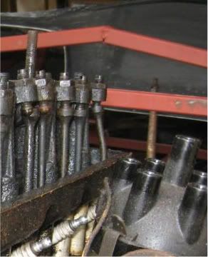

Had my first go at welding today, i think i ended up with a better idea of what to do... Mr.T, what thickness metal did you use to plug the holes? Quit a lot of work to do on the chassis which looks quite fiddly as there are alot of brackets around the area.
I used 5mm x 50mm strap iron for the repairs around the front outrigger and 1.2mm sheet for the areas that needed over plating.
That's because that's what I had to hand rather than for any complicated technical reasons.
Oh, and well done for having a go at welding, nice to see another newbie having a go!
Old 17th February 2012, 09:33
That sounds about the same as me. I used 1.2mm for floor and outrigger repairs as that i what i had left over from my floor pans, and it seems about the same thickness. Then a bit of 3mm sheet i had left over from my last project for repairing some of the thicker pieces as it seemed to be the same thickness?
