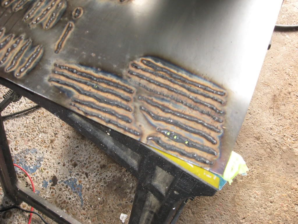

Default Finally started to weld
I know it does'nt look pretty, but once i started to rub down i thought it looked better... I will just add some weld where the holes are.

I would consider plating the whole side, bending a flange on each edge to give you a channel section so you can weld onto existing doublers. Then you can prep a bit harder before you weld as the metal is thicker, up the amps a bit and get a stronger weld. Before the final fit either remove the old section or take out some metal with a hole saw so when you finally inject some waxyoil it gets where needed.
yrs, Nick
I'd love to do that, but have no folding equipment. And those outriggers are more than 24" and tapered... thanks for taking time to offer advice.
And i will up the amps!

Old 23rd April 2012, 10:14
Posts: 5,327
Looks fine to me: it's exactly what I did to mine.

Yep, up the amps, and move slowly, the aim is to 'puddle' the molten metal and 'drag' it along the join.
Also, you can make up larger holes with several smaller patches to make it easier to shape. Have a hammer handy and as the metal gets warm with the welding you will find it is much easier to bend into shape and form curves etc. it will 'stretch' a certain amount too. I have an assortment of bodyshop hammers with points, flats, shrinking heads etc which come in very handy! You can never have too many hammers!
Well done, though, it is the start of a very satisfying journey!

Can i fill the small holes with weld? and if so, whats the technique?
yes you can. I am assuming you are MIG-ing it.
You will need to do it in short bursts. Work around the edge of the hole and that will give you something to bridge the gap. Again, don't be afraid of holding the arc in one stop to let it puddle. you will get good penetration of the weld then.
If you are filling holes you made whilst welding then this is fine, if you are looking to fill small rusty holes then it may be better to put on a small plate as you will find the small hole will grow and grow!
As mentioned, it is sometimes better to cut out the rusty bits and put on a plate about 10mm bigger than the hole, so when you waxoyl the box section, it will get where it is going to protect the plate. Otherwise the waxoly will sit on the inside of the rusty bits and not get on your new plate.
It may also be worth getting hold of some "seam-sealer" (I use the U-POL P88 stuff) which is brushed on like a thick paint over the welds and adds another layer of protection before you paint. It can be painted into the nooks and crannies that the MIG gun won't reach.
