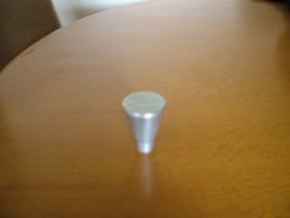

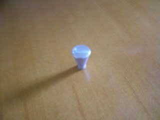

Thanks for the offer S and WCA, but i really want to make it myself. I have bought some ali 50mmx100mm. I have done the shotblasting, trying the welding. i have the powdercoat equipment/oven, and will probably do everything else as well. Something i am looking for is a DVD on rebuilding my 6cyl. engine?Here the picture of the gearknob.

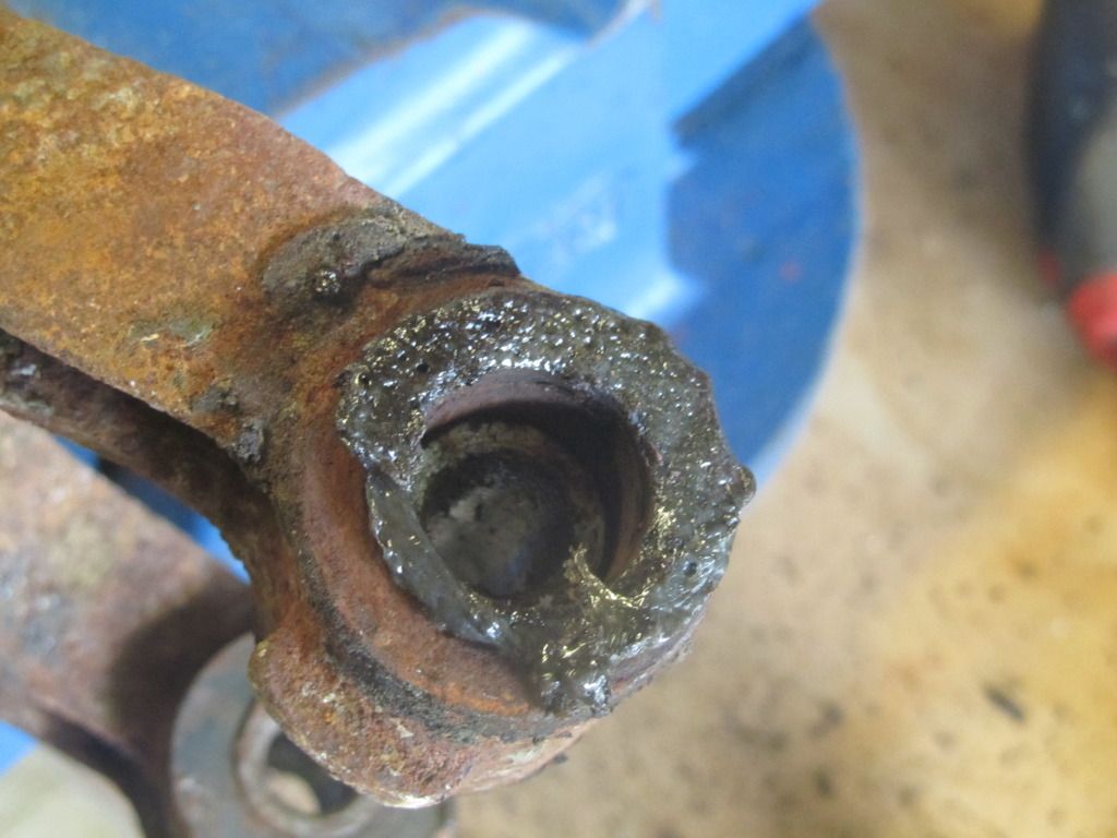

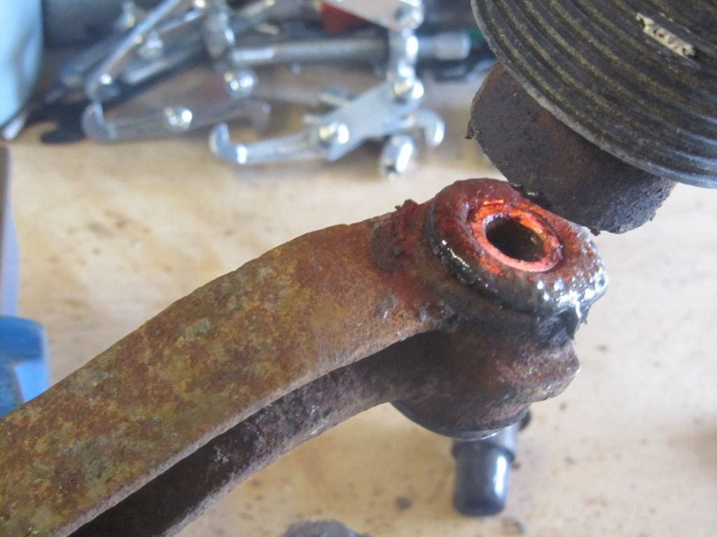

The picture of the vice and ply reminded me of all my efforts in getting the new bushes in using G clamps, large hammer and all sorts.
I then had a divine inspiration moment and got some threaded rod, and washers some sockets to pull against....plenty of washing up liquid and heyho a bush replacement tool....they wound in with no effort at all...
The removal of the old ones was a bit of a bitch.....I drilled through the rubber and then had an old log with a hole in....placed an old bolt a washers in the bush and beat hell out of it with a lump hammer....in the end with suprisingly good results.

gary after seeing you picture, i jumped on a lathe and knocked up this little beauty, with sammio engraved on top, just to tease you a little...

Posts: 615
oooh, nice work Mulberry.
  #48
Old 27th April 2012, 21:55
That's cruel, Mulberry. You cut me deep...

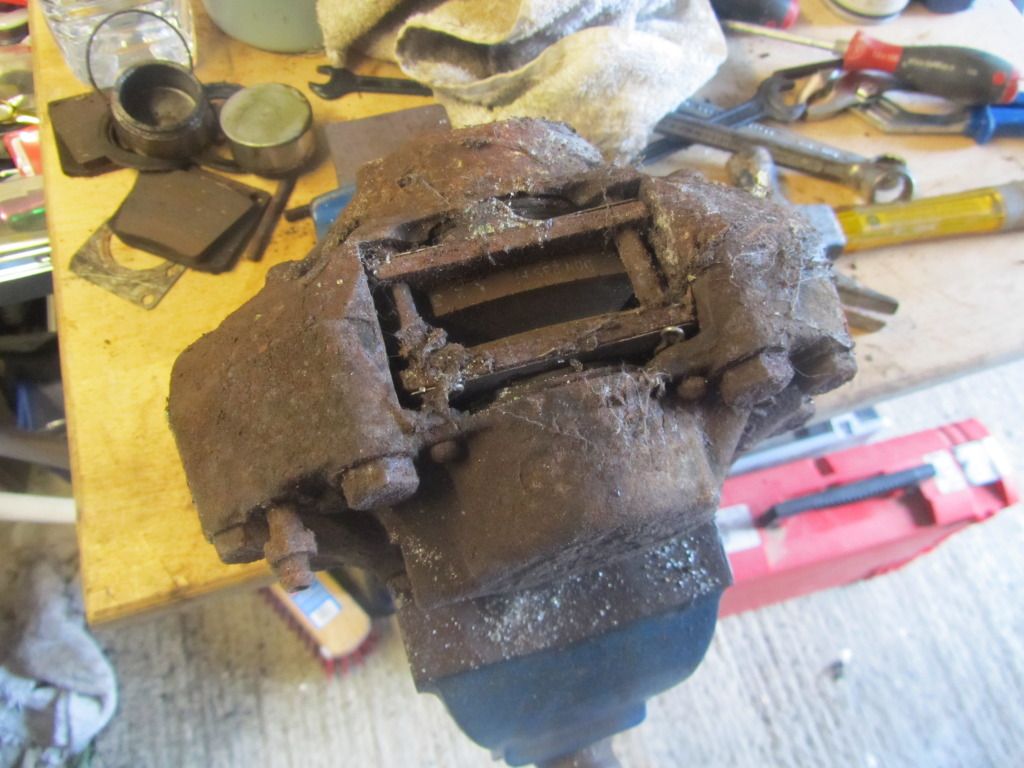

Default Thanks for 'Hot Air Gun' tip
Now this was a good idea...
Just knock them out after a couple of minutes, 'Simples'
So i got a couple of things done today, once the rain had stopped. And stripped the brake calipers down as well.
