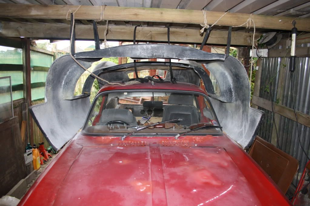

The G46 body is now hanging from the garage roof and the donor is going to be rolled back underneath.
I have removed all the rear end lights, bumper, numberplate etc.
Eased out the side windows and the unbolted the rear hatch.
Removed all the roof and side trim and drilled out the roof guttering.
removed all the wiring from the interior light, heated rear window and rear lights.
So the donor has lost its trousers, but still has its shirt as the front is still intact.
I have put a few holes through the roof from inside the donor just behind the anti roll bar to act as a guide as i want to leave the roll bar in place to assist centering the body. (or to make life difficult for myself)
I will make the cut at the highest point of the lower edge of the side window to remove the roof
Photos with the roof cut off and the donor under the G46 kit to follow

We are currently working on the door cills, nice to see another body so we can compare, its looks as yours is identical to ours where the drivers cill is a lot deeper and tucks under more than the passenger side.
As they have to be cut it gives a lot of scope for modelling them to suit the individual car, we are making a recessed section down each side to take cherry bomb exhausts, proving a little bit of a challenge but getting there.
We found the roll over bar just got in the way and ended up chopping it off so we could line up he body.
If you go to our very first page on our thread we posted a few photo's of the body cutting up which may assist as did WCA or should I say (hop along) WCA was definitely the right handle for him!

It is quite a lot of chopping to be done. Just remember that the frame supplied sits on the plastic door sills of the donor. If you chop those away you end up with the floating frame design of my special 'light weight'. It was a deliberate decision, honest*
*Okay, it was a mistake because I couldn't work out how to get the frame to sit properly but right now I am allow 'lame' excuses
Don't forget to keep your rear seata and door hinges for later re-use. Door shut mechanisms probably useful too.

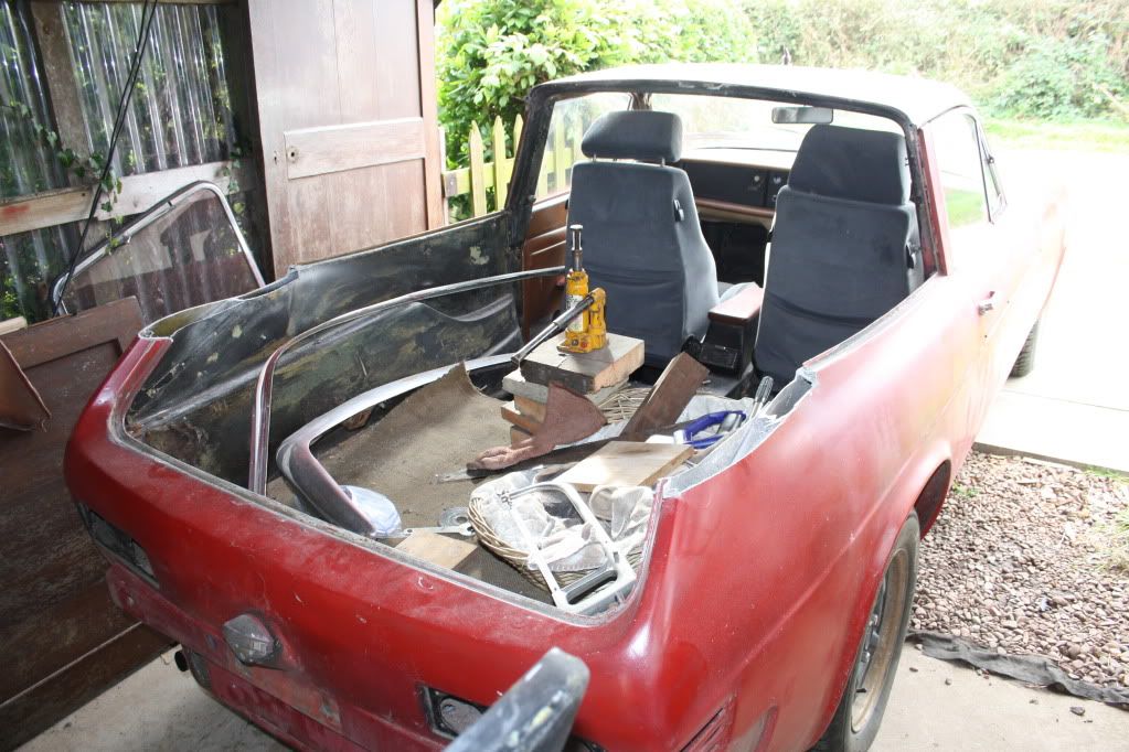

So the ultra thin cutting disks have been put to good use and the GTE is now a pickup.
I was curious to see if there was any stregthening around the rear hatch and Reliant do have a 10mm metal tube enclosed in the fibreglass.
(you can see it in th photo above)
This seems an elegant solution to avoid metal work inside the car and add a significant amount of strength easily.
I wondering if I can do something similar with the supplied metailwork

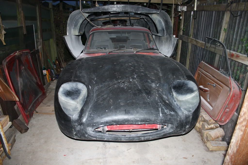

I have rolled the donor backup under the body and trimmed the side skirts so they are straightish and sqaure
LIke CT says the roll bar is getting the way so that is next for the chop.
However, the door provided are a very tight fit in the body and I was wondering about cutting the body
down the middle of the door aperature to increase the opening slighty and simplify the alignment.
The door trailing edge of the door should be easy enough to extend with bnding paste or this this a no no?
What are your views on this Gary, AH, GWA or CT?

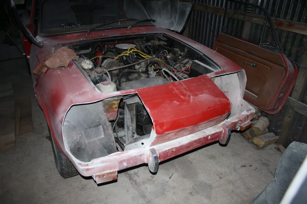

I need to locate the bonnet to keep the garage tidy so i set about cutting the relief for the headlights.
I hope to keep as much as possible of the existing inner wheel arches below
Ever wondered what a G46 with a windscreen might look like?
Well not as striking as the aero screened version Gaz is about to reveil at exeter.
The bonnet still another 6 inches to go before it lines up with the wheel arches,
so I need to figure out how to get the siezed front overridders and indicators off in a saleable condition for ebay

Doors are a tight fit on mine. i haven't had a chance to fit the hinges since twatting my ankle but have trimmed the rear edges off the doors in preparation. They also have a slightly different amount of curve at the moment but that may be down to the straps I have holding the body work in place.
Be aware that sticking a ratchet strap around the body and tightening makes a huge difference to how the body sits. Make sure you have the bonnet lined up with the body before fixing the body otherwise it is possible to pull the body in tighter than the bonnet can curve and you have to cut the bonnet to fit.

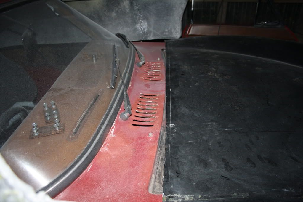

Are you planning on keeping your screen?
I am planning on putting a proper screen on mine and have the old Scimi windscreen glass. If it looks okay in your picture I might consider that option.
Even if you are not planning on keeping the screen, please can you take a couple of 'mock up' pictures to help me see what it might look like.

The Scimitar screen looks pretty good to me - it has something of the e-type coupe about it. Could be made to work...

It's perhaps a little tall for a 'convertible' but I'm sure you can get screens cut down and aluminium side support posts made, a-la Porsche 356 Speedster.

Are you taking a slightly different route by cutting off lumps and then seeing if the panels fit over? I am pretty sure the rest of us have cut the body off and then place the new body on top of the floor plan and bulk head left.
WCA I am not sure if the body does need to have a ratchet strap around it (like a spyder) it looked to me and only opinion that from the photos you posted that it brings the back wings in to tight almost touching the the old inner wheel arches where as ours and others don't seem to meet them.
100% in agreement with WCA about the re-use of gauges new ones are not cheap and the black smiths are as period as you like.
HM we cut the body shell because of the changes we mad to cut the body heel to make the doors fit better would be a huge amount of work I think I would adjust the length of the doors.
HM if you go the LL link and our early posts and WCA's (apart from removing the cills') they will give a reference to how much of the old car to leave in place, when we did it we only had the LL photos and the photos we took of the fist car in development at his workshop so it really was working in the dark.
