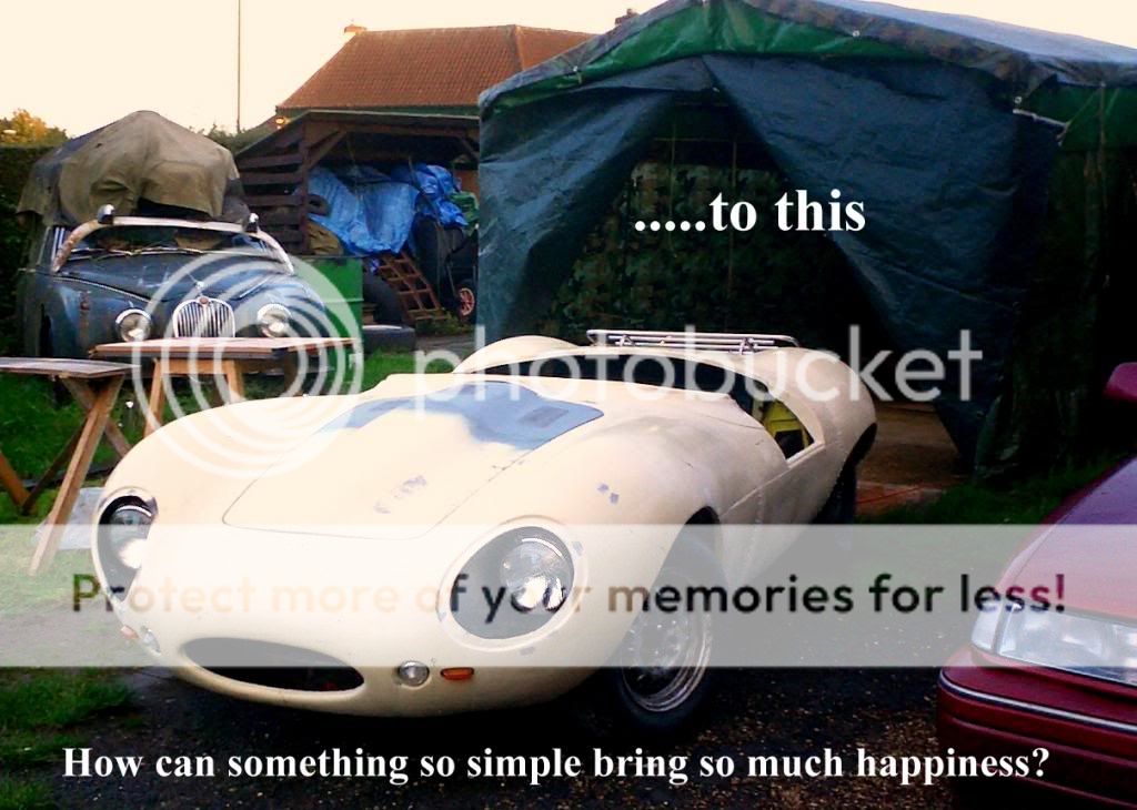

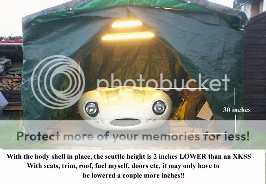

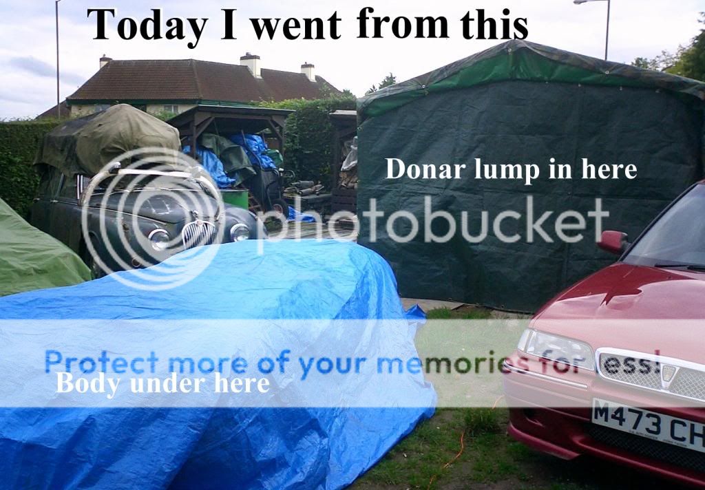

Today was a low for me, I felt I was not doing enough work, I had lost direction, the weather was against me, I was never going to get this car done etc etc. I expect you chaps have all been through this, but it was new to me.
Then a friend came to see me and suggested we put the body on the car.
The car by the way, even in its shit state, starts and drives.
Anyway it only took 10 minutes, and and JC! what a happy MF was I!!!

Scottie - It is easy to see why you have a smile on your face, the car already looks great.
I do like your temporary workshop, especially with the lighting.

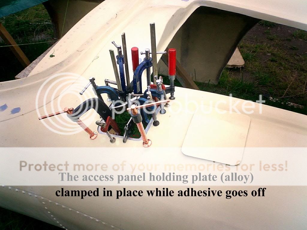

Originally Posted by Scottie22 View Post
[IMG][/IMG]
I'm impressed you had that many clamps
  #87
Old 29th October 2013, 08:38
Posts: 1,120
I thought it was a handy box for storing clamps.

Do you really need to lower it any more? Don't get me wrong, I'm a big fan of slammed cars and my original setup was 95mm cut off the front springs and a 90mm lowering block under the rear leaf spring on the Vitesse chassis.

I had a Robin Hood couple of years back and the lowest point underneath was around 2.5 inches, it hit the rear lower suspension regularly and wore it away so much I had to weld it back to build it up. I welded two steel skids, one each side to help it "slide" when it touched the road, that worked quite well.
The "lowering it 2 " more " bit was obviously a FAILED attempt at humour!!

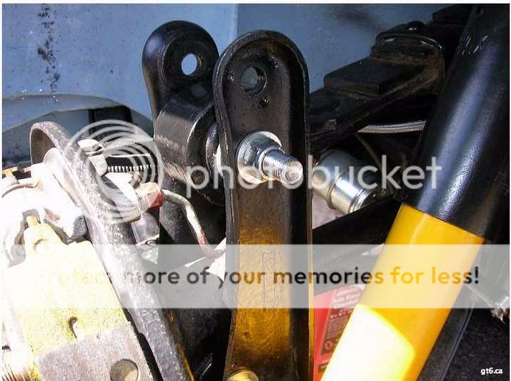

[IMG][/IMG]Mister Towed,
I was interested in what you put about you lowering, and how you approached it. quite brave stripping the spring and all!
My donar when stripped (and light) had crappy looking positive camber, and was too high.
I took the spring out de [IMG][/IMG]rusted, cleaned and painted it, put it back in, then it occurred to me I should have dumped a 1 inch lowering block in there at the same time!
I was basically too lazy to take it out and do it again, so I took both vertical links out, sandblasted them drilled two extra holes about 1.8 inches lower down, complete with welded in washers, which had the affect of bringing the spring eye down. I was very pleased with the result.

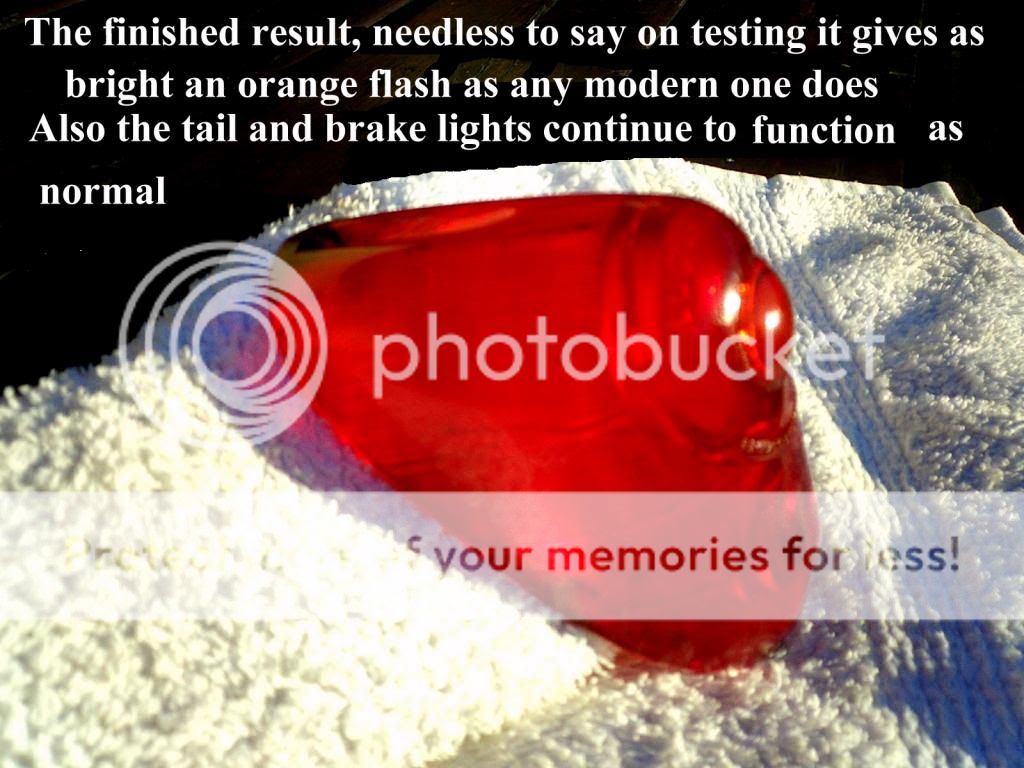

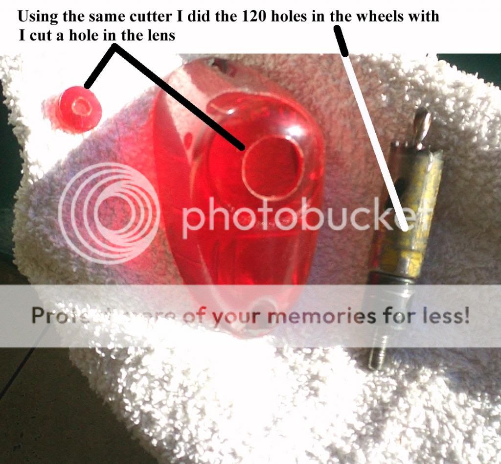

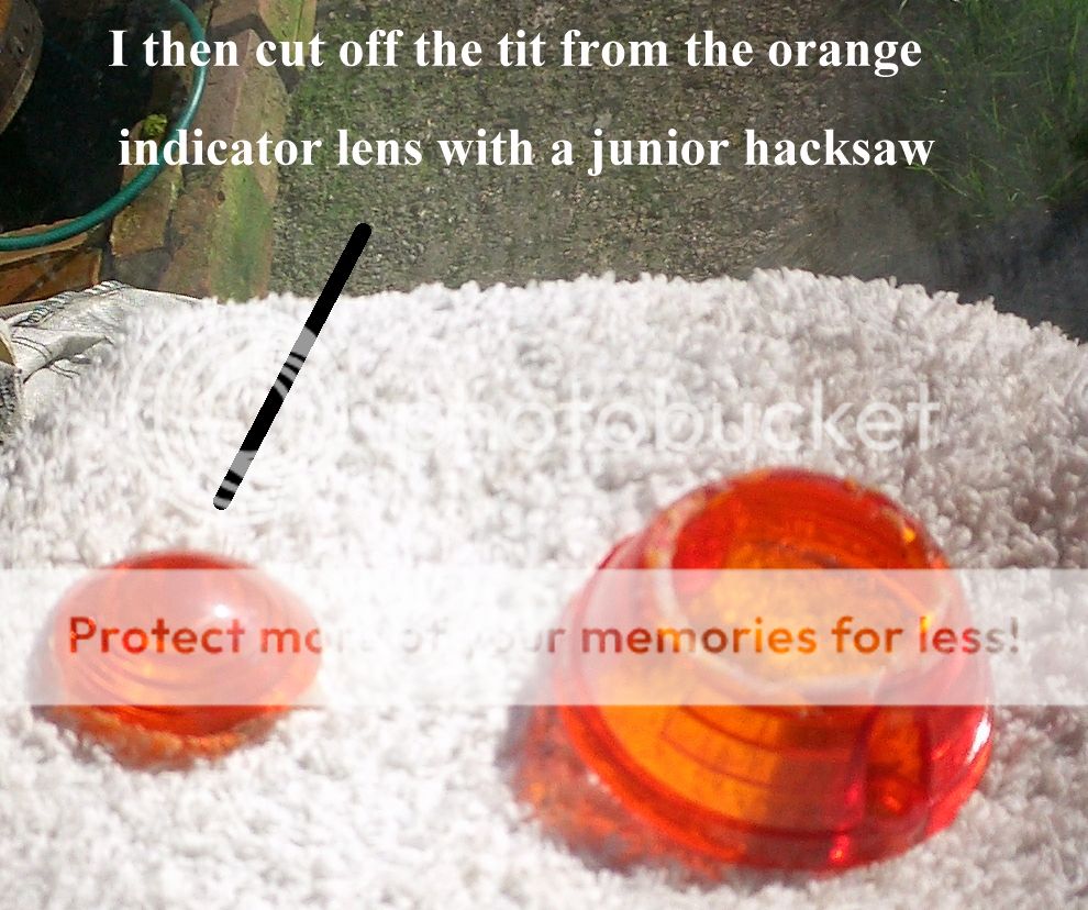

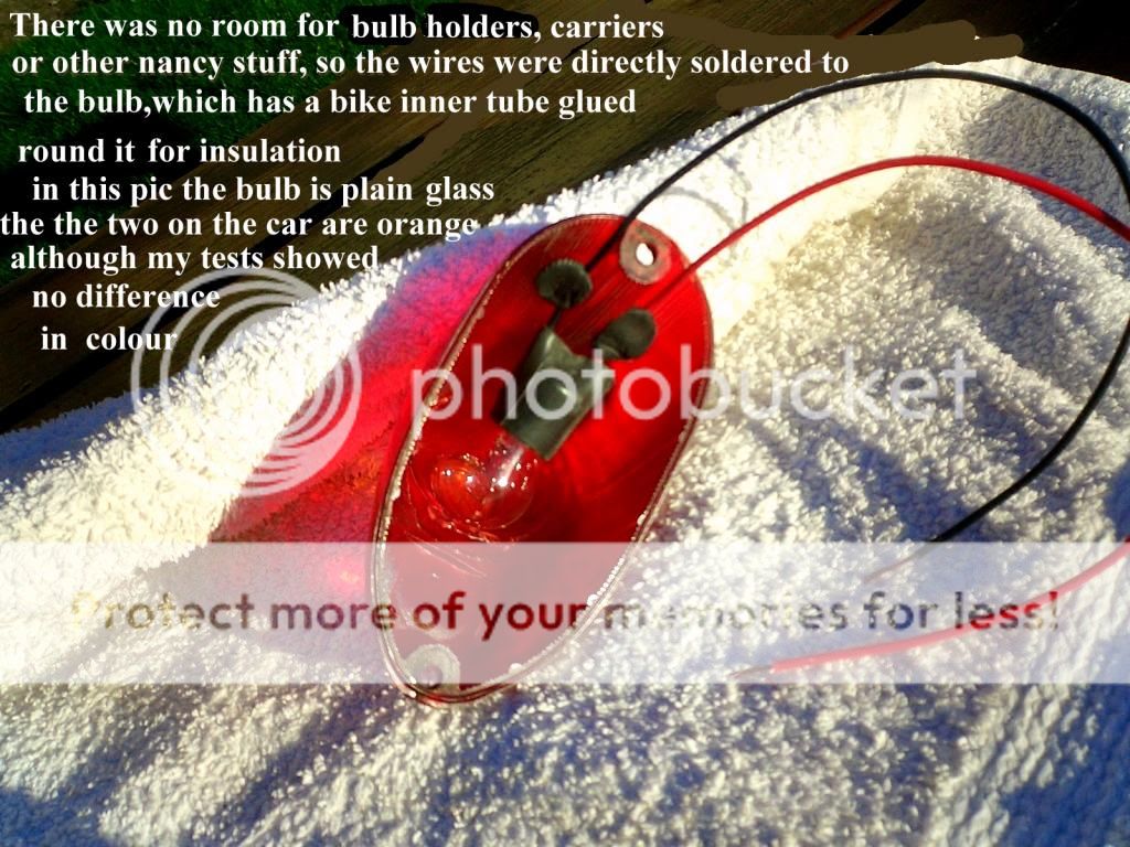

Default Rear lights again
Listen in all you “attention to detail” freaks! You are gonna LOVE this one! It’ll have you grabbing a box of tissues and heading towards the little room!

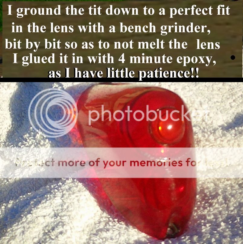

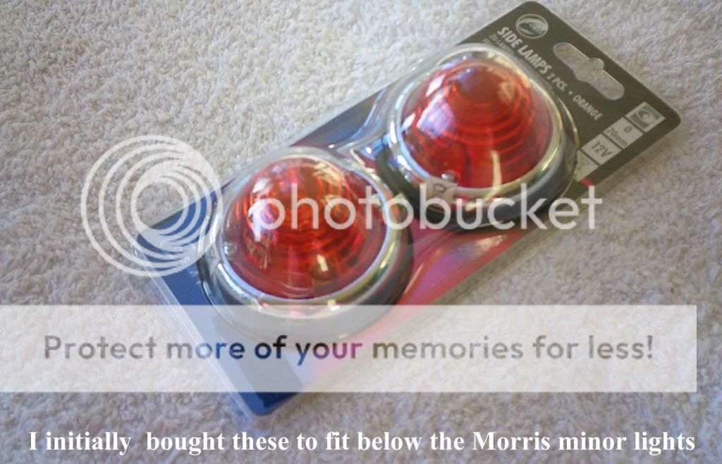

With my Morris Minor rear lights modded to fit the car, I still needed rear Indicators. The XKSS used XK140 lights which had indicators built in. Apart from the fact that XK 140 lights cost £400 a set, I wasn’t even sure they would fit, so that option was out.
I bought the usual “tit” orange type indicators, but really did not want to Disfigure the car with them, so I decided to make my own.
Hmmmmmmmmm!
I came up with the following,
[IMG][/IMG]
[IMG][/IMG]
[IMG]
[/IMG]
[IMG][/IMG]
[IMG][/IMG]
[IMG][/IMG]
[IMG][/IMG]
[IMG][/IMG]
  #96
Old 29th October 2013, 17:40
I forgot to add that the whole operation to do one light ,was less than an hour, so it wasn't hours and hours like I thought it be!
