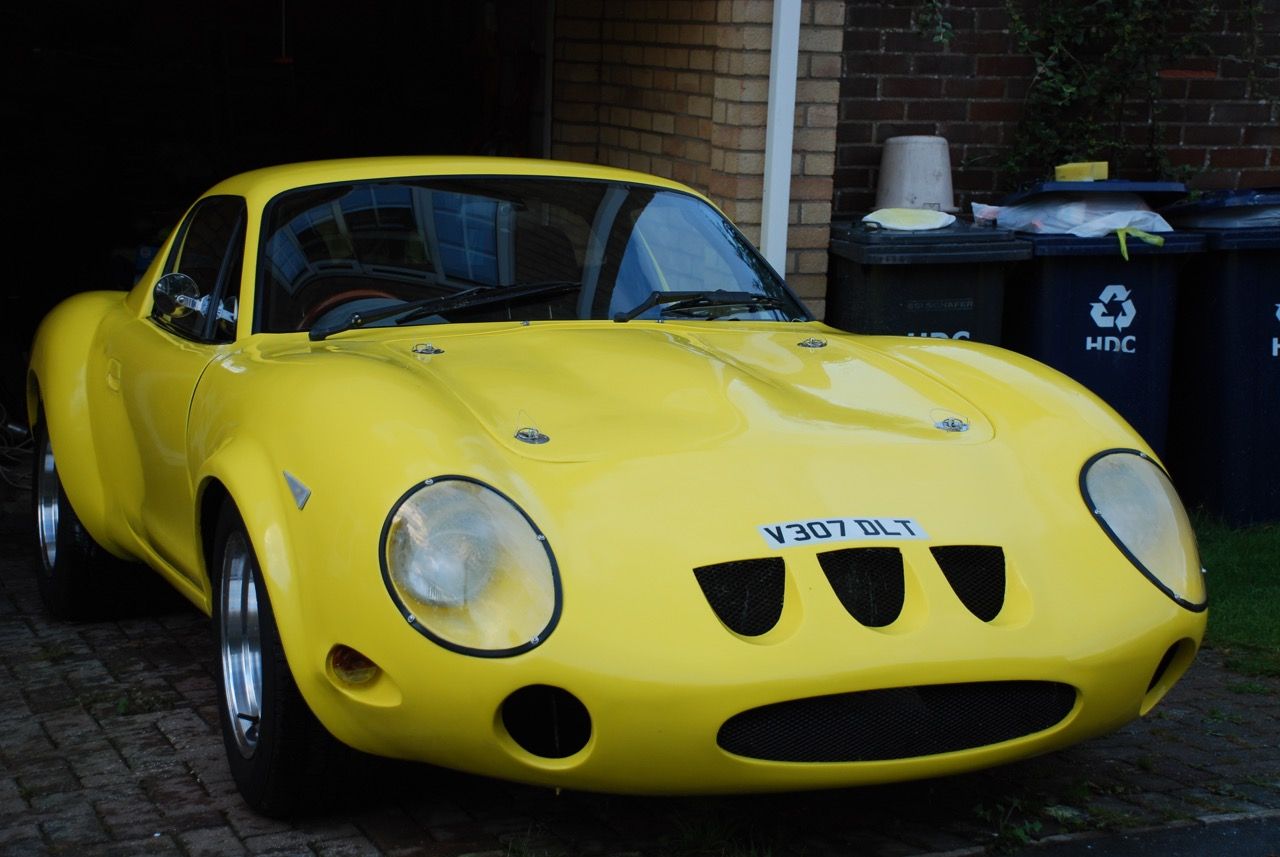

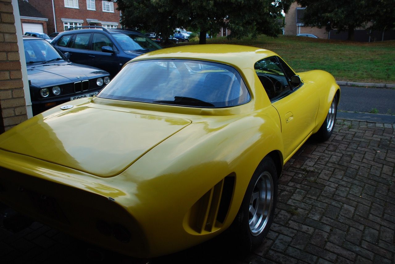

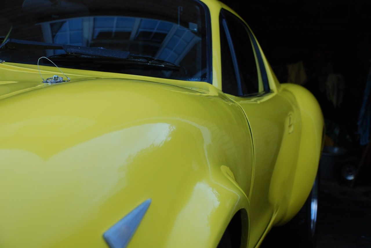

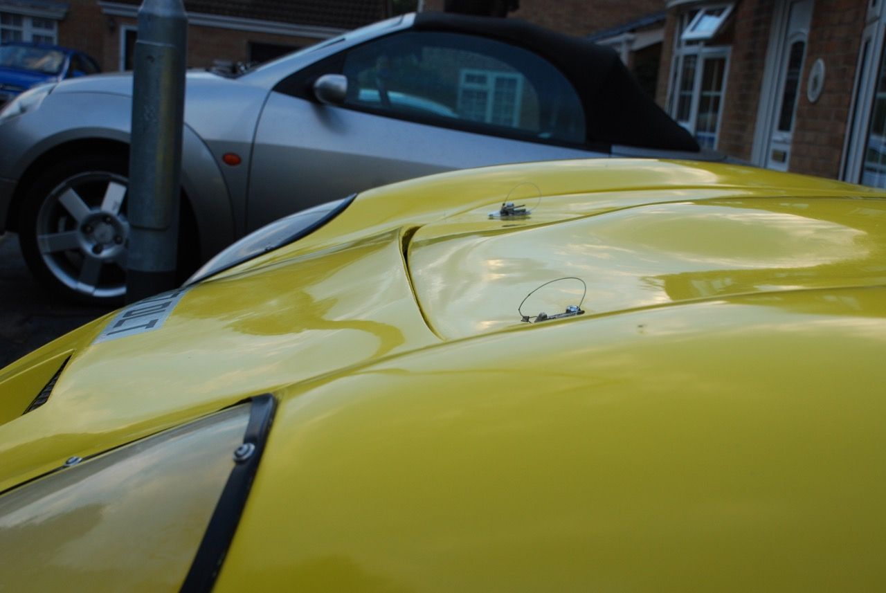

Today was spent mopping with G3 scratch remover, a wash and chamois down and then a polish with Autoglym Super Resin polish. This is the result:
[IMG][/IMG]
[IMG][/IMG]
[IMG][/IMG]
[IMG][/IMG]
My take, it's not a "factory finish" paint job but if you have a limited budget and plenty of time rollering isn't a bad way to get some colour on your car.
I think you're hugely underplaying what an incredible job you've done. We're literally talking about more than £1000 worth of savings. Even £2000 depending on where you are in the world. Yes it's not PERFECT but unless the pictures are incredibly forgiving to the point of lying id say it's one hell of a finish that any one with very little skill and a very large amount of patience can get - again I stress; for thousands less than a spray finish.
