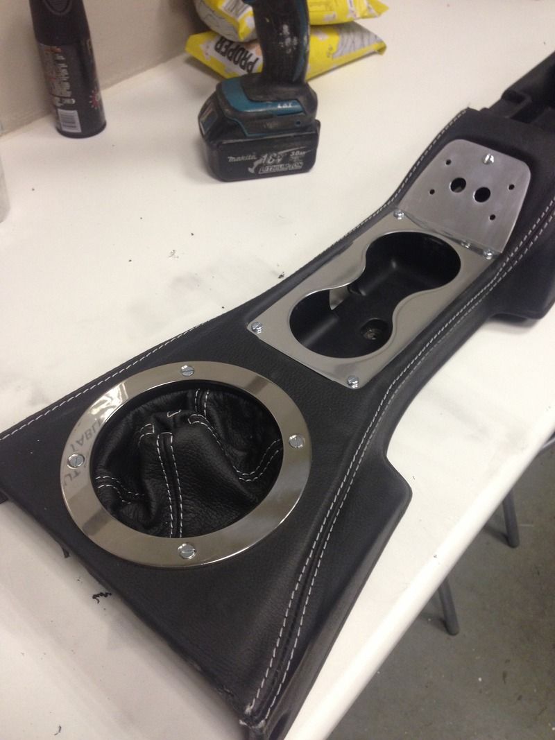

So I've decided to wrap the majority of the interior in leather. I'll be buying the leather piece by piece, pre-stitched. I've done a few bits of wrapping before, however not with glue and leather.
So heres what the car looked like before any modifcations
I decided I'd start with the centre console, as I'm going a few modifications as I go.
Here's the leather I bought, checked against the centre console for fit.
Seemed a pretty decent fit, so I started working on the console. I have never really liked the rectangular gear lever cut out, so I bought a round polished aluminium trim ring from a Cobra that i wanted to make work with the console.
Sitting on a standard leather mx5 gear gaiter;
The ring sits just right to clear the gear stick, so it was time to make it fit! No material actually needed to be removed from the console, rather i needed to add material to support the ring the whole way round. I'm lucky enough to have a CNC at my disposal at work, so i machined two layers of DiBond to fill the void, with the correct diameter hole cut to perfectly accept the trim ring.
I countersunk some pop rivets, riveted it together, and filled over ready for leather.
And the underside:
The next step was to start wrapping the leather.
i placed the leather where i wanted it, then started from the middle.
I used a liquid contact adhesive for the best adhesion I could get, and worked progressively along in small sections.
Once the piece was finished I placed the cobra ring on to see what it looked like, and was very pleased with the results!
I left it to dry for a few hours, then trimmed the leather and fixed the trim ring and gaiter into position using some m4 machine screws.
That was me done for the day! Pretty happy with it so far!

The next step was the ash tray. Using the mx5 as my daily, there was something that really bugged me; the car has no bloody cup holders! So after lots of looking around, I found the perfect thing. The jass performance cup holder!
It's a beautiful piece of aluminium with toggle switches attached for the windows. Perfect! except.. I couldn't find anywhere to buy it in this country! On top of that it was looking to be around £80. For £5 worth of aluminium sheet and two toggle switches. So i decided to make my own.
I started by drawing up a template, ran it off on a spare piece of dibond i had lying around, and tested the fit. A few modifications to the drawing later and I had a working template. Great! Time to run it out of aluminium! I couldnt find anything polished when i i was buying the piece i needed (250mm x 500mm. about £3 on ebay!) so I bought what i could, an anodized piece.
Then came the regret at buying it anodized. this meant that I had to sand down the anodized coating until i got back to raw aluminium. Once there i buffed it with a metal polishing kit i bought from eBay, came with a few different cutting compounds, polishing paste etc and a few wheels to go in a drill!
Polished up pretty nicely, so once happy I bent it at the point needed by clamping it in a vice between two pieces of timber, then simply putting pressure on it. This was exactly why I chose ally not steel!
Fitting nicely I secured it in place using some dome head m6 machne screws.

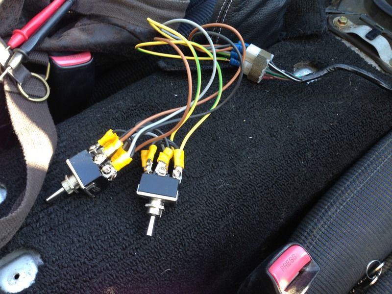

Meanwhile I wired in the toggle switched into the existing switch plug (cut down male spade connectors worked a treat here)
Here they are working perfectly, ready to be fit to the centre console. These will stay attached to the car as much as possible, as there's lots of wires to put in the wrong place when reassembling!

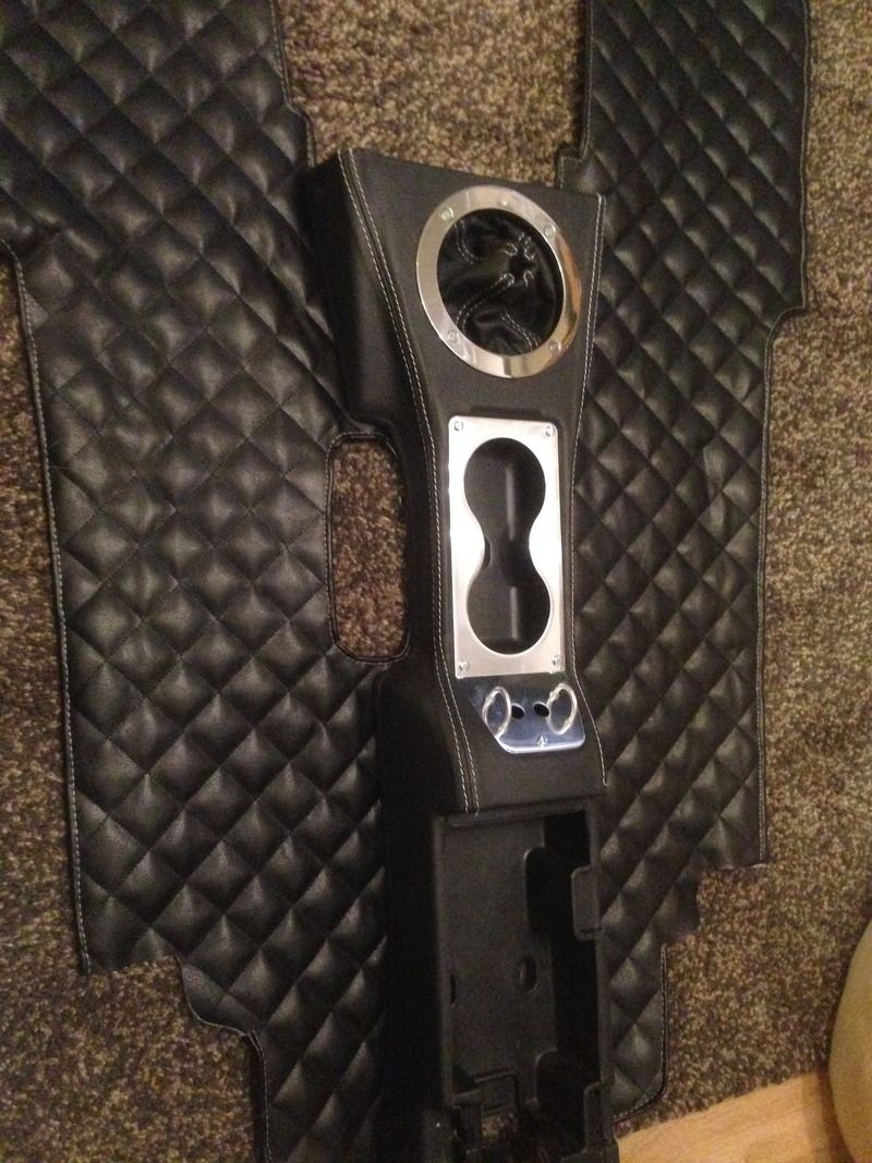

So, finishing up on the centre console, I bought two "toggle switch guards" from america (eBay... i swear I need to buy shares!), and test fit the whole assembly.
MEANWHILE I had actually pre-made a diamond stitched leather transmission tunnel cover. Unfortunately I hadn't taken any pictures of the process, but essentially I made a template from brown paper, transferred it to the faux leather, cut oversized and my wife stitched all the edges for a nice look. Here it is on the floor with the centre console positioned on top!

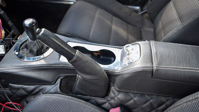

Managed to take a couple of pictures on the dslr before the sun went down. It's in need of a clean but you get the idea!

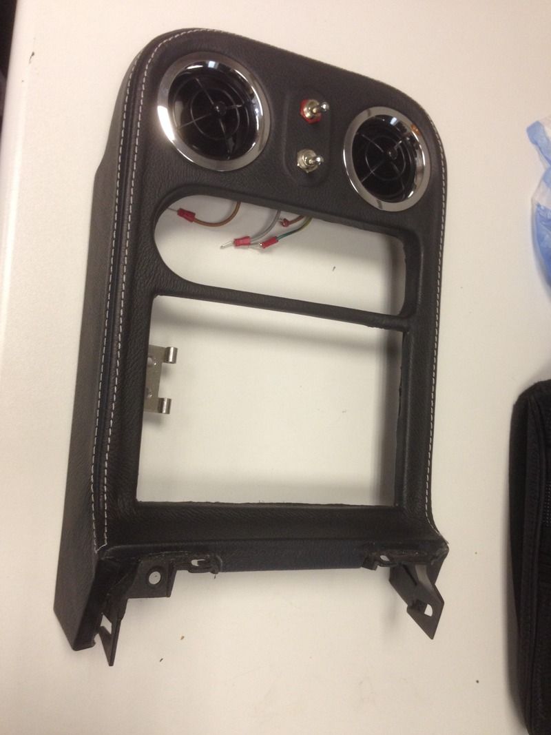

Well, my phone died today while I was working, so unfortunately i only have "finished" pictures. Today's job was wrapping the upper half of the centre console in leather. I'm mounting a Nexus 7 in the dash, so leaving the entire opening "open". I've also fitting toggle switches to the top section to replace the switches that were there. These are simple on\off toggle switches, and I simply painted the nut red on the switch that controls hazards!
Also added chrome vent trim rings bought off ebay for about £15.
The hardest part is finishing around the internal corners. People say to cut and stitch, glue, etc. But I didnt want to "break" the seamless leather. I made a solution ising baby oil and white spirit, which helped really stretch the leather, and got it to stretch pretty well into the corners! Very happy with it.
