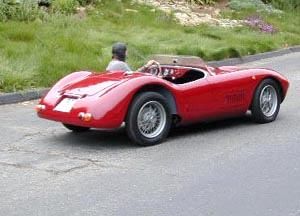

Funnily enough, I also see similarities with some of the ideas I used on my car (e.g. wider body shell to cover the rear wheels).
Having said that, I stole, sorry, borrowed, many of my better ideas from other builders.
So whilst the G-46 had a front wing section something like this new project, the Spyder and Cordite didn't.
I'm sure christinedmc's #47 was first builder I saw convert the Spyder bonnet into this style.
( Photo Cropped from a Jerome Wassenaar original, as all of Michiel's build photos have disappeared. )
So I just followed him and others (e.g. Mac & Swifty).
I guess I just really want this project to incorporate all the high points of previous builds, a Bestofa Centoventi if you will.

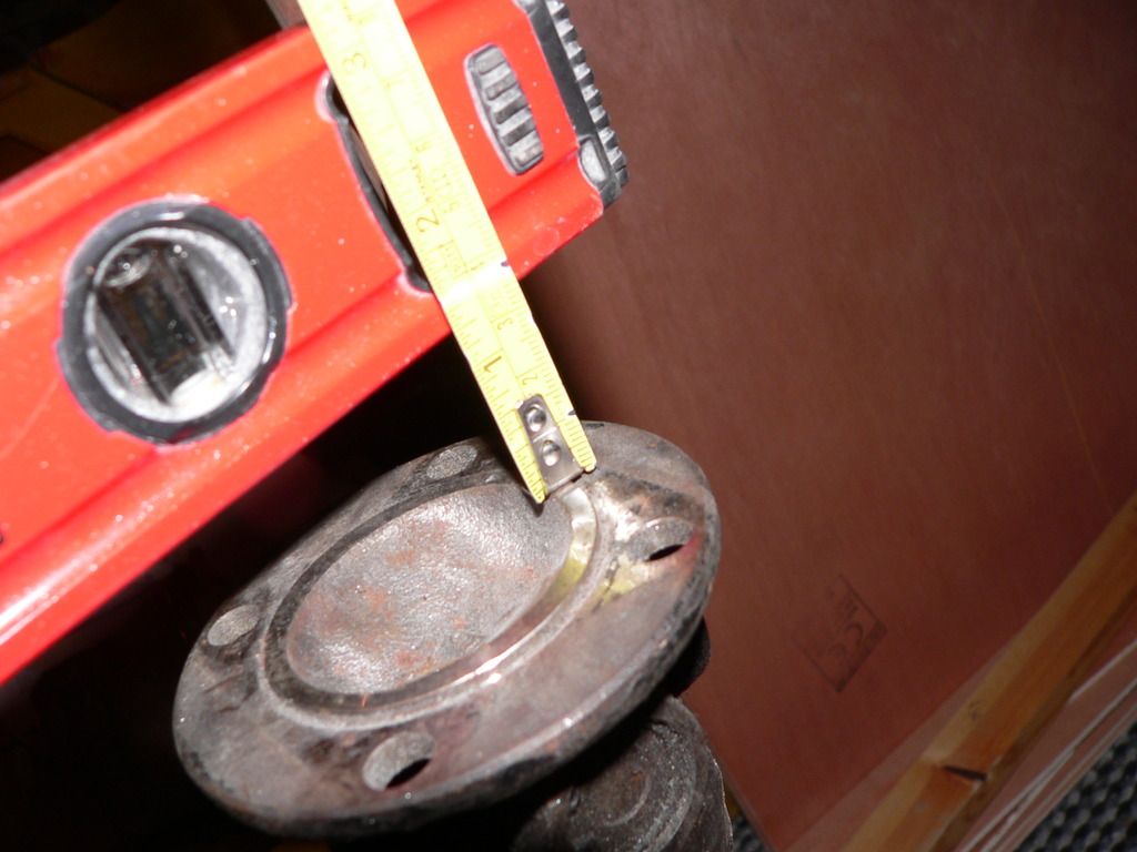

So what do you do when you find out that the chassis / rear axle you are using as a pattern has a 20mm discrepency that has affected wheel placement in the rear arch ..ie. one wheel would sit inboard 20mm more than the other ... ?
You cut the rear of the body off completely and move it over 10mm !!
We have been chasing a discrepency for ages , couldn't work out why the templates and tape measure were fighting each other ...now remedied !!
The front has not moved as its measuring up accurately ...a bit of extra work in the sill and doorshut area , but worth it in the long run ...
Glan put extra bracing on using 3'' x 2'' lengths of wood to ensure nothing moves ..as she is also starting to get quite heavy ...

Gary,you're probably way ahead of me here, but before you start cutting the body have you checked that both drive shafts are the same length?
If you have a Herald shaft one side and a late Spit shaft the other, that would put one wheel about 30mm further out than the other. If you 'correct' the body for that difference then it won't look right with a chassis with equal length shafts.
  #56
Old 8th December 2016, 15:20
Posts: 2,199
CHEERS TOWED ..BUT ITS BEEN CHECKED , DOUBLE CHECKED AND CHECKED AGAIN ...The problem lay with us taking measurements from outriggers that upon closer inspection have been changed ...I have had issues before with this ..should know better really !! All measurements now being taken from main rails etc...
We are within a 2mm difference on the long diagonals at the moment too ..which is pretty good ..

Gary - Good spot and great decision to fix the problem at this stage.
As whilst this is more work for you now, it means less work for the customer later.
Any differences that can be measures in mm is "spot on" in my book.
