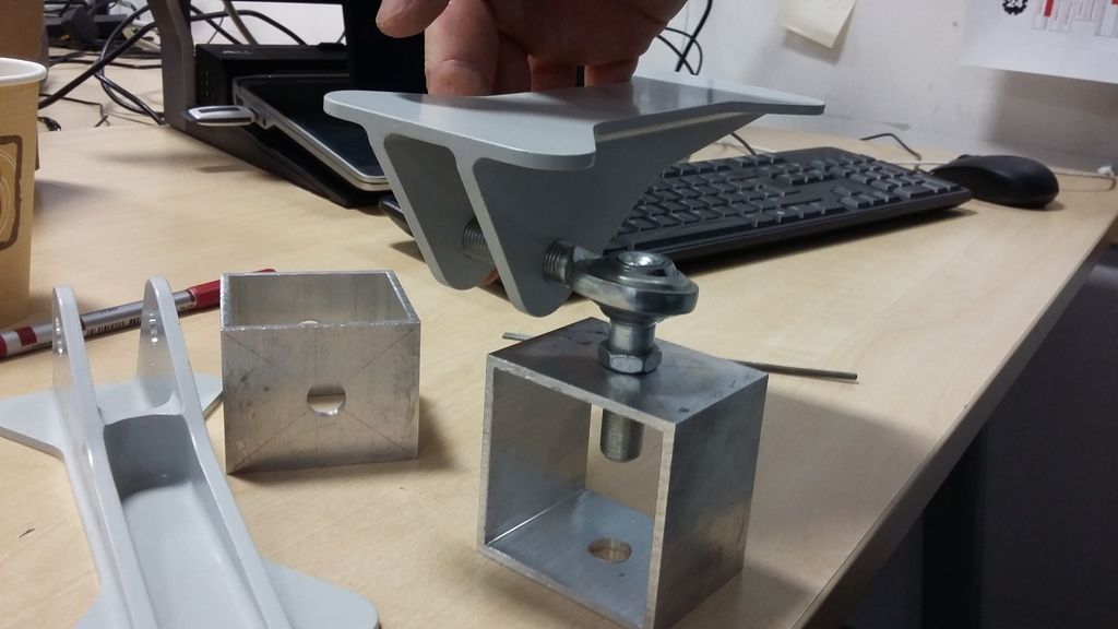

This is my hinge which will go inside the clam. The bits of box section (not in the picture) will be bolted through another piece of plate, through the hardtop then through another bit of plate underneath in a cross shape for a bit of extra rigidity.
that looks like it will be spot on for the job
good work, keep the pics coming

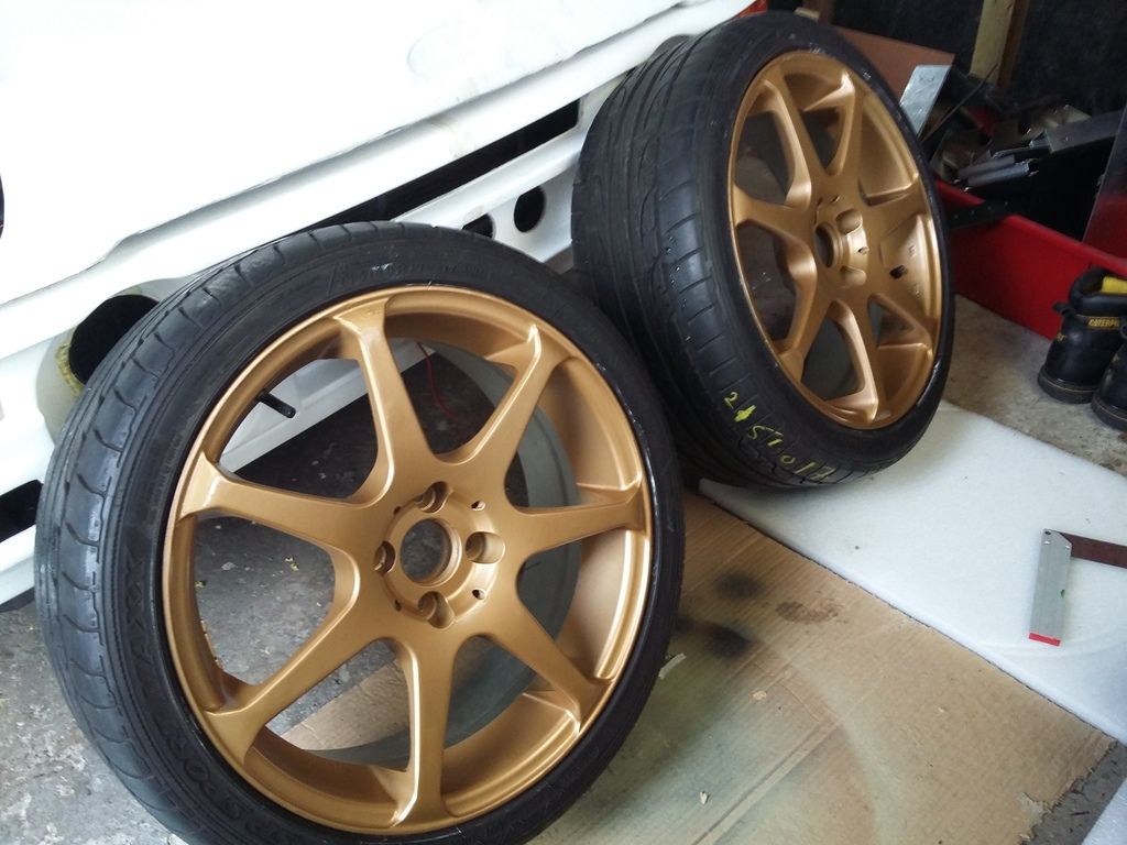

Had a couple of tyres fitted earlier today so that I could get some colour on the wheels. I did it this way round as I was worried about the tyre machine taking the paint off if I'd sprayed them first. The paint won't go mega hard as I'm not able to bake the wheels. Think the wife would be upset if she came home to find a wheel in the oven. Here's where I'm at this evening:
Lacquer tomorrow and I'll hopefully have my spacers by the weekend so I can properly line up the clam.

alloy wheel painting
hi nick , wheels looking good ,what coulor did you decide on, a modern tyre machine and plenty tyre soap shouldn,t go anywere near your wheel rims i had mine fitted to new wheels with polished rims .no problem. the foot that puts the tyre on should stand away from the rim and not contact it , the old way were they use a long bar around a central post will damage them, obviously .

Yeah that's right, but the tyre still has to be stretched over the rim until it pops on. I just didn't want to take any chances as the paint wouldn't be super hard. I got him to fit and balance the wheels, then let the air out and push the tyre off the bead so that I could spray all the way round. The colour is actually halfrauds generic gold enamel paint. A friend's son works there and gets a nice discount otherwise I'd prefer not to set foot in there. The paint gives a really nice finish and at the moment seems to look a bit darker than expected. I'll see tomorrow once the lacquer has dried and the papers off.

The wheels look good

Nick, I really like your choice of colour. I wasn't sure about gold but it looks good and I'm sure they will look great with laquer - looking forward to seeing them on the car.

Cheers chaps, I think they'll look pretty good still no bloody spacers
