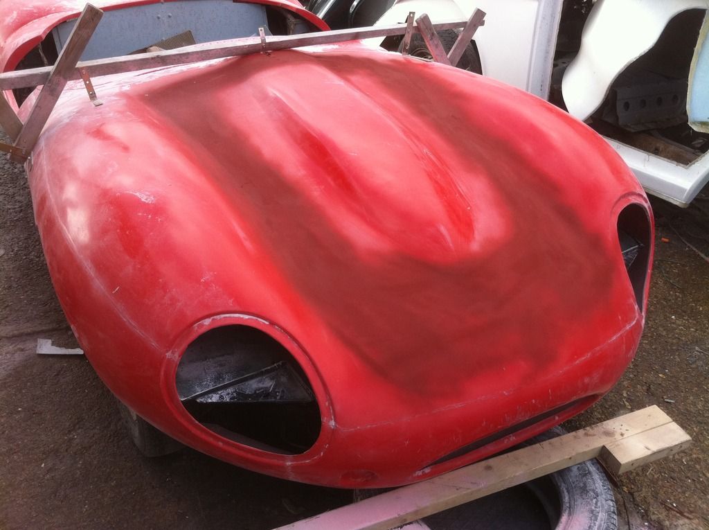

We have been asked to build an A352 with D Type features, reverse engineering if you will, on a Spitfire base for a customer in Denmark. He has already delivered his LHD 1500 Spitfire to Gary's "Mid Century" workshop for conversion to 6 cylinder power and RHD, with the modified body shell following from the Tribute workshop next week.
The body will be changed to a flip front in place of the normal A352 bonnet opening and the large boot lid closed back up to a D Type style spare wheel cover.
Work in progress, with shell fitted to our rather scrappy Spitfire "workshop jig" shell:
The old GRP Spitfire/GT6 bonnet has been canibalised for its inner structure to mount the new flip front to.

Great to see another car progressing, especially a D Type.

Might want to reduce the front spacers in the first pictures though

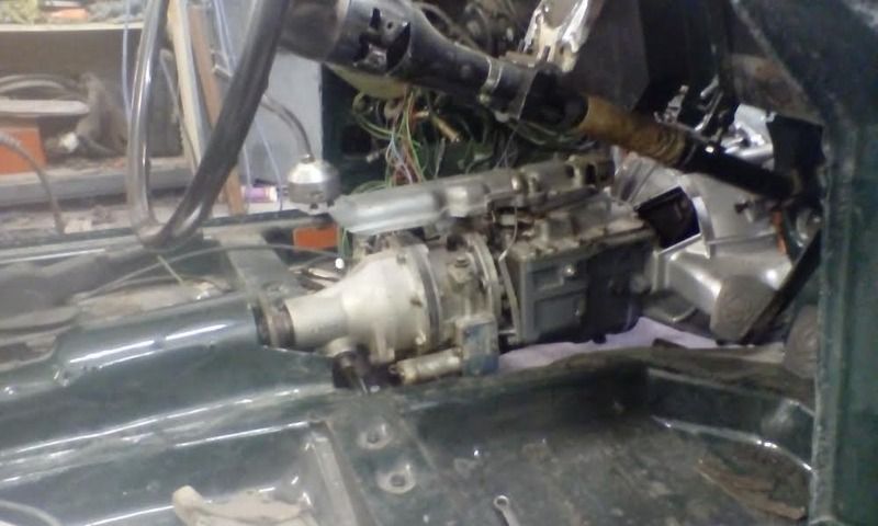

The GT6 engine and gearbox I got earlier in the year from Adam is destined to go in this car ...Its pretty much back together , just a couple of missing parts to locate and a new thrust bearing carrier on its way to replace the damaged one and she should be going in the car ...

Bonnet and boot lids bonded in, glassed from both sides and filled

It will have a removable rigid cover over the passenger area that will incorporate the central cockpit divider. Rather than the classic D Type rear "wing" it will have a head fairing with fuel filler accessed via a flap.
The car will be painted green I believe, once it gets back to Denmark.

Body looks very good Chris , I am looking forward to seeing it finished ...
I think this car has the potential to be a very pretty little Special ....The D type styling is gorgeous and so very much 'of that period'

Bit of progress today ....Engine and gearbox in , slight mod on the gearbox mount , bit of bulkhead and floor trimming to clear the starter motor and overdrive unit and she's in place !
Plumbing and wiring underway ....

Returns added to scuttle area:
Just the front section to bond to its inner frame and then off it goes to be built up on the donor Spitfire.
