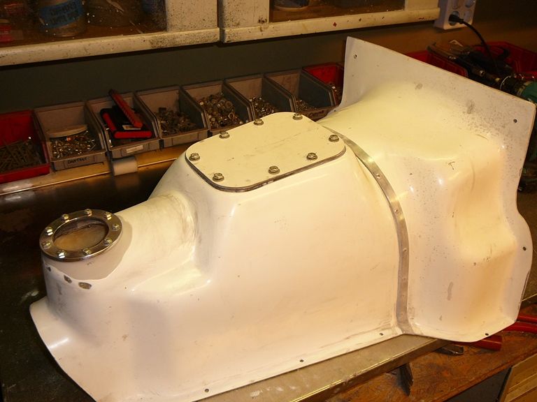

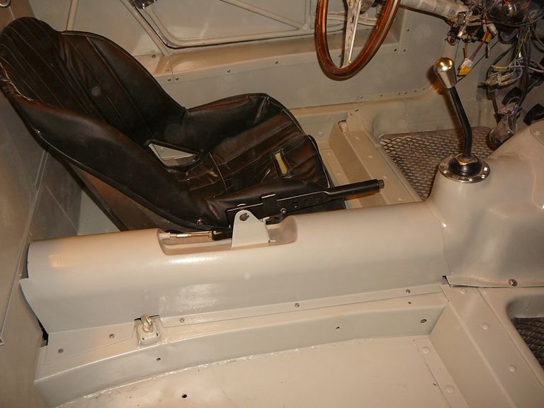

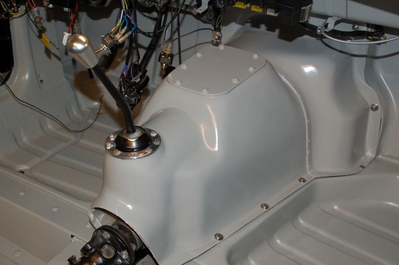

Today I got the prop shaft tunnel finished and got the hand brake working. Together wirh the transmission cover, it forms the backbone of the interior so to say.
I bought a grp tansmission cover. I decided to pimp it. How much I like a good coin tray, I don't think it suits a 50's racing car very much. The coin tray had to go. I covered it up with a plate and used plenty of small bolts to fix it. It looks more like an inspection panel now.
For the surround of the gear lever I did something similar. I used an alu ring that came with my steering wheel. I bonded it to the cover. Then I crossed an alu strip over the cover to visually break it's proportion somewhat.
[IMG][/IMG]
[IMG][/IMG]

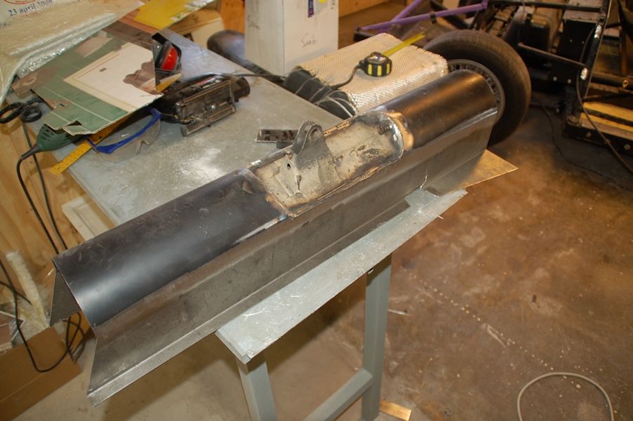

For the tunnel over the prop shaft, I bought a 2mm thick heat stove pipe, which I cut in two. I cut out the piece in the original tunnel that had the hand brake mountings on it. I cut a hole in the pipe and welded the piece in. For the sides of the tunnel I had a metal strip angled 90 degrees. I welded them to the pipe as well.
[IMG][/IMG]
[IMG][/IMG]\
I still have to finish the gaps and connections here and there.

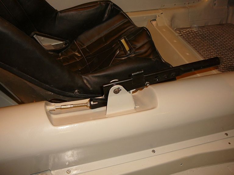

[IMG][/IMG]
It doesn't show very well on this photo, but I have drilled a few holes into the brake lever which look rather well if I may say so. And perhaps more important, I got it working!
[IMG][/IMG]

That's looking very impressive Michiel.
I do like your seat shell with loose cover, do you have another one for the passenger side, or will you go with the racing car style of a non-matching basic cushion on the floor for the mechanic to perch on?

Michiel - Your gearbox cover is a real work of art.
I'd be happy if my own cover looked half as good when I have finished with it.

Michiel ..... that is FANTASTIC ! a great idea to copy
Seating looks soooooo retro.
Keep it up

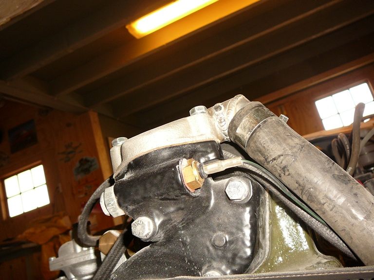

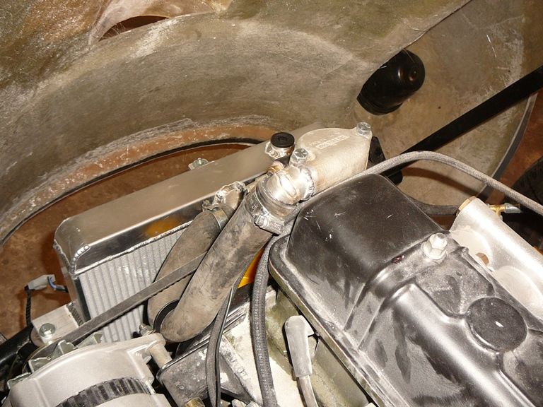

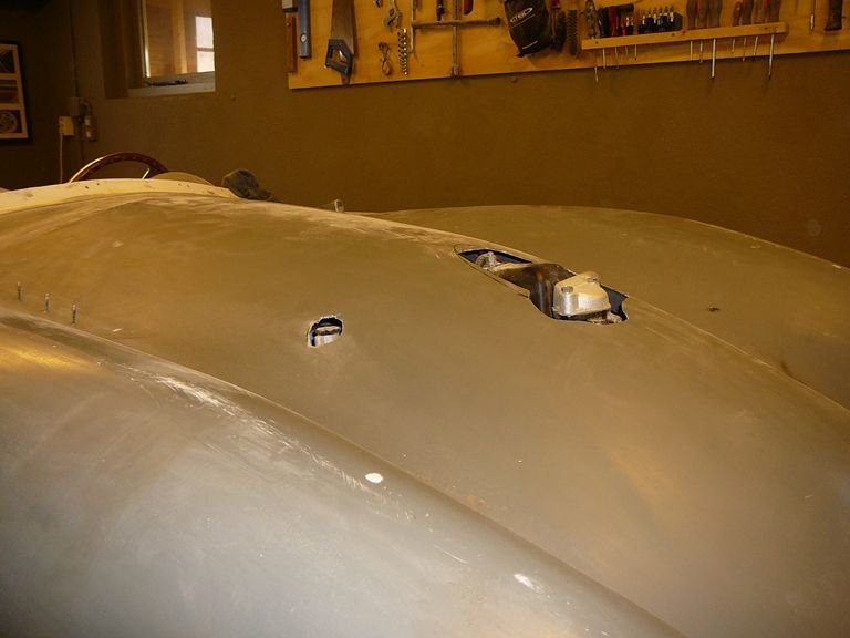

Since I reached the stage of placing the bonnet, I had a problem with pieces of engine sticking out of it and a radiator beeing pushed down to street level.
[IMG][/IMG]
Off course, this means scoops. The shape of the thermostat housing and the hose coming out of it, directs a pretty wide scoop. As seen before with manny Spyders. I wanted a more narrow scoop and this ment that I had to change the thermostat housing.
[IMG][/IMG]

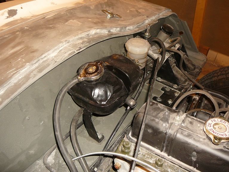

As fot the radiator, I decided to have one made according to my own specs. I want a system with an expansion tank, a filler screw, connecting pipes at the right place, correct mounting, hight, with, sensor for the electric fan, sufficient colling capacity, correct mountng for the electric fan I have. Well, there was no way a stock radiator would meet all these needs.
[IMG][/IMG]

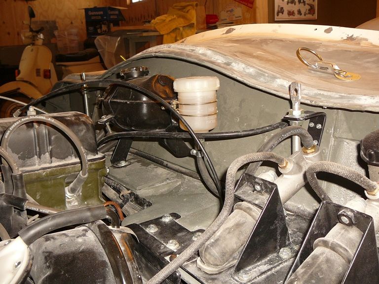

Also I had the expansion tank changed. One pipe outlet was plugged and one pipe at the under side was changed in shape and diameter.
[IMG][/IMG]
As you can see here, I used the bracket for the expansion tank to mount the remote reservoir for the master brake cilinder as well.
[IMG][/IMG]

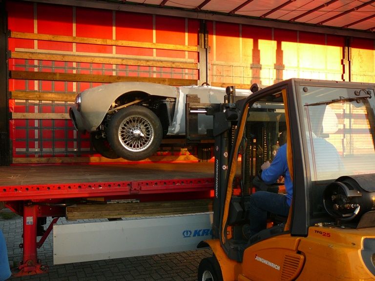

Michiel - I bet you were nervous when your car was lifted up on the forklift!

@Paul, I made a wooden frame. That way a fork lift won't damage the underside of the car. This worked well. Still, nothing beats solid ground

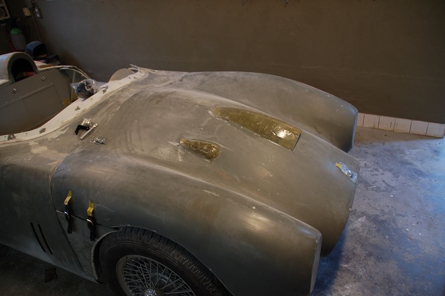

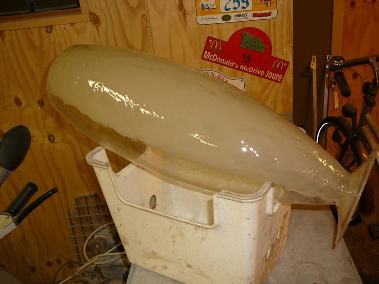

Now that my thermostat housing is changed, I could look out for a narrow scoop. After searching for shapes that I could use for the building of the scoop (or bulge). I found a vase that I thought, had a nice shape.
After waxing, I gave it a gelcoat.
[IMG][/IMG]
After this I laminated it, to make a mould. With this mould I made the final scoop.

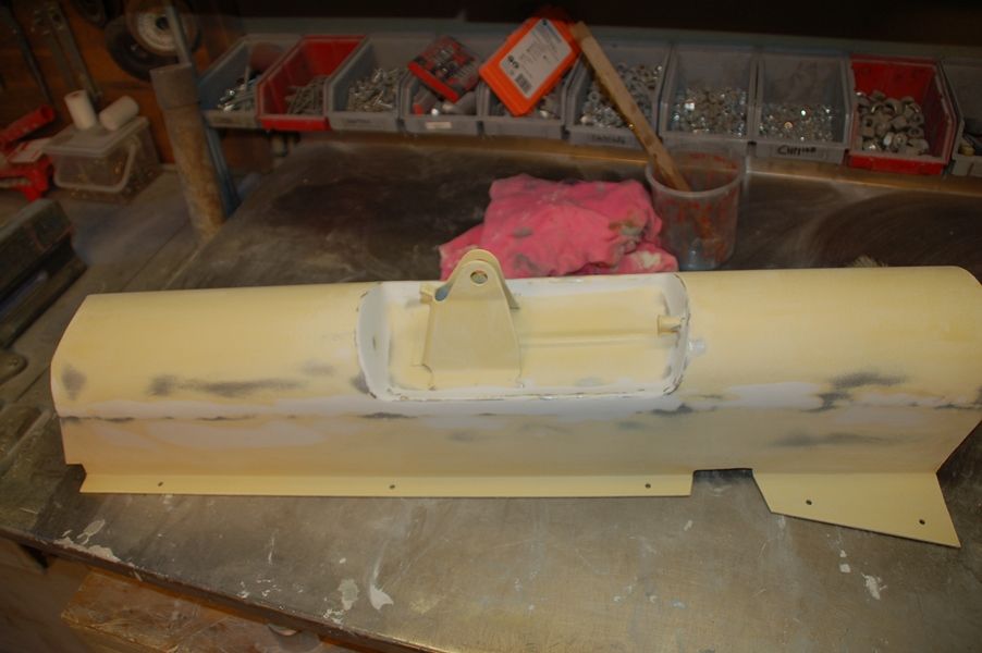

For the little scoop/bulge that was needed to cover the above of the first carburettor, I used a plastic gardening shuffle.
It all lead to this:
[IMG][/IMG]
I also made a mould that has the shape of a sfere. With the scoop and the sfere, I can make a bulge. After some consideration, I choose for the scoop and not for a bulge. A bulge would change the shape of the bonnet beeing more of an integral part. A scoop is more laying on top of the bonnet leaving the bonnet shape as is.

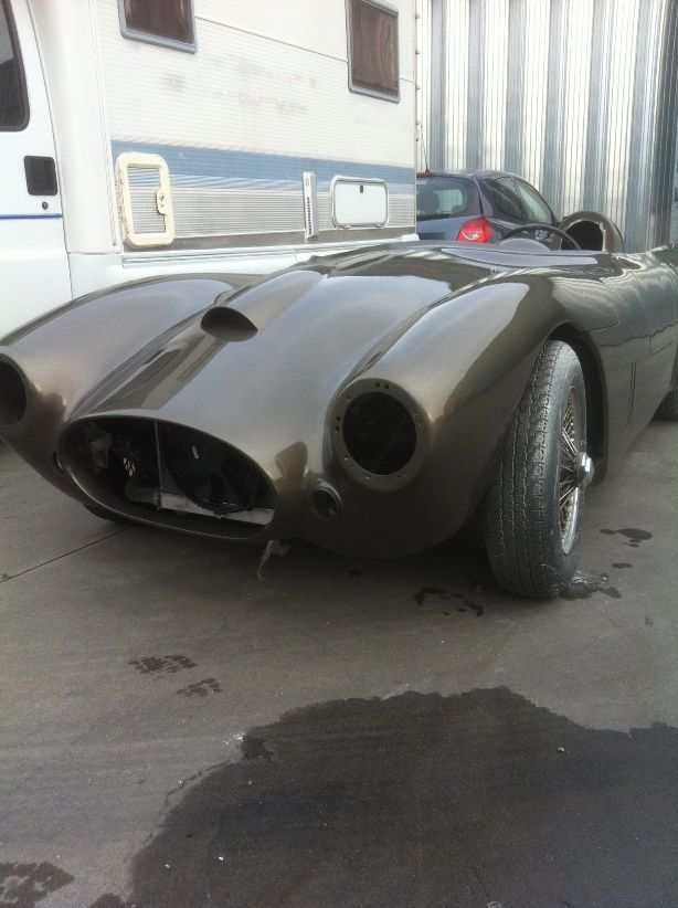

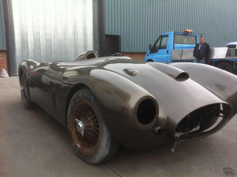

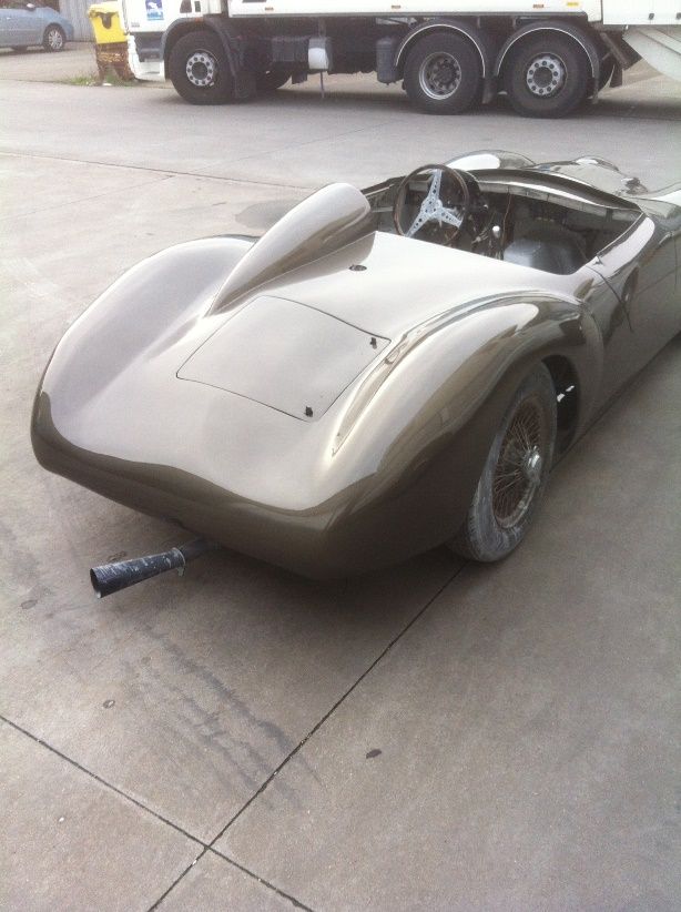

Finally I have some progress to report. And what progress it is! I received pictures out of Poole, where Mike and his co-workers (from Miglia sportscars) have prepped and sprayed my car. I live in Holland, but I wanted a quality GRP paint job and figured that I should take the car to the other side again for that. It was more then a regular sprying job. Mike did loads of work, correcting all my work where necessary to get it top notch. And for a fair price I would say. Thank you Mike.
I changed my mind on the colour many times, before we came to: Jaguar Bronze metallic. A beautiful 50's colour. Totally different from all the colours I have seen on our kits before. Now it looks distighuished, but wait how it looks with the leather and the panamericana stickering I have planned.
What do you say?
[IMG][/IMG]
[IMG][/IMG]
[IMG][/IMG]

Yes ...now that works!!!!,
Great choice
