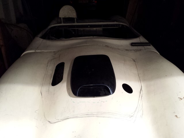

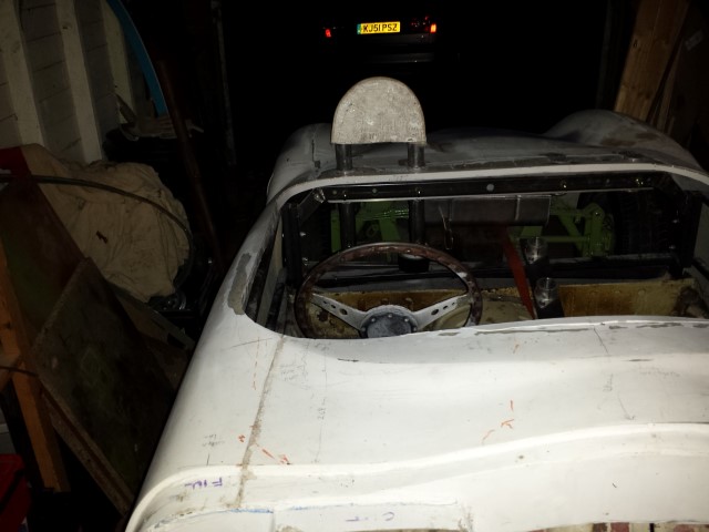

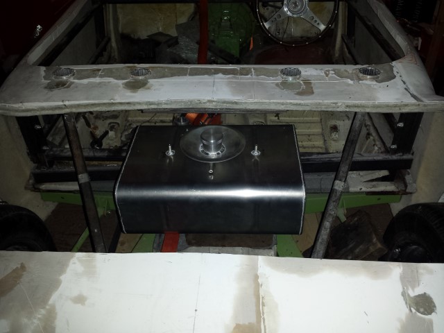

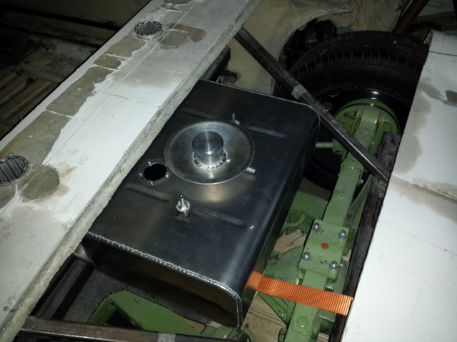

Not much to show of late, but plenty of beard scratching and planning.
I did take delivery of the world's dinkiest petrol tank today.
It's only 4.5 gallons but it will be enough for plenty of fun.
Then I played around with increased hump heights........
And finally couldn't resist trying my D24-like bonnet intake.
I hope to get some proper work time at the weekend.

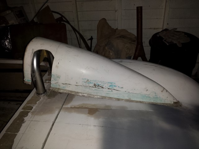

Oh, and I forgot to mention. The solution to stop the rear clam fouling on the exhausts.......side exits. I'll make you proud Mr T, I promise.

Like the scoop, should look factory finished rather than my modded in the pits effort.

Looking forward to seeing the side exit exhausts come together.

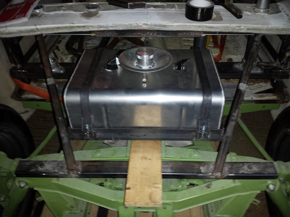

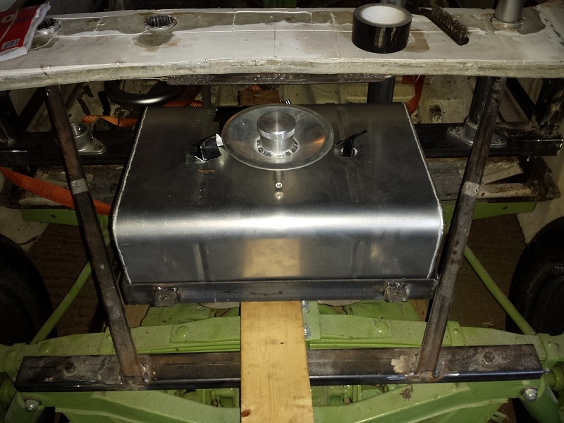

It is so frustrating not having as much time as I would like to work on the car, but I have to remind myself of the Sammio mantra - all progress is good progress.
I knew I would have only a couple of hours so I made the fuel tank holder. I shall make the straps this week.
I have some 5mm fuel-resistant nitrile rubber sheet on order to act as a cushion.
The piece of wood is not structural! It's just to get the height roughly right.

Nice bracket, even nicer tank!

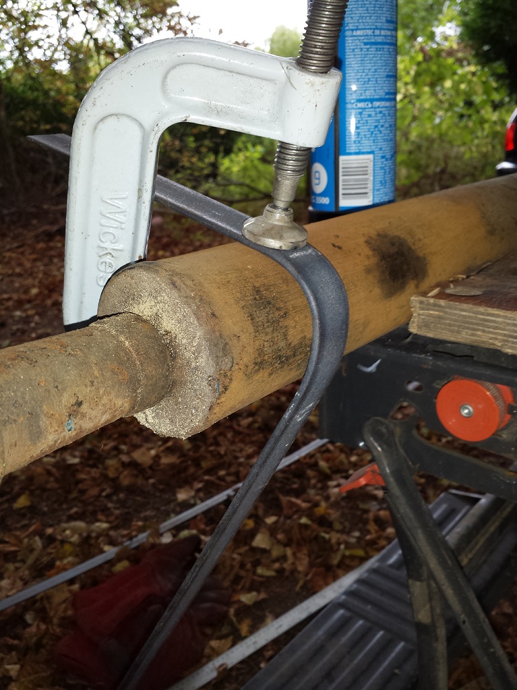

Default Today I was a blacksmith

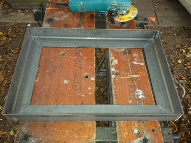

A client cancelled a meeting today which mucked-up my day so I dodged down to The Glade at 3.

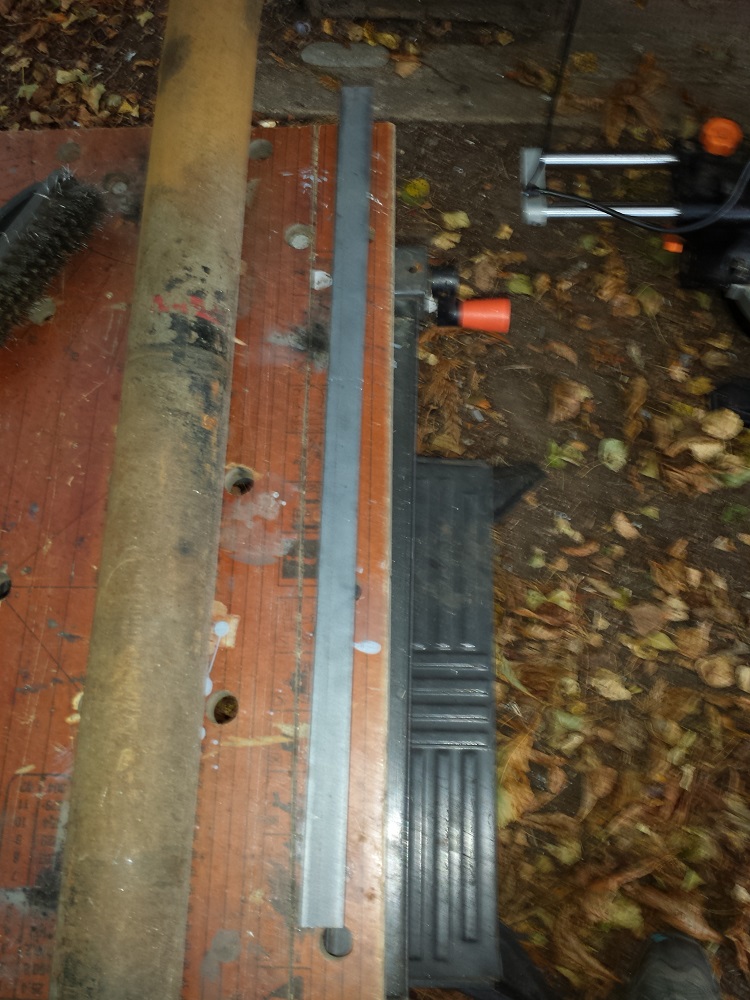

I cut a couple of 60cm lengths of 25mm strap.
Heated them with a blow torch and bent them around an old prop shaft.
Hammered the end brackets and welded in some strengtheners and, bingo, two near-identical straps.
As I mentioned before, I have 5mm nitrile sheet to prevent steel on aly, and I will tidy the welds.

Neat work Oxford on those tank straps and i like your train of thought using the old prop shaft as a template, this car is going to look great.

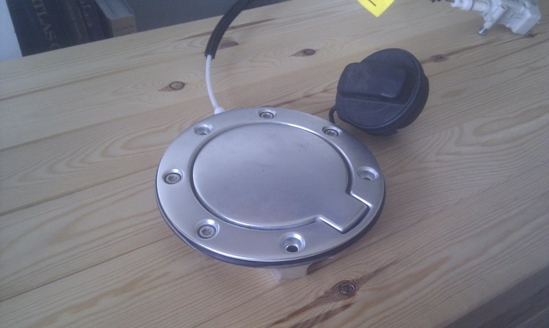

Well, funny you should say that.......
I have a rather nice alloy flip up that I might (I stress "might") recess above the splash bowl so that I can fill-up without raising the back.
I do love Monza/Aston style fillers so I may have one as a dummy........(which I am slightly embarrassed about, but it is my build).
Would be interested in anyone's views as to whether this will look period or whether it just shouts Audi TT.
My gut feeling is that I will regret it if I use it, and I would be crushed if somebody came up and said, "That's off an Audi."
  #479
Old 26th September 2014, 14:24
Too modern, i agree with you. Put it on ebay.
