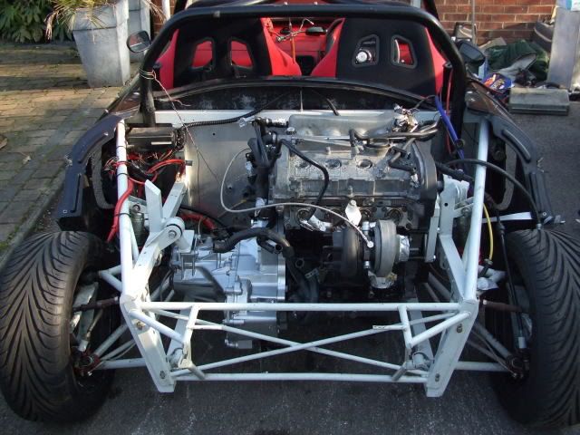

This is sad I know. But any chance of some engine bay pictures? Love looking at engine bays.

Any yes piccies of the engine bay also needed

Apologies for the rather long reply, I shall try to find some engine bay pics- although they aren't that impressive as my engine is 1.8 non-turbo
