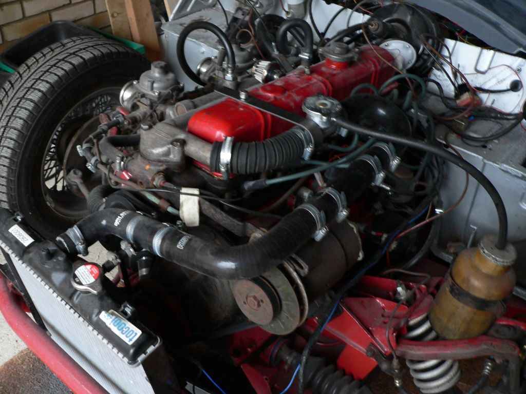

Not sure if you can clearly see how I set mine up in this picture -
As Andy says, I've just got a filler neck in line in the top hose from the 'stat housing, which then returns through 180 degrees almost immediately to run back to the radiator top connection.

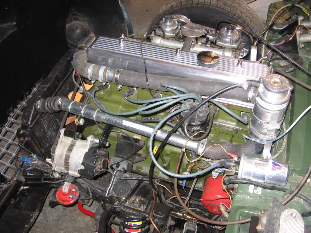

If I did another I'd probably use the very elegant solution adopted by Phil J on his builds -
Not the best angle to see what he's done, but the header tank is the small alloy pot immediately behind and just on the far side of the rocker cover. Nice.

Here we go, found a better pictures of mine, but I have to say I actually prefer Phil J's set up -

Apologies for hijacking your post Blooka......Mister Towed the first picture has an alloy rad while the second has what looks to be a standard rad was there a problem fitting the alloy rad?
Old 8th April 2014, 20:48
Posts: 4,921
Swifty - I can answer that one for you...
Post #7
- First photo is of Mr T's alloy radiator
- Second photo is of a different car (Phil's) with a different radiator & an nice expansion tank.
I think the only problem Mr T had with the alloy radiator was when he accidently knocked a hole in it and had to buy another one.
