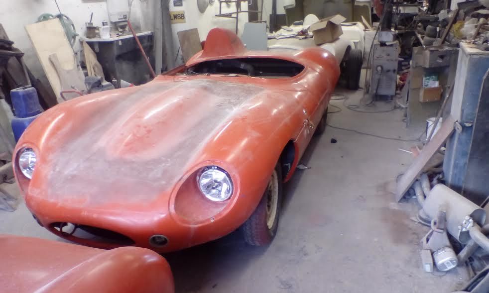

Bit more done on Friday / Saturday ...
internal bulkheads were glassed into the boot area ....always interesting glassing panels in an area you can just about get your head and one arm into and just about reach the panel !! But a massive improvement on rigidity on the rear , so worth it !
rear light units , boot hinges and D type style latch and handle fitted too ...
headlight buckets were bonded and glassed into place , holes cut and buckets fitted ...hopefully got a plan for front indicators tomorrow ..

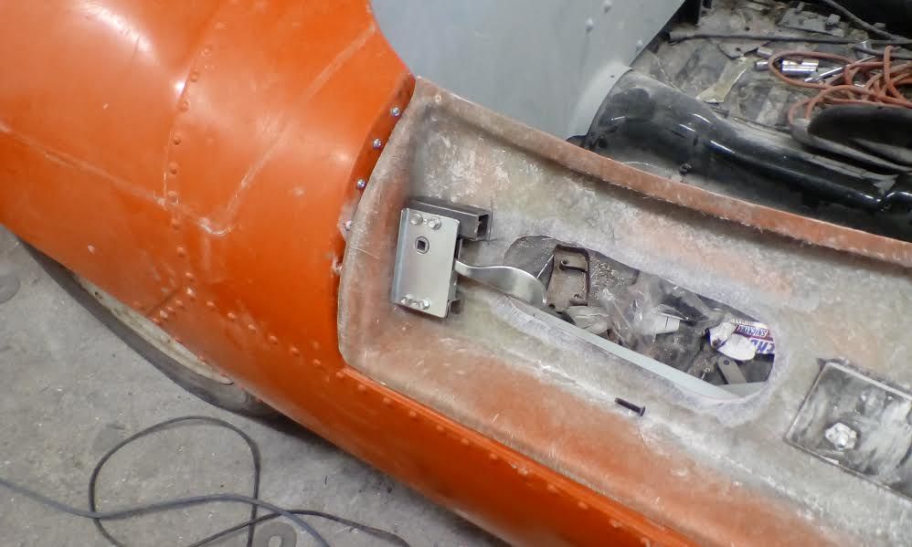

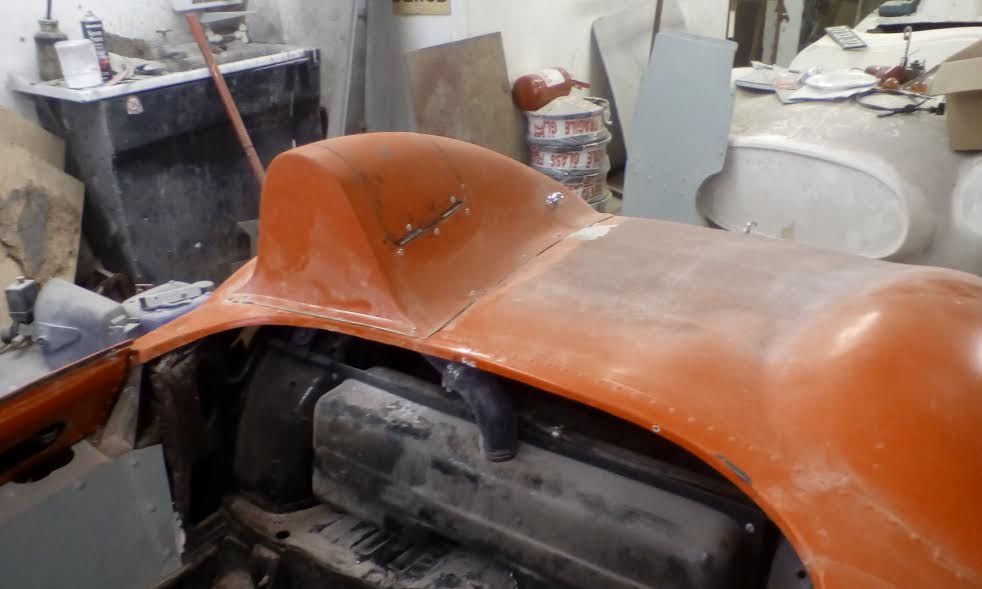

A non tailfinned headrest has been fitted , Chris has developed this panel to adorn both the 352's and the D type bodies ..this is the first one and they are a nice job ..the curve is just right for that D type styling ...they sit higher than a Sammio one and look very tall without the screen in place but they are very cool with the petrol flap and hidden fuel cap system .
I have bonded it on and will be adding some rivet detail when its glued firmly ...I have hinged and latched the flap using standard butt hinges fitted to aluminium angle shelves rivetted through the headrest and bonded in place too ...The latch is a standard quarter turn Herald boot handle type and will be opened with a square drive Church key T handle through the hole on the side ...The original D type simply has a hole here you push a spring clip through with your finger to release the flap ..but we felt a lock was better !!

Gary - Lots of nice details going into this build.
I assume you re-routed the fuel line before the hump was bonded into place?
  #31
Old 25th September 2016, 13:14
Posts: 2,199
Yes Paul , I did .... before the hump was bonded on , 2 large holes big enough to get your hand through were cut ...not sure of the size but the biggest hole saws I had , so about 6'' at a guess ...the front hole allows access to the bottom of the stock Spitfire filler cap , the rear hole allows access to the roundall light to change the bulb or get to the wiring and fixings .
A trip to Hypehose got me two large 90 degree bends that when suitable cut and sleeved with a stainless steel insert , gave me a continual rubber filler hose from filler cap to tank . All accessible when interior in as I intend to change the way the rear cockpit panel fits so it can be removed easily when cockpit sides are in place properly .

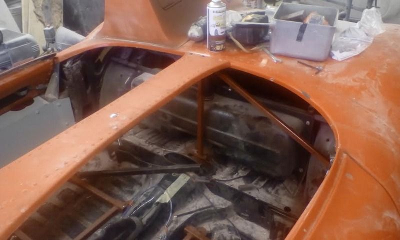

A bit more progress this week ....
I made a start on the seat bases ...Landrover swabs are being used ...
Then whilst the welder was out , I made a start on the removable centrebar and tonneau.. Chris supplied a D type centre bar , which with about 10mm trimmed from the rear , fitted very nicely ..
A 20mm box frame was made to span the area and sits on a small shelf at the rear attached to a 20mm box brace secured to the body and the floor and across to the B pillar too ..
At the front 2 little shelfs poke out from the dash about an inch and are beaced back to the Spits original bulkhead ...nice and strong as people will push on it to get in and out ...
Centre bar is bolted using 6mm domed bolts to resemble rivets through into the shelves and will be bonded to the internal frame when finished ...
The compound curved sheet of fibreglass Chris supplied has been roughly trimmed to size but thats as far as I got .... it will be fitted seperately , so we have full tonneau , centre bar only or fully open cockpit options ...

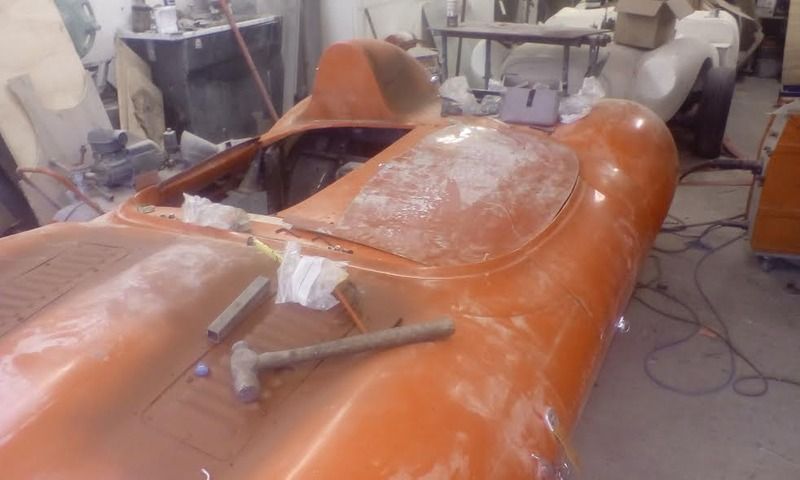

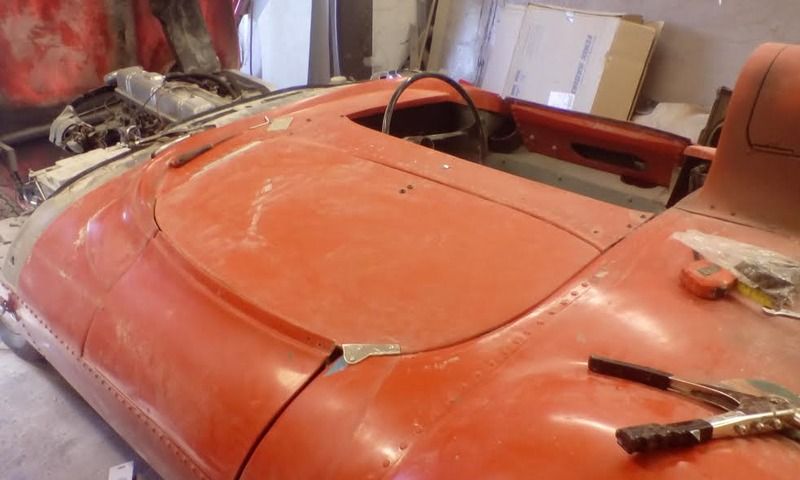

Still fighting the tonneau cover ....
The complex curves of the bodyshell are quite challenging when it comes to making a tonneau look fitted rather than 'screwed on'
Chris supplied me a nice bit of fibreglass that had the double curve thing going on but it still needed work to fit ...
I cut a piece roughly to shape and fixed some 2'' flatstrip around the cockpit perimeter and put the tonneau in place ...by opening the pass. door I could reach in and tag the pieces together with small strips , just enough to hold it all together ....I then removed it and fully glassed it ....lots of gapping up and tweaking later and it is starting to take shape ....
The tonneau is held in place with a pin through a bracket on the bottom of the centre bar and a small ally bracket on the rear , just behind the pass. door , which will be rivetted in place eventually and screwed to the body using a rubber thread sert fixing .. Another fitting will be near the dash but I'm not doing that until I tackle the screen and mirror fixings ...
Lots more filling to do to get it nice ... I might talk to Chris about allowing me to take a mould from it so that I can produce a lighter version for the final fit ..
