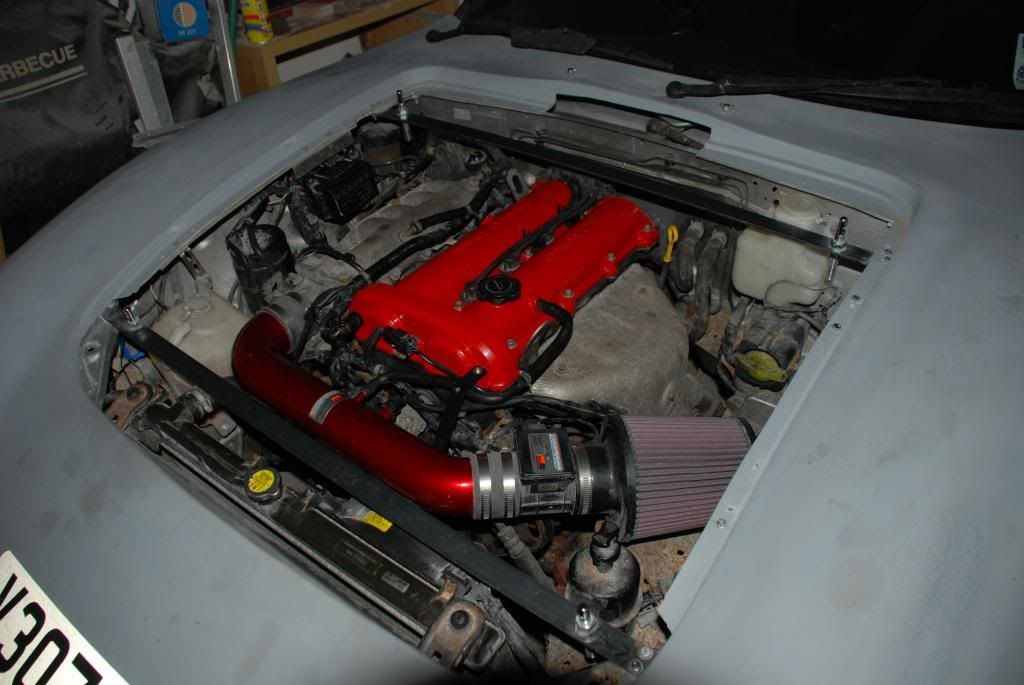

Mk2 builders. How have you relocated your fuse box out of the way? My Fuse box is in 2 parts the main fuse box and then a smaller secondary fusebox on a bracket (see photos). But the area is so cluttered between the brake fluid reservoir and the fuel can thingy, and the wire does not have enough overlength that I can't seem to move it far enough to clear the wing extension. any ideas?

This doesn't show my solution very well but it's on bracket mounted to the wing extenders. I'll try and get some better pictures at the weekend when there is some sunshine.

Thank-you, that will help a lot. Have you separated the large fuse box from the smaller one behind, or are they still together on the same bracket? Did you have to do anything with the wire, as I have very little movement at present?

When you say the small fuse box do you mean the relays on the gold coloured mount? I left these where they were. It's a PitA to get to them if they fail but as I had to replace all three during my build I would hope they will last a while.
In terms of the wiring, I "gently" pulled the main fuse box until there was enough length to mount it where I wanted. There isn't a great deal of spare length on the wiring but with some gentle teasing it does come further out.
  #20

Hi Fatbloke. I had a go at the fusebox again tonight. I took the 3 connectors and gold bracket off and I was able to get to the wiring loom underneath. I separated the two main strands a little where they are taped and re-taped them. This gave me quite a bit more flex. I re-installed the 3 connectors. on your vehicle it looks like you've taken the other gold bracket out near the fuel can? For now, I've also twisted the front part that holds the fuel pipes through 45 degrees which brings the black connector away from the strut top to give more space. I also reversed the grey connector and the small black hitatchi box through 180 degrees which also brings that wiring out of the way. So at least the fuse box can be brought far enough out of the way for now, but may need to tweak later.
