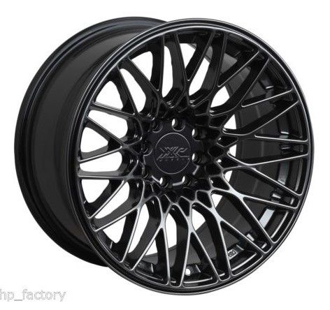

Hi, Looking for ideas and suggestions on wheels.
To start discussion, I quite like these from XXR (553). However, they are quite wide and not sure they will fit in the front wheel arch?
If I calculate correctly , they will protrude 81mm from the hub (8" = 203/2 mm - 21mm offset = 81mm) and most other builds are around 70mm. So is it too much?
Should I go 15" or 16"? I think 16" will look better but am worried about a harsh ride as I have lowered the car.
At the rear I calculate I would still need a 45mm spacer.
Or what else could you suggest? Are there any good designs with staggered offsets?

I think the wheels you have picked look too modern and that the concave wheel in general is a bit of a fad right now.
Gotta be retro. There's always the usual BBS crosspokes most of us have gone for.
Be prepared that when you take your car to shows, most people will be telling you that you should be on wire wheels

The above wheel is rota bm8

I'm on 15x9 et10 rear and 15x8 et10 front
