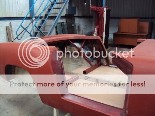

I can now start on making the metal framework to sit inside the body. This will give extra strength as well as anchor points for seat belts etc. I can see this as being a rather frustrating task, mainly because I'm fitting it in whilst its upside down and with no floor in. Doing it this way allows me to make pre welded sections and insert them into place easier and keeps inside the car welding to a minimum. Overhead welding in awkward places is not my strong point. Old age and failing eye sight doesn't help either

Nope I'm still chipping away at it, I've finely got the frame work in after much shouting and cursing. I learned a valuable lesson when welding...BEWARE of distortion.
After lots of time cutting, tacking, remeasuring and then checking it all over again it fitted like a glove. Next out with the 3 main sections and sitting them on the floor I proceeded to weld all the joints. Now the fun bit assemble them on the floor and admire your handy work. ???? @%&£&... That doesn't look right!!
Arrggg, yep distortion, I should have made some sort of jig...yeah i know this now... So out with the tape measure and hacksaw the worst joints reposition and start again. Only this time with a crude jig, this involved lengths of 3 x 2, scaffold poles and lots of weight to keeps things still.
It worked, so back in the shell and lets get the floor in. I've been making a few bit as well, to replace the originals. Like the door hinge which I modified too include nuts so I can adjust the doors.
BIG moment for me, (with some help) I turned the body shell right way up and placed it on a trolly. This will help a great deal with future work on the body.
Next job is to fit the body to the chassis well line it up etc, so i can cut out the infilled arches Then the trans tunnel, do a bit more welding, then.........
