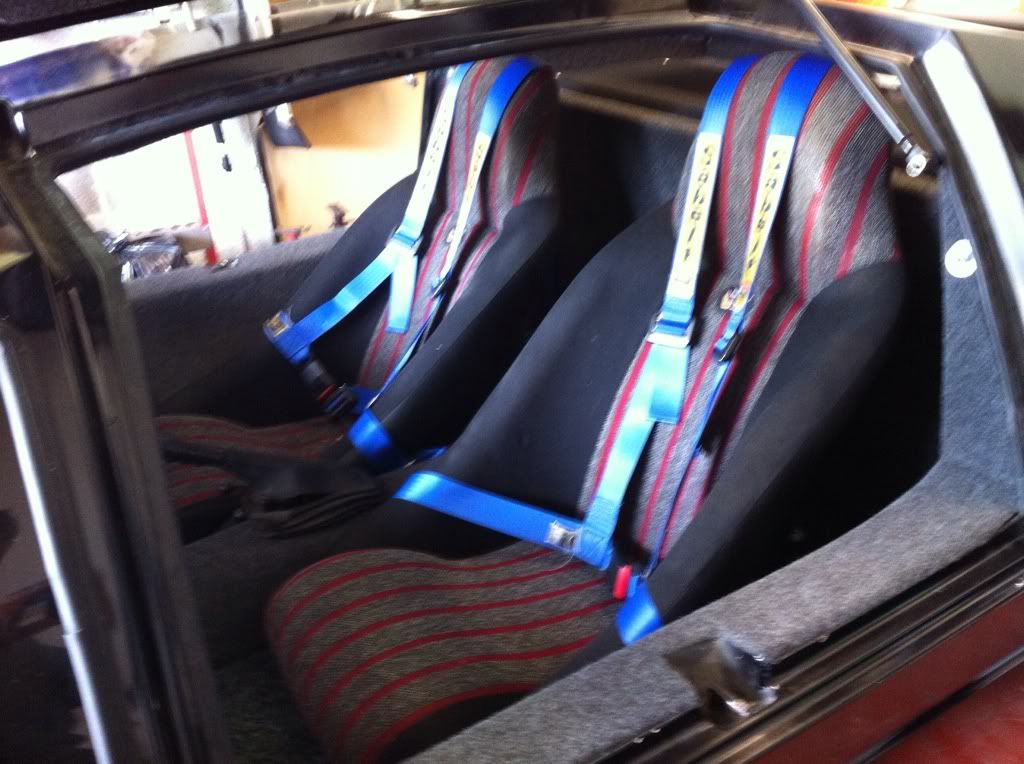

now got a pair of sabelt harnesses in, so we now have a blue 3 point sparco harness for sale.
all it needs for MOT now is new master cylinder for brakes as piston is shot and the mirrors bolting on.
