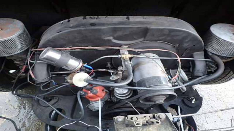

I'm new here and new although not new to classic cars earlier in the year I became new to kit cars as I became the owner of a Chesil Speedster replica which was in a bit of a sorry state.
I'm not sure exactly when it was built but she's been slowly undergoing a light restoration as and when time permits.
I actually bought Y.. Oh Y.. Oh Y.. (As she's affectionately known) from a salvage yard, after it had suffered from an electrical fire, more on that later though.
As she was delivered in all her dirty gloriness..
Right old tangled mess in here.

So i do wonder if the previous owner was suprised that the wiring caught fire!
So there was nothing else for it but to rip it all out...
And start from scratch..

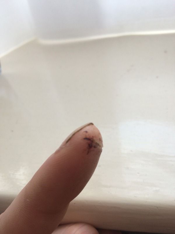

Oh and last note... PPE people!!!! not saying a glove would of stopped this but I don't think the damage would of been as bad. Not like me as we get bollock'd in work if caught without it but it only takes a split second.
Its nearly right through the tip of my finger but it could of been a lot worse.

Bizarrely, there was no pain and no blood. My other half a burns specialist at a children's hospital and it never goes down well when she comes home and I'm covered in cuts and burns lol
