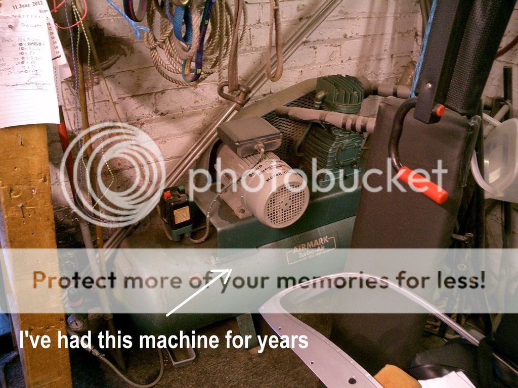

Can you post up some pictures of your spraying equipment and set up please. That is not too shoddy and I am getting more tempted to get mine resprayed.

WCA, I have posted a couple of pics of my compressor and spray gun for you to see.

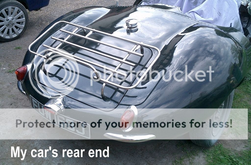

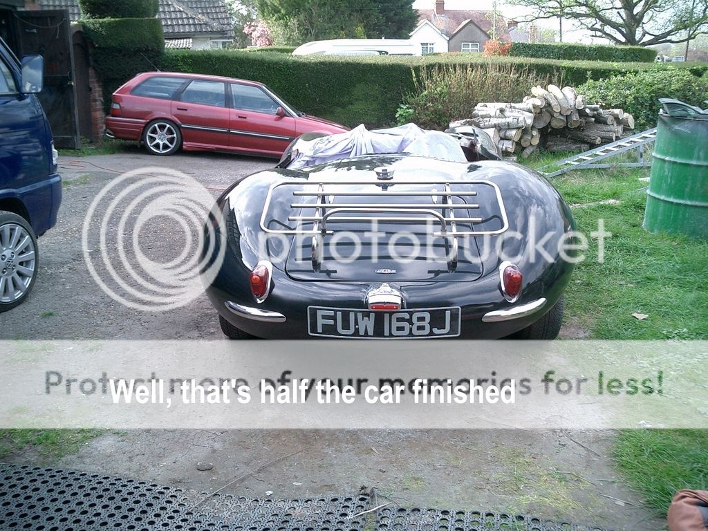

Today I rubbed down the one run I had on the bonnet, and also some more bonnet patches, but mainly I worked on the back half of the car.
I rubbed it down with G3, then T cut, as there were a few slight orange peely bits. It now does not have that "just painted" look, and almost looks like it could be the original 1950's paint. I have not polished it yet, that will come later.
The back half of the car is now finished, it is not perfect and there are a few small marks, and insect imprints etc. But you'd have to look hard to see them, and I can live with that. The overall impression is okay.
So I put all the lights and bumpers back on, and was pleased with the result.
The main difference between my car's rear and a real one, is around three million quid...........
So its just the front half now........

Well, it looks real!

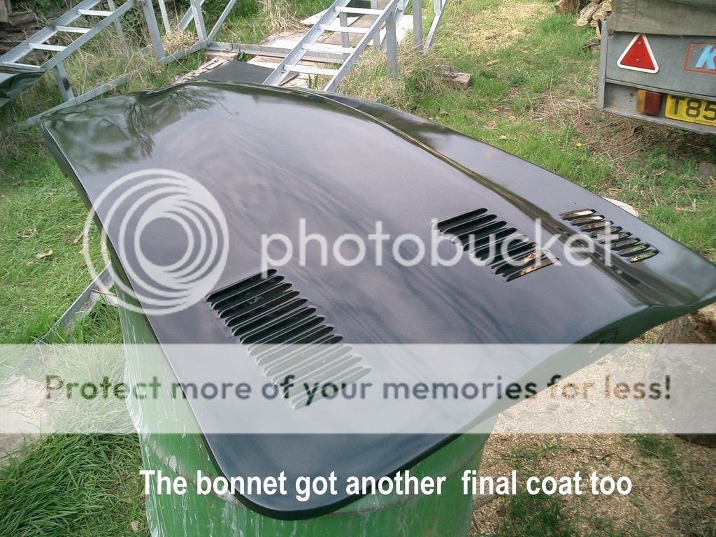

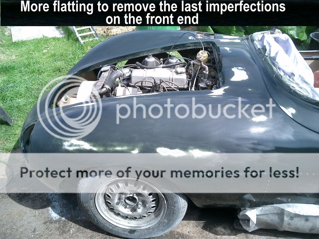

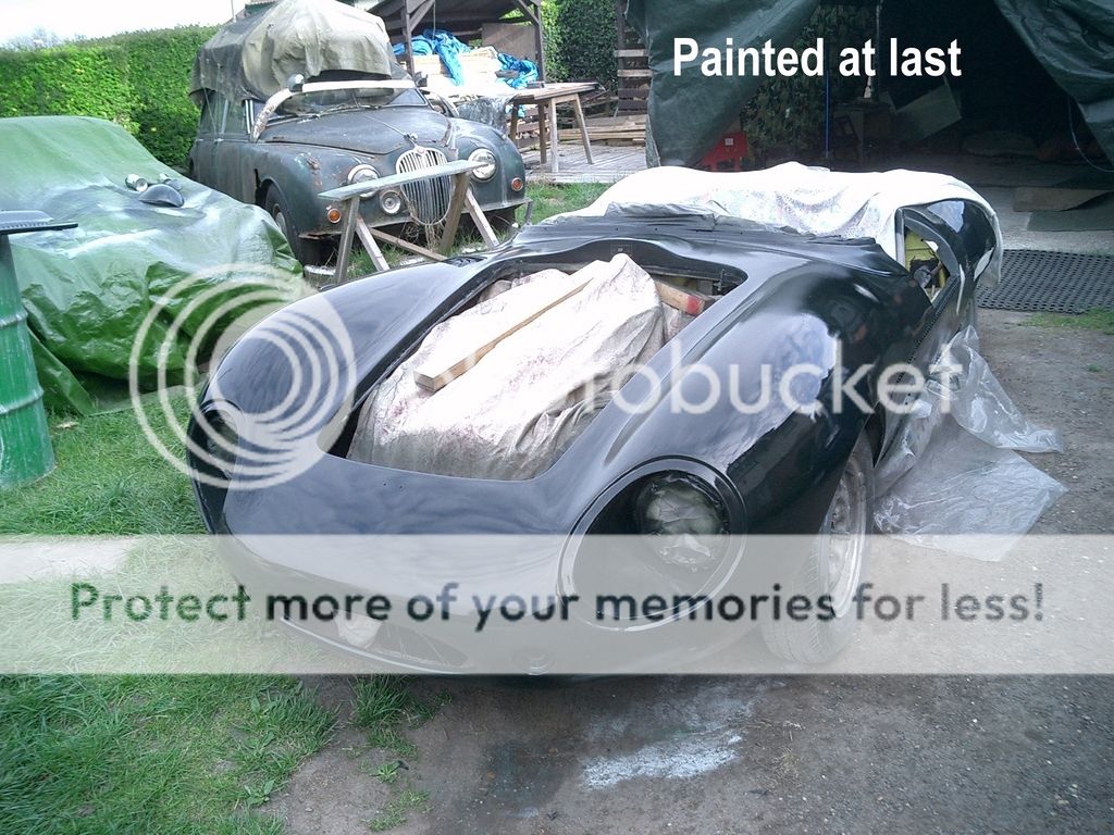

Today was another prep day, working on the front half of the car which was not up to standard. It is now, and its painted, so are the doors and bonnet with yet another coat.
It could not have been a fluke the first time round, as its come out even better this time, it must be the paint!
I will always use this stuff for everything in the future.
One thing I have learnt over the last few days, is that it is fairly straight forward and simple to spray paint, but incredibly difficult to get a smooth even surface on a panel to receive that paint.

[IMG] [/IMG]
[IMG] [/IMG]
[IMG] [/IMG
[IMG] [/IMG

...One thing I have learnt over the last few days, is that it is fairly straight forward and simple to spray paint, but incredibly difficult to get a smooth even surface on a panel to receive that paint...
It certainly looks like you have created a smooth surface.
So I will try hard to follow your lead when I finally get to that stage.
This might sound like a daft question, but have you "just" got the panels smooth, or have you also "straightened" out the panels too?
As I think I may end up a smooth, but undulating, surface in some areas.
18th April 2015, 08:45
Location: Sunny Cumbria
Posts: 470
Paul, you can tell by looking at the reflections. To me the reflections of the surroundings and particularly the houses and the back end with the luggage rack of Scotties car are clean and straight. If the surface was undulating the reflections would show up as wobbly lines, they don't. I will be interested to see the paint in 6 months time, once it has cured completely and shrunk to its final film thickness. It MAY lose a little of it's initial natural gloss then. According to the blurb from the manufacturers it should respond well to polishing...
My worry with GRP is shrinkage, I think that is responsible for a lot of the uneven surfaces which often show up on some kit car bodies. To that end a slow build such as yours allows time for the body to stabilise and do all the shrinking it is going to. Some of the panels I have seen are variable in thickness to say the least. This is one of the reasons I have chosen to replace GRP with aluminium apart from weight is to get away from the issues surrounding GRP, they are over 30 years old and have had a rough time. That said my aluminium panels aren't perfect by any means but they are what I have made them, I will have to do some skim filling if a want a decent paint finish.
One good test of the surface apart from running you hand over it with outstretched fingers, is to use a steel rule or similar, (not clear plastic) with the light behind the rule, bend the rule as edgeways as possible to the panel curve and see how much light can be seen between the body and the rule. You should get a good idea of the shape that way. For more extreme curves you need to find something flexible and springy instead of a rule. The flatter panels are more of a concern because they provide the tell tale reflections.
I think Scotties car is a credit to him, I am hugely impressed with the quality of the bodywork quite apart from the rest of the detail items which are also stunning. It's such a shame the lump from the Mk. 2 couldn't have found it's way under the bonnet but I completely understand why. Better to do what you can, rather than attempt the impossible.
