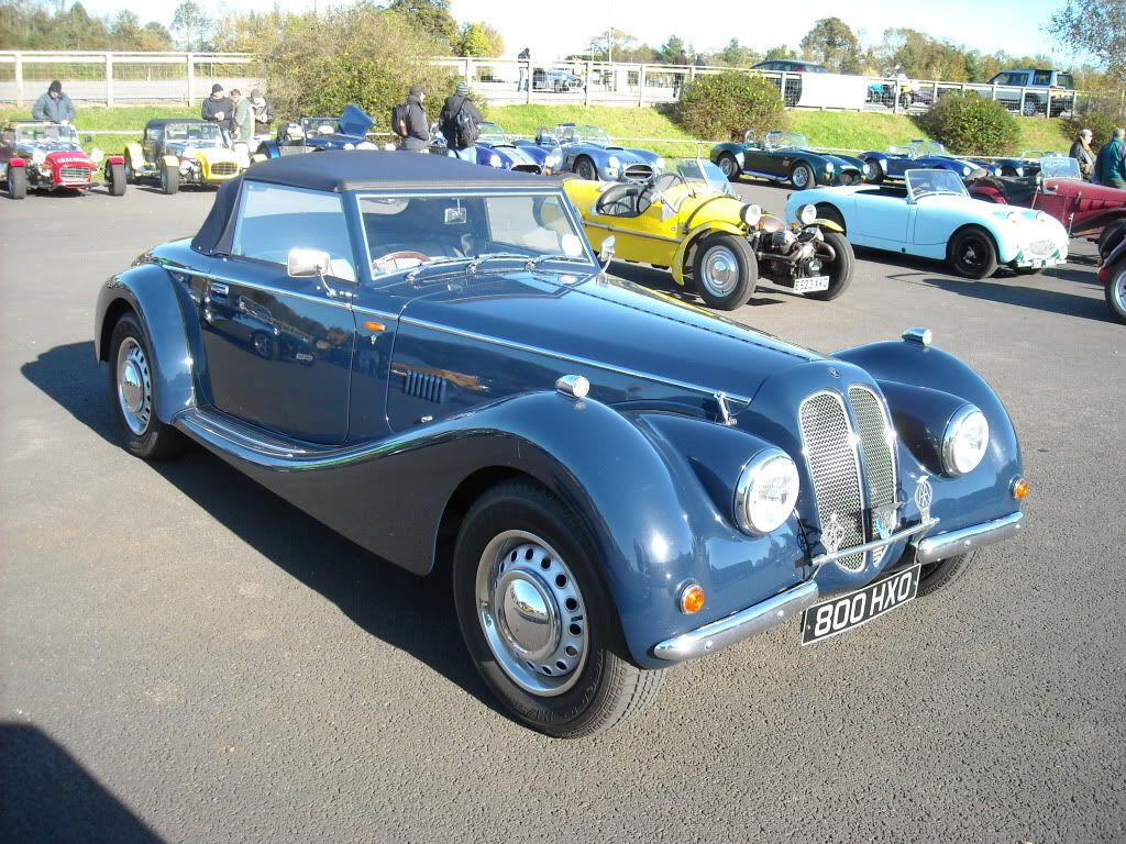

Hi, have been following your thread with inerest and saw this one at the Exeter Show today.

Hi Froggy,
That is indeed a fine example!!
The bright winter sunshine and the reflections show up the quality of the bodywork and paint finish.
thanks for posting the pics
...peter

Its so reserved. One of the few kits that really does not look like a kit. Im loving those steel wheels too, and the triple wipers.
What plans for your wheels Peter?
I'm a long way off choosing my wheels but I do like the look of the steel wheels. Colour coded steels can look very smart and I've already picked up a set of old chrome hub caps of that well known auction site. But SWMBO likes wire wheels, so we'll have to wait and see what budget is left.
The steel wheels on this car are particularly nice. Anyone know what they are? Maybe German 'winter tyre' rims?
