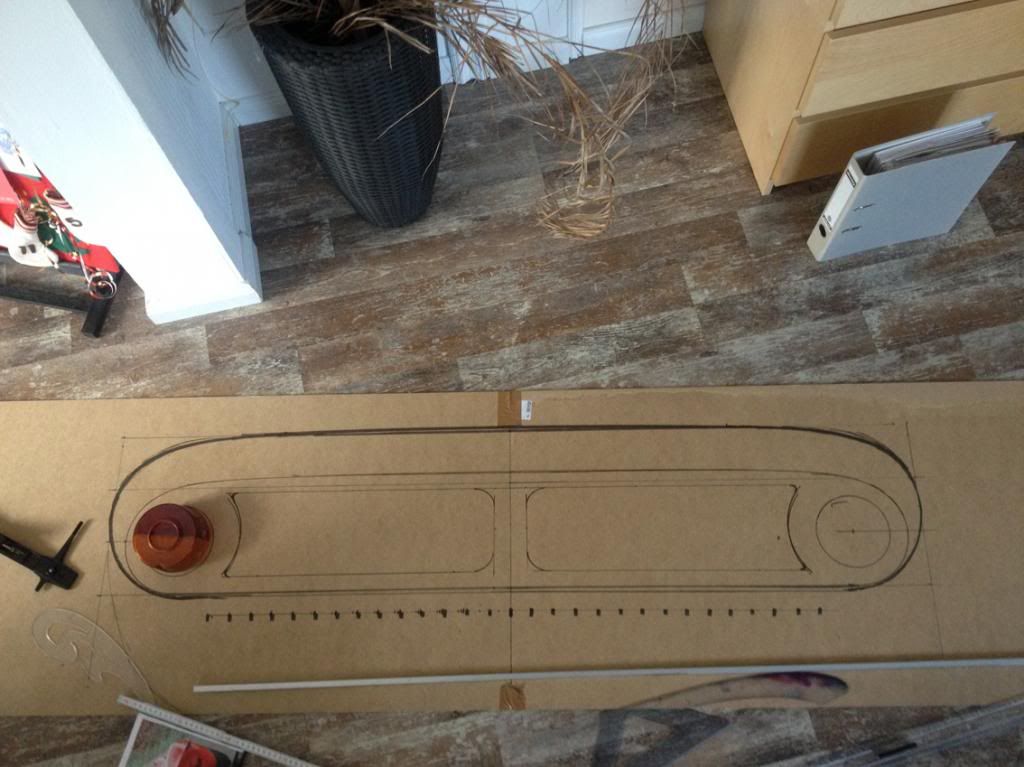

I made a template for the rear end this weekend, and did the mandatory photoshop proof...

trying to find the curves before...

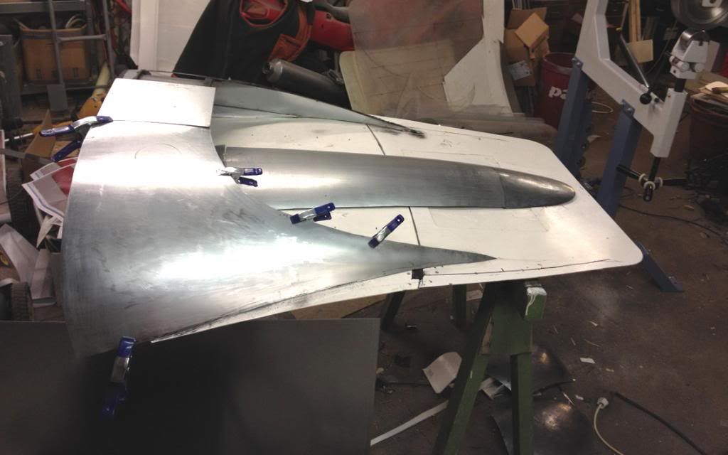

Hi guys,
some updates, my planishing hammer arrived yesterday, and I did some testparts like a cover for the b-pillar inside, and the hoods for the bonnet.
It is amazing, when you start hammeringyou think "ok, this will be in the bin in a minute...", but when you keep hammering and smoothing it really turns out! The hammer is a china-thing, I paid about 120$ for it, but for that price it is really cool!

Little update:
I installed the steering column and steering wheel, helps a lot moving the car in-and-out of the shop.
And I tested my new english wheel with some panels for the bonnet.
Huuuh...it's not like you buy that tool and you can do all kinds of double-curved panels immediately...there is a lot to learn, but it is amazing how easily it domes!
Sometimes it domes so fast, that you soon realize it is already too much curvature, and then there is almost no way back...! I ended up in cutting that panel and made an extra part for it!
