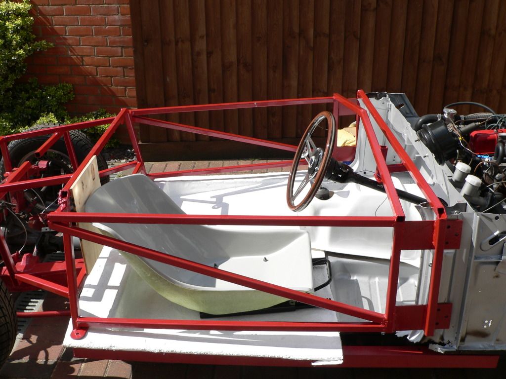

The Miglia frame is simpler than the original S*mmio one , a little too simple in my opinion . Mike was an ok laminator but he isn't a fabricator and , I felt , the frame in the Miglia demonstrated this quite well ..its a bit lacking in strength in my opinion ...but this factor probably means it accommodates seats better .... I would take the opportunity to brace the frame with some triangulation whilst you are building the car ...

Thank you for the advice. Do you mean to add the triangulation at the area below the doors, from back to front?
I am going to add the centre section along the prop shaft, from front to back for sure and strengthen the area for the steering wheel column.
Thank you.

Thank you Mr T. I am planning to use the doors supplied with the body though, so I won't be able to replicate the Spider's frame, but I will have to try to improve my frame at certain places.
We discussed the frame previously in the thread but it was related mainly to the steering wheel column mounting reinforcement.
Not sure where exactly Gary suggests to add the triangulation, as the Formosa's frame is quite different from Miglia's. Only way I could do this is to modify the doors by reducing their height I guess , if that is the area he refers to?

That is coming along very nicely matey! can't wait to see the moon-buggy stage as that is always a huge milestone
In case it's of any help as far as frame strengthening is concerned, i added a reinforced the central tunnel area on my frame made from steel box as i'd originally had flex from my handbrake area on the Sammio until i re-enforced it, so i thought I'd address that straight out of the blocks this tine.
Then rather than adding to the side frames with triangulated steel (as i wanted working doors as well!) i decided to do the rest of the strengthening with the alloy panelling and it's supporting alloy framework.
With my old v.hard front suspension i've very little body flex or creaking so far, so i'm happy with how it turned out.

I was thinking about the frame reinforcement for the last few days and came to the conclusion that if I want to keep the doors, I will not be able to do much in that area.
This only leaves me with a few possibilities, and adding a prop shaft tunnel is definitely the most important one, so I will do that for sure.
I was thinking to reinforce the areas in front and behind the doors on each side, but I would not like the frame to become too heavy - now you have mentioned that the internal paneling adds quite a fair bit to the overall stiffness and the strength, which makes sense, I will first add the middle section and then see if I need to add any further reinforcements in other areas.

More progress, so here are some photos. When I had a trial fitted the seats, I have noticed that I have to raise them quite a bit to be able to see above the screen. I decided to do an experiment and I have bought two 2nd hand adjustable seat bases with the sliders, which can also be height adjusted. They can also be electrically adjusted apparently, but I am not bothered with that to be honest. I just want to make sure that I can pass the M.O.T and to be able to see above the screen.
I have removed two back mounting plates, as they were pointing in (for my purpose) wrong direction and would not allow the seat to fit in the floor pan.
...no way back now...
I have narrowed the seat for 6 cm and just tacked them for now.
They fit very nicely now. There are plenty of possibilities to use my MGB back part of the seat and attach it to this base. I will use the original foam and the vinyl from the MGB seat to cover this new seat base.
I could not trial fit the body this weekend to further check the clearance on top, but I can now move the seats more towards the centre, and if I have to cut into the body to make it all fit, then so be it...
I will post further update on seats when I trial fit the body.

My lowered battery tray has cured now and I have peeled it of the mold. This is now ready to be inserted into the top part of the bulkhead and glassed in when I am ready to do final bonding of the fiberglass bulkhead to the steel frame.
