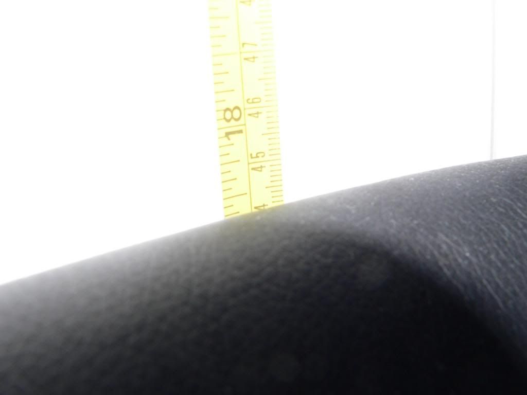

New pictures of my SAMMIO during this WE. The bodyshell is not fixed yet, only put on for an easier stockage.

I v'e got in my SAMMIO CV only 48cm for the hight dimension? Is it possible to order a sat lower than their models ?

I also loved the look of the Intatrim Apollo seats, but the dimensions on their web site would make them too tall for a Sammio fitment without sticking out of the top of the cockpit.
I've used a pair of these from Dax and had them upholstered locally -
http://www.ebay.co.uk/itm/Dax-AC-Cob...item1e69e33947
Dimension 'A', a line drawn from the floor vertically to the highest point of the seat is only 440mm, so you could either bolt them straight onto the floor or use locking runners so they can be adjusted, but still fit within the body tub.

I don't understand the seat's mesures : they say "..."The seat measures 430w x 500d x 500h..."
Could you confirm the mesures with this drawing please ?

Usually W = Width, D = Depth & H = Height.
Therefore A = 500, B = 500 & D = 430.
Note:
Sometimes D = Depth of seat only, which would be "C" in your drawing.
But I would read that as D = Depth overall, which is "B" in your drawing.

I'd recommend a very laid back seat for any Sammio. The cockpit is quite shallow, even with lowered floor pans, so upright seats leave your head and shoulders sticking up into the wind blast, which spoils both the aerodynamics and your coiffure, assuming you have hair. IMHO, the bigger the difference between measurements 'B' and 'C' the better.

I can't place lowered floor pans in a 2cv chassis, so I have to find the most lower seat that I can
You say in one of your message that the highest point of your seat is only 440mm but I read 500mm in the DAX documentation. Do you have another model of DAX seat ?

440mm, it maybe the measurement once tilted?

No those are definitely the ones I've got. A line measured vertically from the floor to the highest point of the seat is 440mm, but if you measure at an angle from the rear of the seat base to the top it's 500mm.
