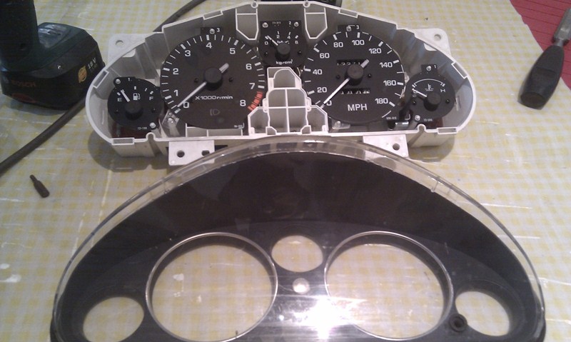

I've been mucking about with a set of MX5 MkI gauges. The speedo is cable driven and it is straightforward to mate it to a Triumph gearbox. By chance, it is calibrated perfectly with 14" wheels for a 0-120mph sweep.
The oil pressure is a simple VDO sender, the tacho is a single wire (MkI MX5s have a single coil pack) and I can calibrate the fuel gauge easily using the Spitfire sender.
I've mocked-up some period gauge faces and I have some thinner needles (I'll post pics after a few more iterations). I am pleased with the potential.
I need to decide whether to make a period front (making the gauges look like conventional individual gauges) and keep the gauges in the same layout, or to unscrew the mechanicals of each gauge and produce a totally new layout. I have glass and chrome bezels that I can use.

I may well bin the lot and go for conventional gauges, but this has been a bit of fun.
