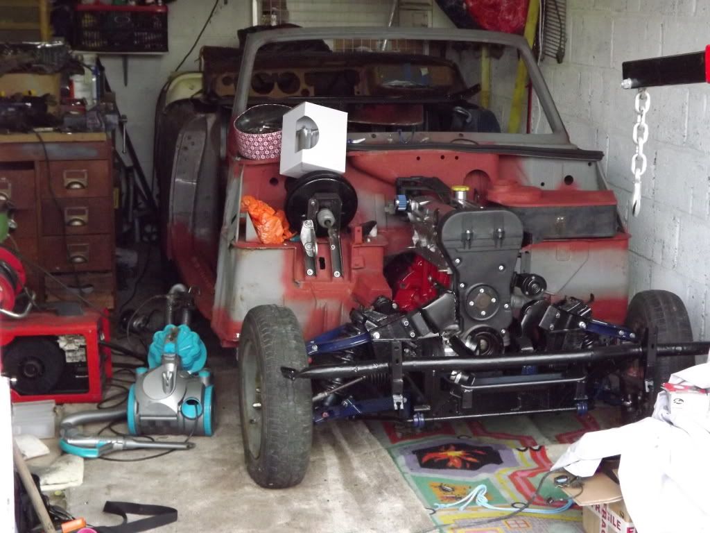

Hi T, its a Zetec S 1700 95,000 miles no leaks etc... would i need to get the wiring loom/ engine mounts???
Hi Gary, I'm no expert in engine swapping, it's just a kernel of an idea that's simmering away in my subconscious for an ultra lightweight Spyder with enough power to be exhilarating without being too scary to drive.
My plan will be to buy a running Puma and transfer the complete loom with all ecu's etc and the motor into the Spyder chassis/shell. I'd guess that engine mounts will need to be fabricated too. I don't know if all that's possible, but RWD motorsport can probably advise -
http://www.rwdmotorsport.com/zetec-s...llhousing.html
I'm sure Viatron can also shed some light on the details as he fits his 400hp 4 pot Ford into his Cordite.
I'll be following both threads with real interest.

Transferring the engine with loom can be done but is a tricky job as the anti theft system needs either disabling or also transferring. By sticking with the standard ECU and wiring you'll also limit yourself to any tuning improvements, just my opinion but if it was me I would investigate after market induction, possibly a bike carb setup? And a cheap ecu like the Nodiz I'm running my triumph on. Also don't underestimate how difficult engine mounting can be. One reason we ditched the Volvo T4 in the GTA was that it was very lacking in threaded bosses on the one side of the block which left very little to attach mounts to. Could be a little flyer though with that engine in and set up right. Good luck!

Made some floor pans, just need to weld the corners and plug weld. After looking at some threads I need to take out some more leaves and bought a lowering block. Heres some pics of what i did.
