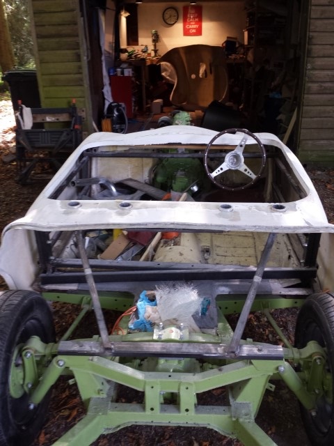

Well, a productive 48 hours......Part I

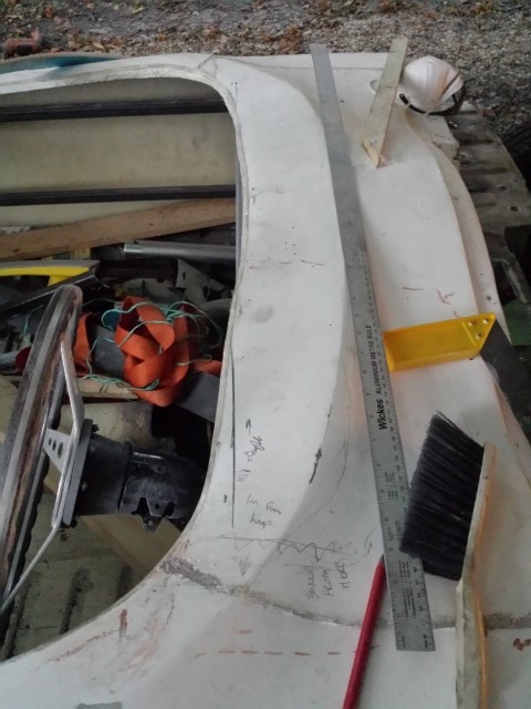

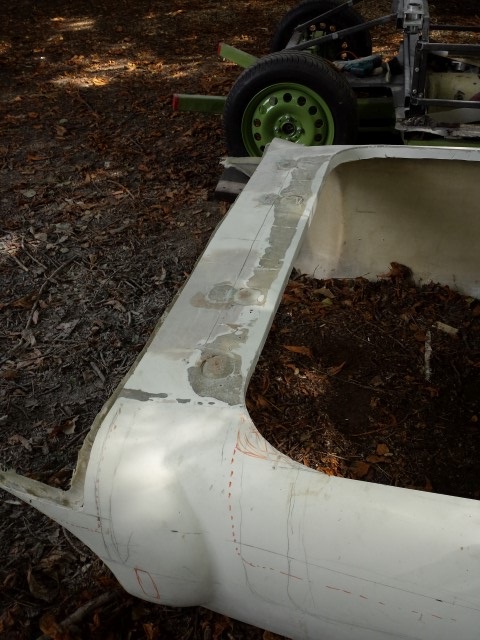

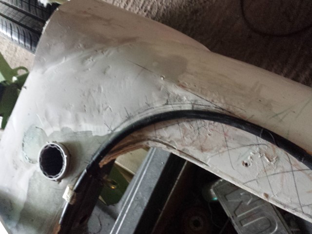

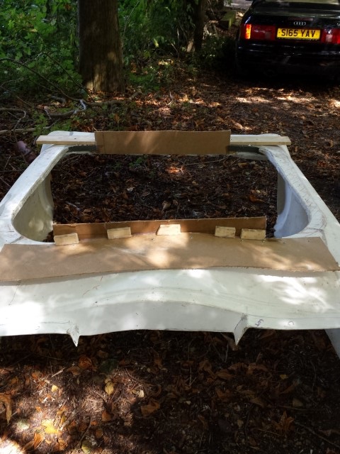

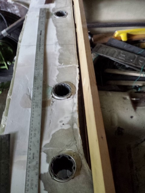

It is well known that Sammio cockpits are not the place for a tape measure or a straight edge.......
Front.....
Rear......
The crossmeber for the roll hoops makes for a good datum point so I marked a cockpit opening that is within 5mm of being true front-to-back and side-to-side.

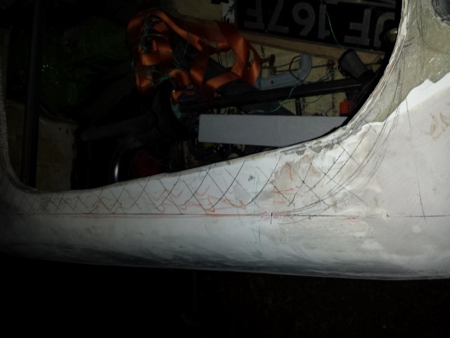

and used a bit of hose to get the corner radii looking right (150mm for front and 180mm for rear).
I then drilled holes from above along the outline so that I could see the lines from the inside of the shell.,,,,and cut off the unwanted return.......

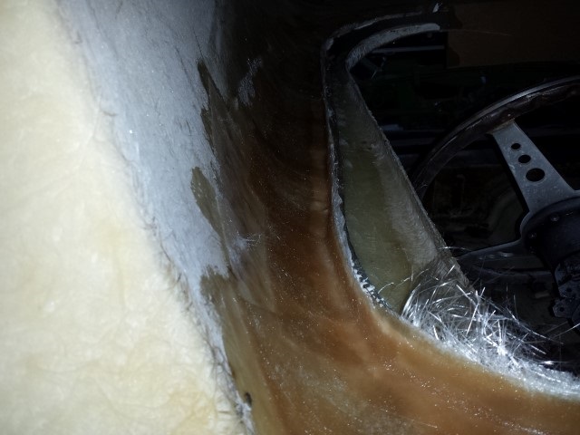

and put some formers in place.

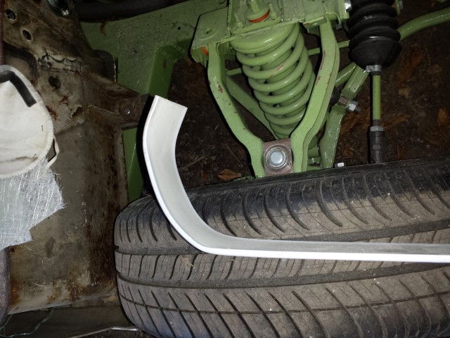

I'd planned to use some uPVC strips to provide a former inside but I couldn't get a constant radius with a heat-gun or steam.
So I used 25mm high closed-cell foam. It is 10mm wide so you can get a good contact with the hot glue gun. I parcel-taped the foam before glueing, and then hit it with some gelcoat.

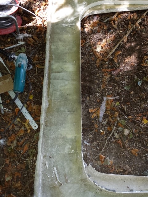

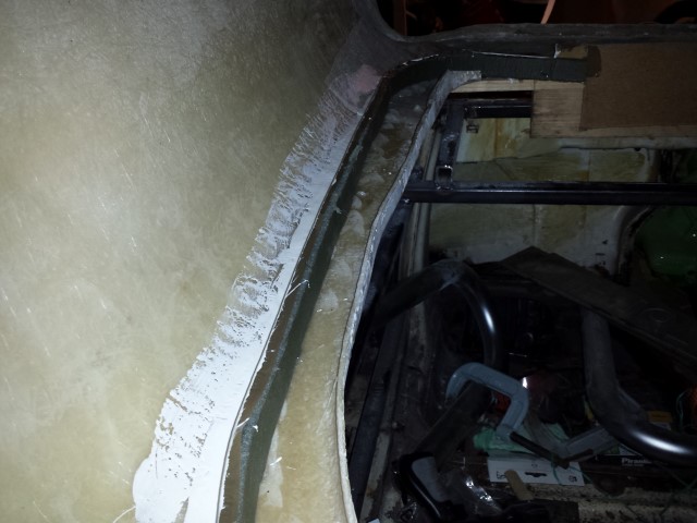

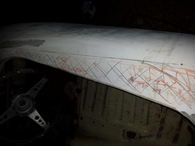

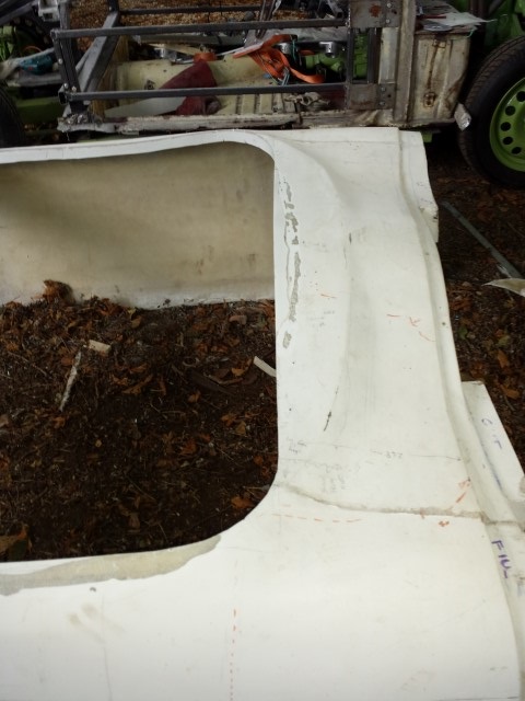

...........after some lunch I went back and laid-up a a couple of layers of 400gsm mat.
This took a couple of hours but the pictures are a bit boring.

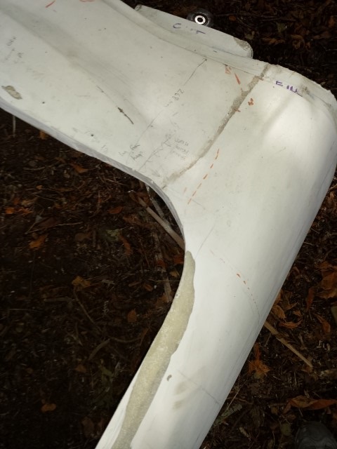

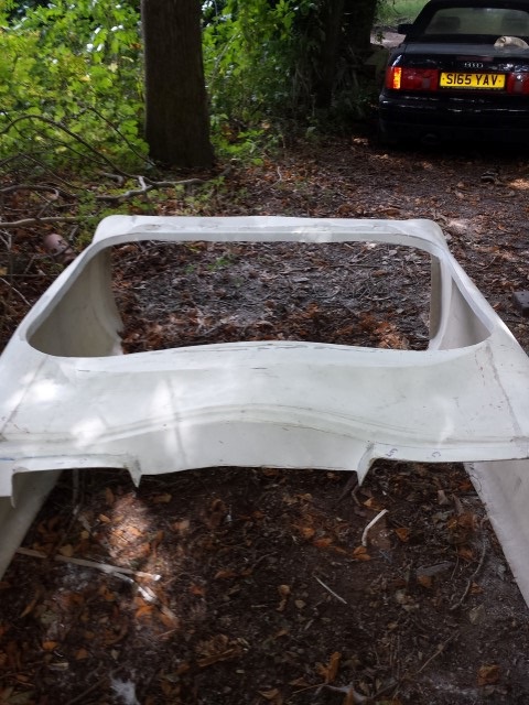

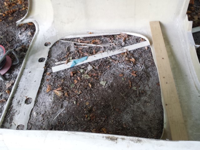

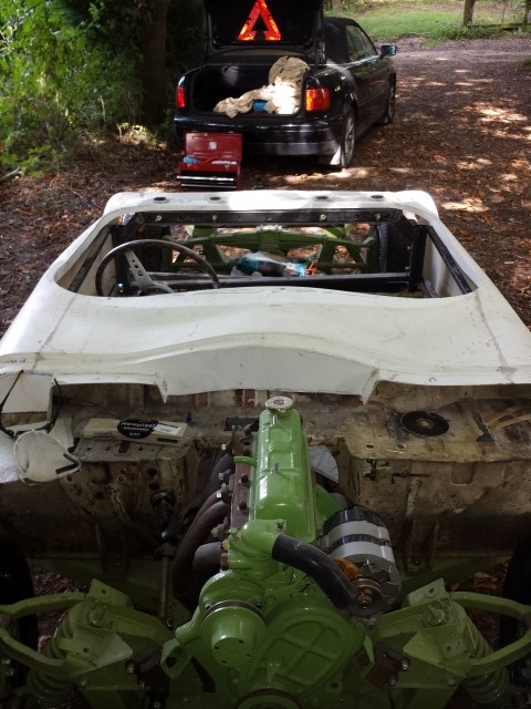

This afternoon I returned to start peeling off the wood and the foam and I was really pleased......this is the back.
The side before the original edge is removed.

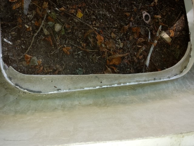

I trimmed all four edges back to the new lip.
There is now plenty of shoulder room in the driving position which makes life much more comfortable, and there is good space between the steering wheel and the edge. The edges are now in the same plane as the side bars in the frame (and at the front and back).
All in all, a result.

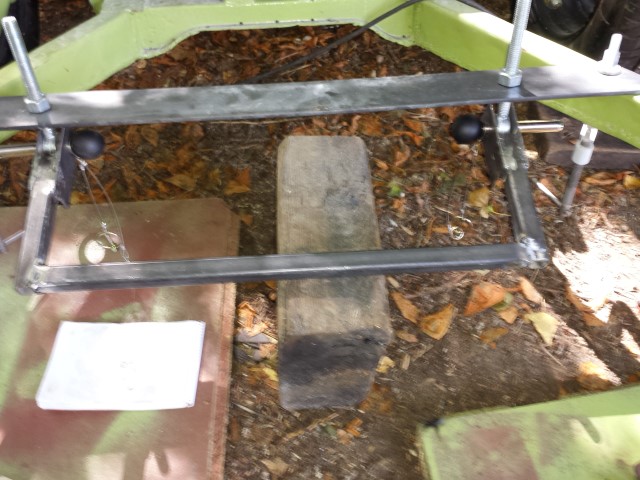

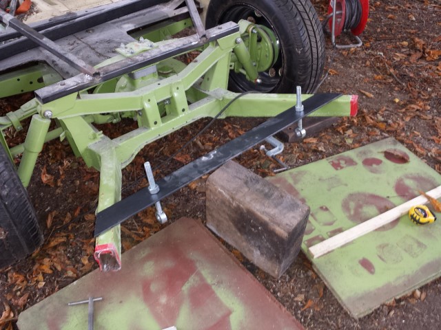

Why does life get in the way of car building? Not as much time as I would have liked this week but I managed to sneak a few hours this morning.
The nice thing about this type of build is being able to swap between mechanicals, fibreglassing and metalworking. This morning I fancied metal, so I started on the hinge and frame for the rear end.
A length of 6mm strap across the back. This will be strengthened with a spine later.
I'm using some gate hinges which will allow vertical adjustment......and the race cars of the 50s were a mix of "high tech" and agriculture. I will cut these to a more sensible length when I know how much adjustment I need.

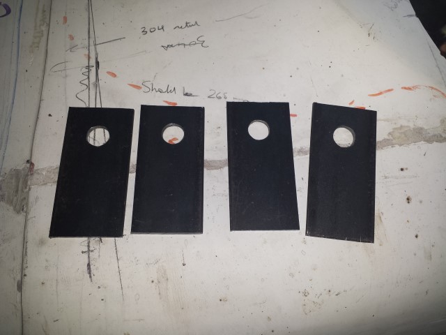

A bit of cutting and drilling to produce four brackets.
A little bit of welding and stage one is complete. It is square and true, even if the picture suggests otherwise.
The frame to support the deck should be easy (famous last words).
The hinge point will be very close to the under-edge of the rear deck which should mean that it doesn't foul on anything. The removable pins are ex-MOD and look the part. I will add spacers for lateral adjustment.
