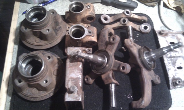

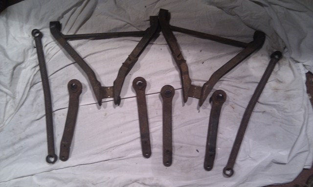

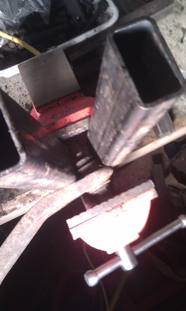

More boring photos for you guys, but morale boosting ones for me. As the weather is not playing ball, I stripped the swing spring in readiness for cleaning and a coat of something, and I have de-bushed the suspension. A full polybush set will be going in once the components have been blasted and painted.
Special tool no. B0110CKS made from a 4" vice, two box sections and a bit of steel tube.
Thoroughly de-bushed.
Items ready for blasting and painting.
I told you that they were boring. It's your fault for reading on.
Despite the element of tedium attached to these specific tasks, I am loving every minute of the project.

Nothing boring about build photos and your "special tool" photo might help others.

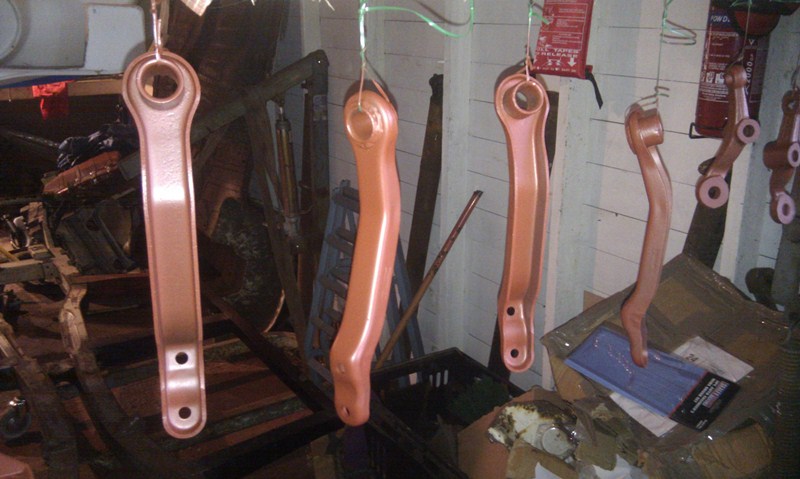

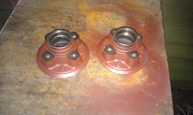

Thanks for asking Mr T. I was just transferring pics from my phone when I read your post.
The last few weeks have been a bit frustrating - weather and jobs that need doing around the house. However, I've managed some blasting, electro cleaning (efficient and highly recommended), and wire brushing. I've also bought a few more parts to add to the stock cupboard.
Today I sorted out my compressor, piping the air in the workshop, and my spray guns.
The pics below cheer me up no end as I have some primed parts.
I'm using Rustoleum and it goes on a treat.
The good thing is that all the bearings and bushes to be used are new, so once everything has been primed and top-coated, it should be a case of big boy's meccano to get it back to a rolling chassis. I like that idea.

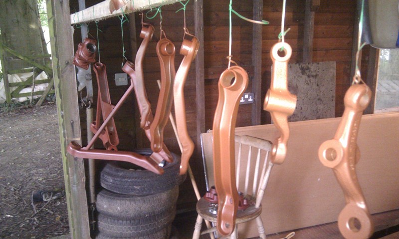

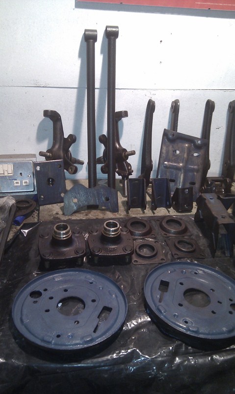

Just to prove that I am doing something other than watching Team GB racking up the medals, here's a pic from this morning. Remaining suspension items blasted and treated prior to priming.
I should have the chassis finished and primed by next weekend. Blasting with a DIY 20 gallon pressurized blaster is like colouring in the chassis with a marker pen. It's great for components, but chassis and bulkhead are taking the p*ss.

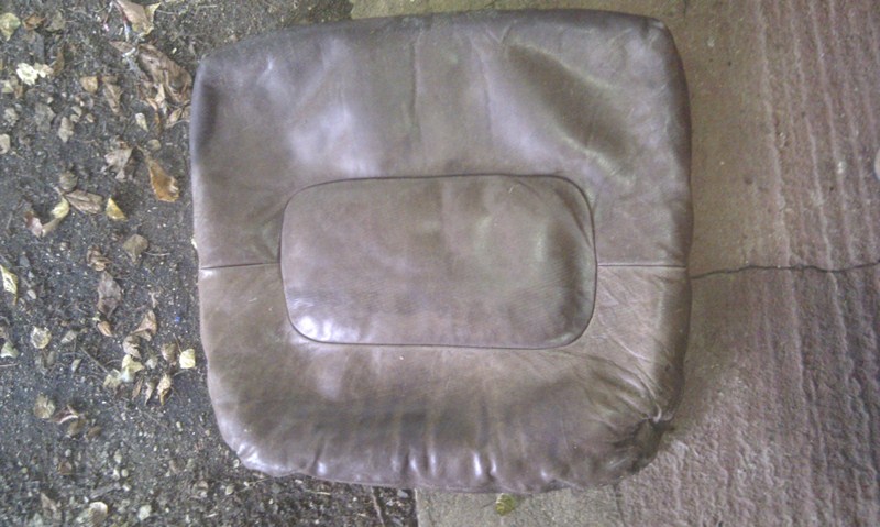

How do you get your seats to look about 50 years old?
Well, I spent the morning skinning an old sofa and chairs. I now have about 8 metres of tan leather that I (or an upholsterer) might be able to apply to some bomber seats and a head rest.
An example of it can be seen here. This will clean-up to a lighter tan. The backs of the sofa and chairs are too good - they don't look old enough even if they have been in use for half a century.
Next pictures should be of a primed chassis! Colour will go on after my holiday.
