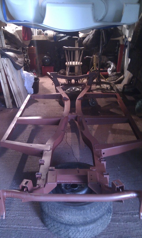

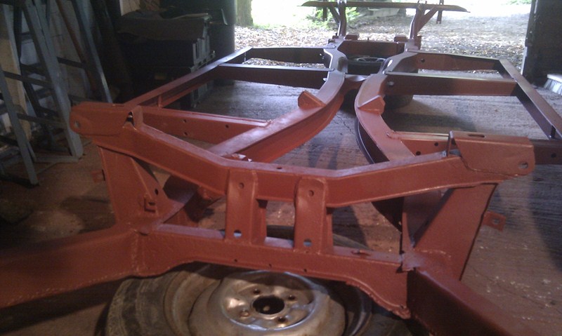

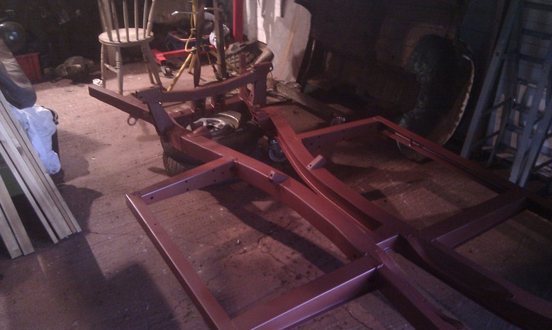

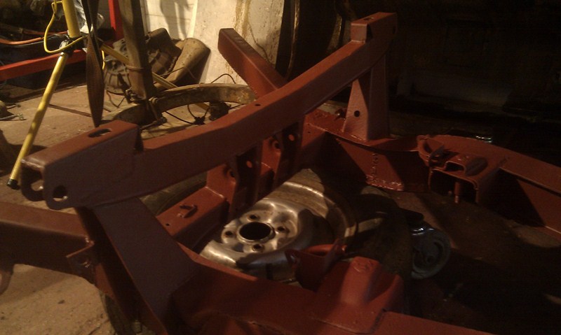

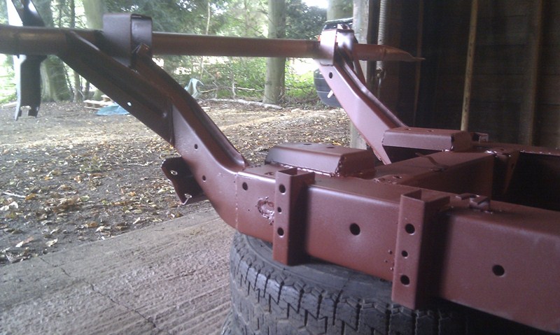

After the best part of a year of faffing, the chassis is clean, repaired and primed. Here she is in all her naked glory.
Time for a holiday and then the chassis and all suspension parts can have a top coat. Then real construction can commence.

Snap, i'm off to the Cotswolds then i might be able to get to this point... Well done, looking new and straight.
  #63
Old 17th August 2012, 10:38
Looks really good, now the fun parts can start in anger

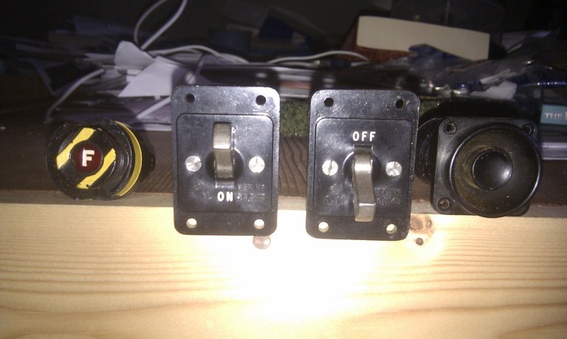

Currently getting all rolling chassis parts ready for a first colour coat. I need to get this done before the temperature drops too much.
I put a big order into Canley this week for bolts (I'm going "all new" as the Sammio obession becomes increasingly out of control), spacer block and spring compressor. Whilst the Rimmer site is easier to use, taking the time to go with Canley saved me £100.
If the colour goes on in time, I can spend the coldest winter months building the rolling chassis.
I've also sourced the switches for my minimal dash - lots of bakelite.
The starter and 20 amp switches (ignition and main lights) are from Spitfire/Lancaster etc.. The Cockpit Fire button (to be used for hazard warning) is from a Canberra. I don't plan to have any other switches/buttons on show and there will be no key.
They all have the lovely Air Ministry and crown markings.
The gauges will be customised to look like they have come from a Sea Fury control panel. That's why we have long winter nights........

Wow, now that really is Sammiobsessive and I love the bakelite switches. I'm looking forward to seeing some pics of your aircraft inspired dash...

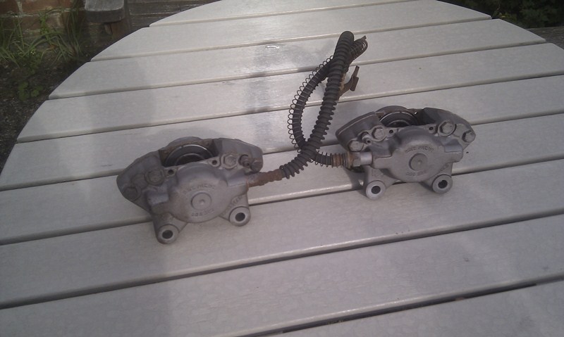

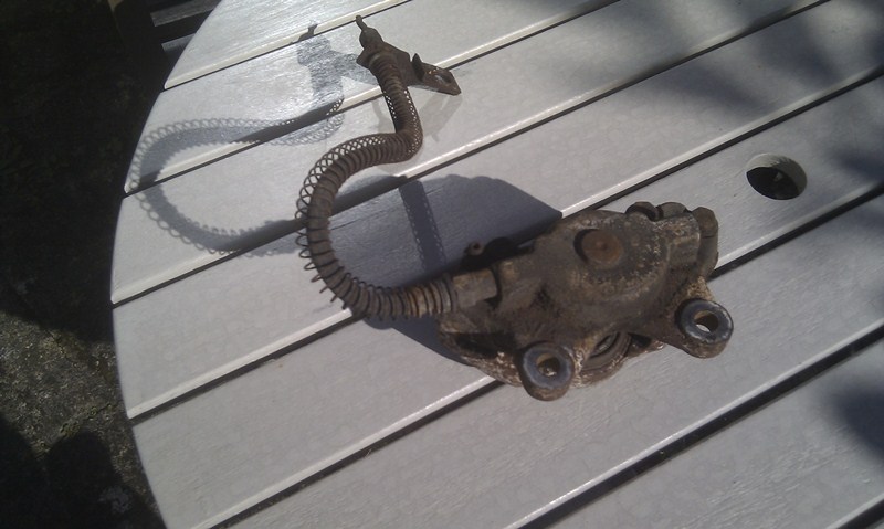

Spare time is proving elusive at the moment so I am trying to keep momentum and spirits up by doing small tasks that mean that things will be ready when production begins.
Yesterday I fired up the Bunny Blaster Cabinet and cleaned up a few more items.
Before
10 minutes after
I left the old pipes in place to protect the internals and to give me something to hang on to as I blasted.
Tonight I shall strip them bare and give them a coat of BS318c-217 caliper paint. Tomorrow I shall fit new pistons, seals and nipples.
Apologies for slightly boring post, but it is designed to convince me that I am making continual progress, no matter how slow.
Mind you, I've managed to work-in the words "strip them bare", "nipples" and "give me something to hang on to" in a single post. As I said before, I know this car better than I knew some previous girlfriends.

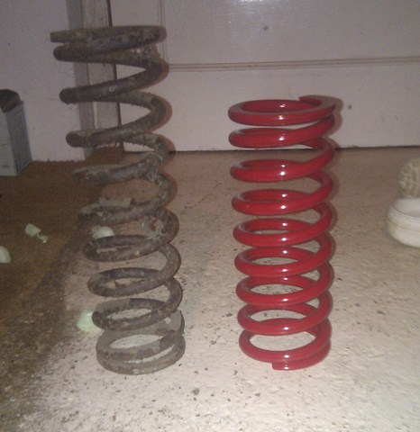

I needed to remove the top spring plates from the original springs/dampers so that I can give them a clean and prime tomorrow.
I was pleased to see that the new springs are shorter than the originals. However, that colour will have to go. Shame, because it's a lovely finish.

They look great! What's wrong with the finish? I'd be well chuffed with those springs.
