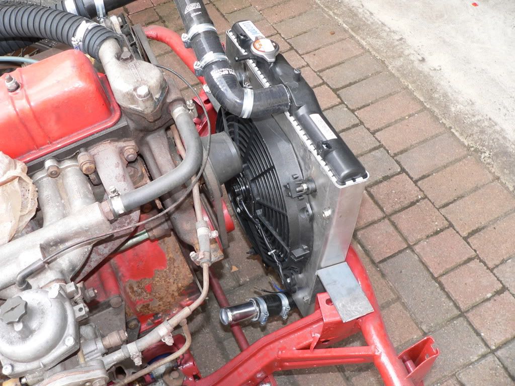

I have a feeling my fan was 14" but I'll measure it in the morning. I made a shroud for it out of sheet steel as that's what I had laying about in the garage -

The one pictured is a standard Honda Civic radiator as fitted to all petrol models from the 1.4 to the V-Tech. I punched a hole in it with the steel bar I was shaping into the nose hoop, so I replaced it with a double width aluminium version imported from China via ebay, which fitted the shroud I'd fabricated.
Despite this I've had a bit of an issue with cooling at high speed. That could be down to my scoops creating pressure behind the radiator and stopping the airflow through it, or it's been suggested that aluminium isn't as thermally efficient as copper. To improve high speed cooling I've fitted a rear mounted MR2 radiator in series with the Honda one and added a BMW auxiliary electric pump to help circulate the coolant. I'll finish plumbing all that in today if I get the motor fully rebuilt.
If I was building another I'd be using an uprated, copper cored Ford Escort RS2000 radiator as recommended by Phil J -
http://www.ebay.co.uk/itm/FORD-ESCOR...item3a8b292ed5
Not cheap but he swears by them and has no cooling issues at all. He's also kept the engine driven fan btw, which works fine but will obviously sap a bit of power at higher revs.

If you've only got problems at speed, that sounds like airflow to me?
I did notice that your radiator shroud doesn't have any bypass flaps fitted?
So when running slowly you're pulling all the air through with the fan fine and you know that is working fine, but when running at speed it's the air/wind rather than the fan that is doing the cooling and in that case your cowl is actually blocking quite a bit of your rad.
I'd say one thing worth trying would be to add by-pass flaps such as these:
Just an idea
My monstrous 60mm deep Civic rad turned up yesterday, so atm I'm hopeful that it'll do the job when on the move.
And then based on knowledge gained from the Lambo experiences I just want to make sure that I've got a powerful enough fan to move the air at slower speeds.
I've got a 10" Kenlowe laying around that is rated at just shy of 800 CFM which 'may' do the job? Hence my question to see what others have used.
But jumping to 12" gives nearly 1300CFM, so a huge difference as i found on the Big Red Car!
