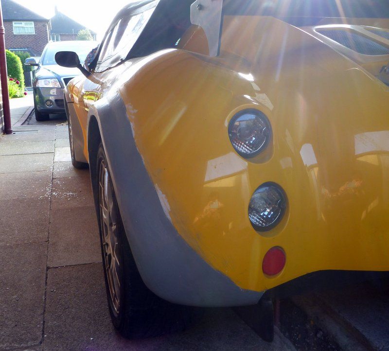

I went down the route of extending the arches with a polyurethane foam core/GRP DIY job. It was a lot of work but I was pleased with the general result. Of course that was in 2007, and I still haven't got around to finishing them and making the body all the same colour... Latest thinking is to go for an all over vinyl wrap. Watch this space. In the meantime, here are a few photos of the arches in case you're feeling you've got too much time on your hands!

Nice job and I can see why it took so long. My retest is only in 8 weeks so I don't think I'd get that sort of result in the time. (Retest is just for the bits that the car failed on. Tester let me book it there and then, and told me to pay on the day, in case there was a problem in the mean time).
I did a trial fit of my Foamex 'extensions' today. I think I'm there - just a bit of trimming on the bandsaw at work, clean up the edges and fit them back on. Only snag was the lip under each wheel arch was very narrow. I'll post some pics when they're done.
Should I look at fitting wider wheels I may follow your route, but it would have to be a winter project!
