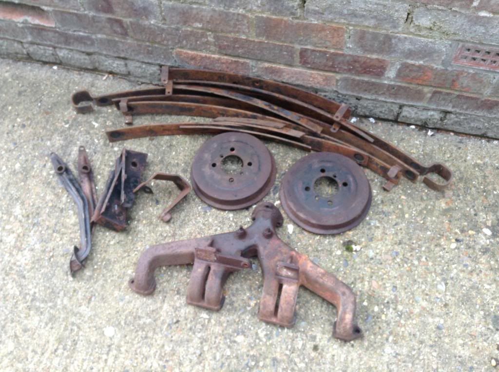

Old 9th April 2014, 13:22
Finished painting... the wife daren't say a word!
Question. I'm putting the diff back together, do i use Blue hylomar where the output shaft seal plate attaches to diff casing?
Pics of the last rusty parts left on car and taking bearings off of the rear hubs. Also, 3mm steel for floorpans, held down using existing holes for bodywork?

Old 14th April 2014, 09:02
More parts painted, bearings, nuts and bolts ordered. Also bought a very nice fog light and bonnet pull. More work to do over the bank holiday. I need some sheet steel for floorpans and bulkhead.
