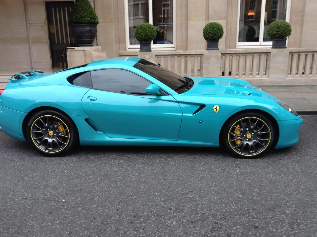

Old 13th August 2014, 08:36
How about this colour, it certainly stood out.
  #486
Old 13th August 2014, 10:42
Personally I've always liked that colour and "back in the day" it was the colour i painted my first ever _proper_ radio controlled car!
Looks even nicer full-scale
