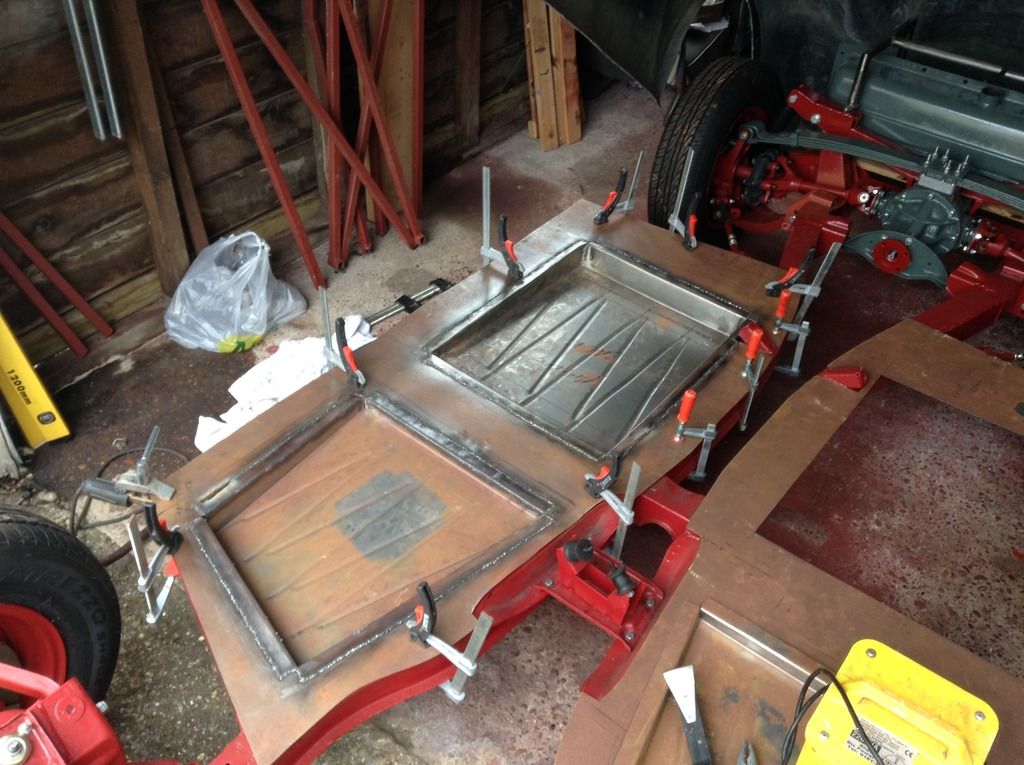

Welded in the floorpans now... just don't tell 8valve or Rene. I've done my best, and it is on 1mm thick.

reneanglia reneanglia is offline
Join Date: Jan 2015
Posts: 168
reneanglia is on a distinguished road
Good enough,they would'nt fall out..........
If your ass is getting hot while driving check the welds.........
  #579
Old 7th April 2015, 16:06
Thanks Rene, short bursts... but takes a long time.
